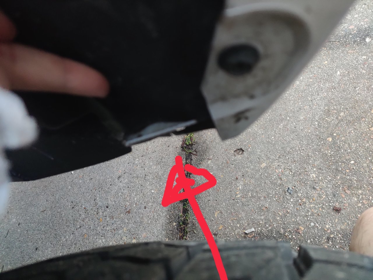

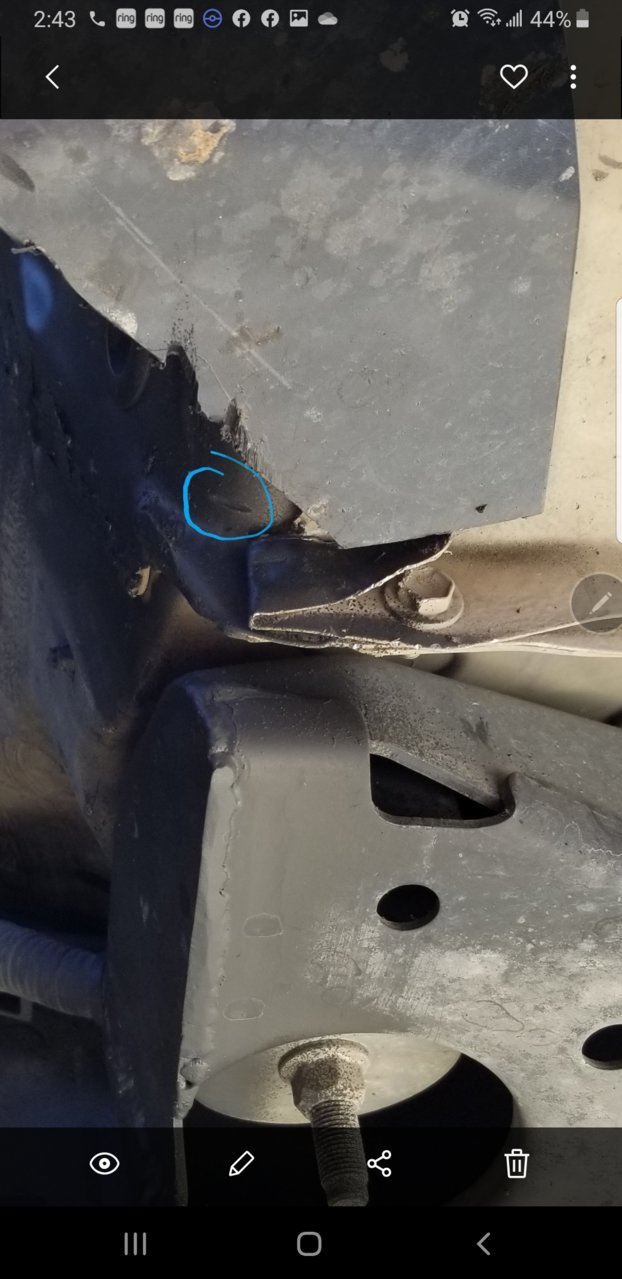

    Plastic on the fender flare, sheet metal fender behind/underneath it.
    Use some caution when you get closer to the inside area. Don't have the cutting wheel in as deep. Kinda hard to see in the pics here, but hopefully you get the idea. As you get closer to the cab, the little bulge there can get nicked if you're too deep. You can see in my 2nd pic where I sorta nicked mine. On the passenger side the cutting wheel got away from me for a moment and I actually went into the cab. Sealed it up with some silicone.
    You're essentially cutting a "V".

    I would error on the side of caution myself. I only used my angle grinder when I had to. Everything else was easy to cut with a razor blade. After trimming the bumper I also used a 210 grit sandpaper pad on the grinder to make the cuts smoother and give it a better contour.

    Yea, I had to cut / shave that corner as well. That was the culprit of most of the rubbing with my setup.

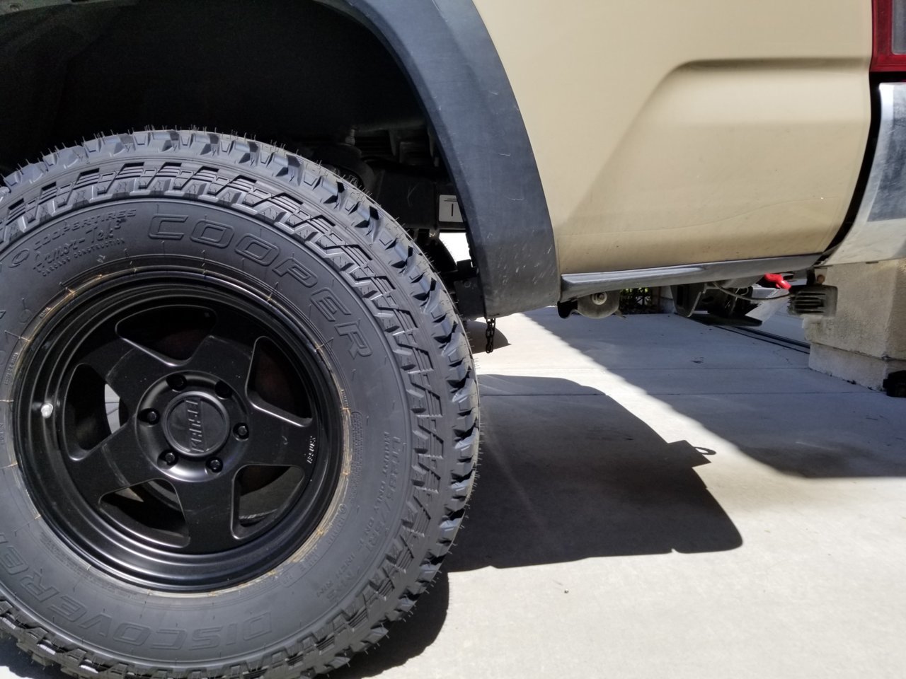

    I know I mentioned the wheel/tire setup in my post with the pics post-install, but I don't think I mentioned the suspension setup.
    Fox 2.5 Res up front, set at ~3". With Supreme UCA's. No sway bar. What I would consider to be a moderately aggressive cmc, no fender liners, trimmed rearward edge of the fender, and a cut front bumper.
    Fox 2.5 Res in the rear, Dakars w/ the extra leaf.
    So far with daily driving I have not had any issues with contact of any kind. Not at lock, not in reverse, not in a plane, not on a train (Long Live Seuss).
    That little trail I mentioned in the other post, Sugar Pine, is not at all a place that lets you flex, but in the few spots that at lease cycle the suspension slightly. Anyway, no contact anywhere there as well.
    I intend to go back up to Coldwater and Cleghorn probably this coming weekend, and see that happens when they really get stuffed.
    One concern I do have is in the rear actually. It looks to me like where the tire currently sits, it may contact the rear portion of the wheel well on up travel. From my observation, the rear suspension cycles in an arc that carries the tire up and back. I've looked through other member's pics, and I can't really tell whether or not others share the same axle/tire placement. If I have contact, I'll wait to see what happens when I swap these Dakars out for the Deavers (maybe ome's center pin location is a little different). If that doesn't change it and I've still got contact, I'll grab a relocation plate and move the axle forward.
