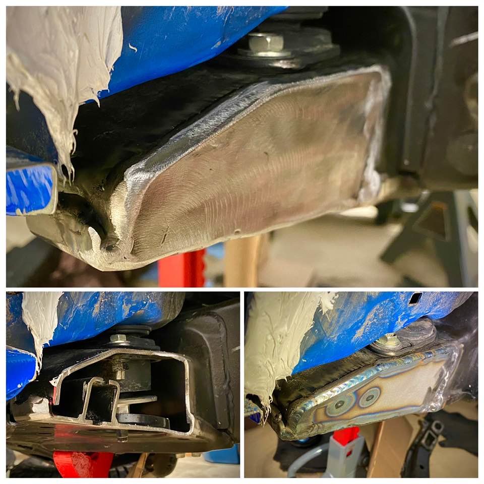

    maxing out the front and rear is why you have issues.
    I noticed that too when i tried to do that.
    fronts eccentrics are set about 3 lines inboards of "center", rear eccentrics are maxed outboards.
    this allows for pushing the tires as far forwards as possible while not narrowing the track width, which would cause you to bring the UBJ too far inboards, which cause the tire to UCA rub issue.
    narrower track also gets your tire closer to the frame too.
    I have the SPCs set in the "E" setting, with the slot measurements of the adjustment gap on the outboards end being LH/RH of .571" /.308"
    drives and tracks beautifully.

    I follow you and appreciate you sharing your settings with me (the world). I will have to start the experimenting with mine again. Very glad to know it is possible since we sound to have the exact set up, and I so hated to put these spacers on... I have to assume you have a decently aggressive cab mount chop and trimming of plastics/liner/etc.?

    cab mount chopped and pinch flattened, inner fender was heat gunned and pressed, had to trim the bottom of the fender and flare near the body mount but havent needed to anywhere else.
    as of right now i only have street miles, no offroading yet while I break in the new gears, but I cycled the suspension at all steering angles without the shock and cleared so i have high hopes of no rub offroad too

    Thanks man. You cut looks maybe a bit less aggressive than mine. So, that give me more hope to be able to dial mine it without spacers. Can you explain to me more specifically where the measurements you made are? Is this as in where your camber is sitting?
