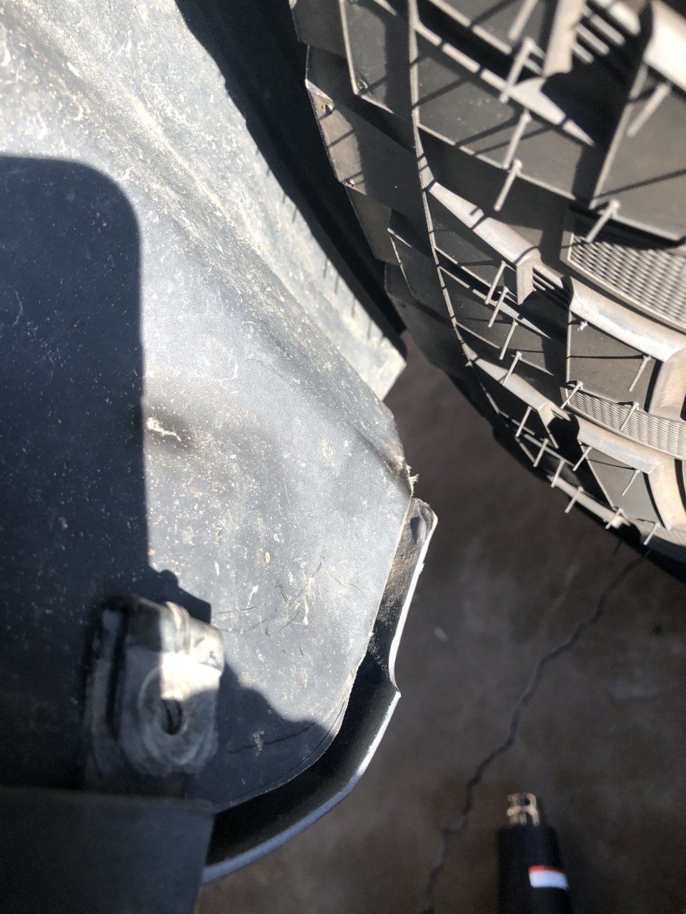

    I started with CMC and hammering over the pinch weld. I still had some rub on plastics only on the front of the wheel well when at full lock on incline. It was just on the drivers side. First I removed the (10mm? Or 12?) bolt closest to the tire that holds the fender liner to the bumper, moved the little metal clip out of the way, then I cut a small (1/4-1/2”) bit of plastic off the bottom of the bumper.. I left the hole for the bolt in for now. I also used a heat gun to massage the fender liner itself forward a bit as it looked “rubbed” in a small area as well. I did take a few pics but they aren’t the best. Here you can see the cut, if you can even call it that, and that ridge in the liner where it was touching.
    This cleared up the full lock/incline on driver side but after this trimming I went off-road for the first time since the new size/wheels and I got a smidge of rub on the passenger side so I’ll likely do the same trim over there next time I’m off work and have daylight.
