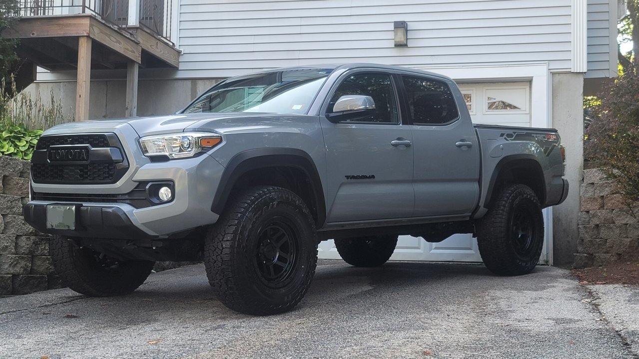

    285/75R17s aka 34x10.5 17 are perfect in person on the DCSB. Mounted on 17x9-12 KMC 540s.
    You absolutely need to do the CMC, pinchweld bend and liner cut, however even at full lock on a 2"F 1"R lift they won't hit the fender bodylines from my testing.
    Needs a regear badly. Have to decide between 4.88 or 5.29. Upgraded brakes too. The rotational inertia keeps me from locking up, which means my brakes are underpowered for the wheel weight.
