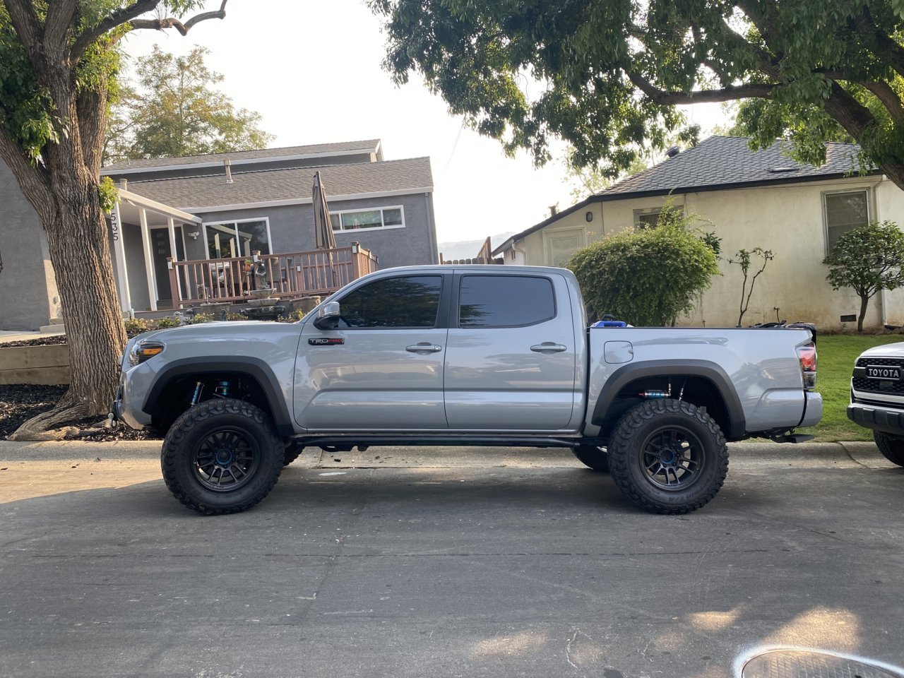

    [​IMG][​IMG]

    All I need to know is that it takes beating on ones truck with a large mallet (pinch welds) in order to make these tires fit. Can you imagine all of the corrosion from this within the rust belt?

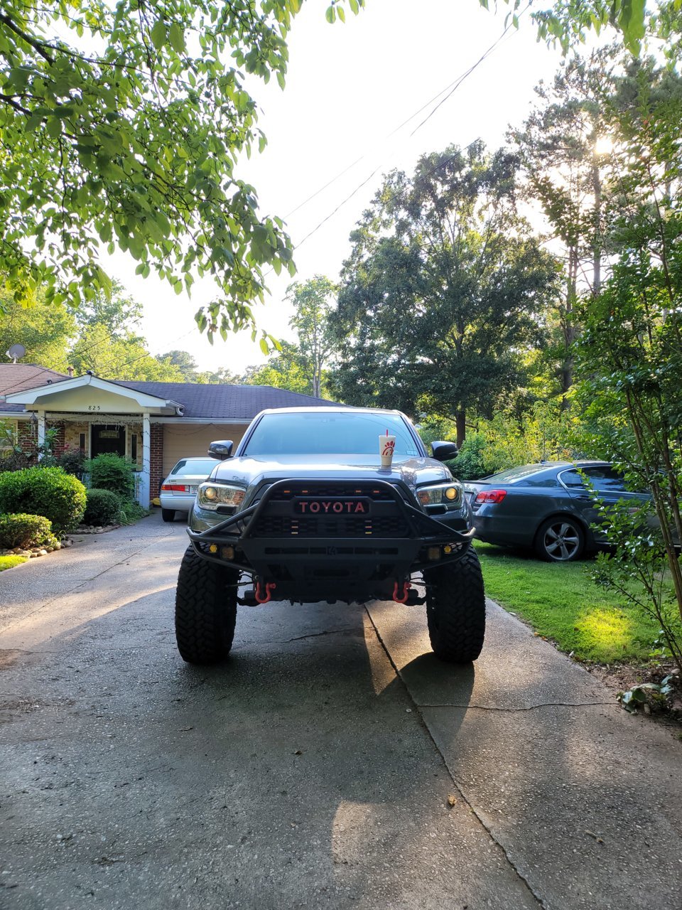

  15. Oct 7, 2021 at 10:10 AM
    #915
    rlx02
    rlx02 ¯\_(ツ)_/¯
    Sep 3, 2016
    #196329
    6,137
    Western WA
    2017 Inferno DCSB TRD OR 4x4
    dude is your camber like that normally or is it the photo making it look like that?
  16. Oct 7, 2021 at 11:34 AM
    #916
    HashTaco
    HashTaco Well-Known Member
    Feb 24, 2020
    #320207
    631
    Atlanta
    2017 Tacoma TRD 4x2
    Not sure why it's cambered like that, but it's like that IRL not just the pic
  17. Oct 7, 2021 at 12:10 PM
    #917
    rlx02
    rlx02 ¯\_(ツ)_/¯
    Sep 3, 2016
    #196329
    6,137
    Western WA
    That's funny. When I first lifted my truck, I had noticeable positive camber, not negative camber. I bought SPC UCAs and was able to set them at 0 degrees. You might wanna look into it or your inner portion of your tires is going to wear real quick.
    Junkhead and HashTaco[QUOTED] like this.

  20. Oct 7, 2021 at 12:26 PM
    #920
    rlx02
    rlx02 ¯\_(ツ)_/¯
    Sep 3, 2016
    #196329
    6,137
    Western WA
    Not sure if most shops will touch the camber adjustment on SPCs. We just loosened the bolt, pushed the tire until it looked right and fine tuned it with just an angle finder mounted some steel bar. Tightened it all back up and I was able to get within ~.1 or so. My tires (sadly just 285/70/17s for now) have worn beautifully over the last 25k miles or so.
