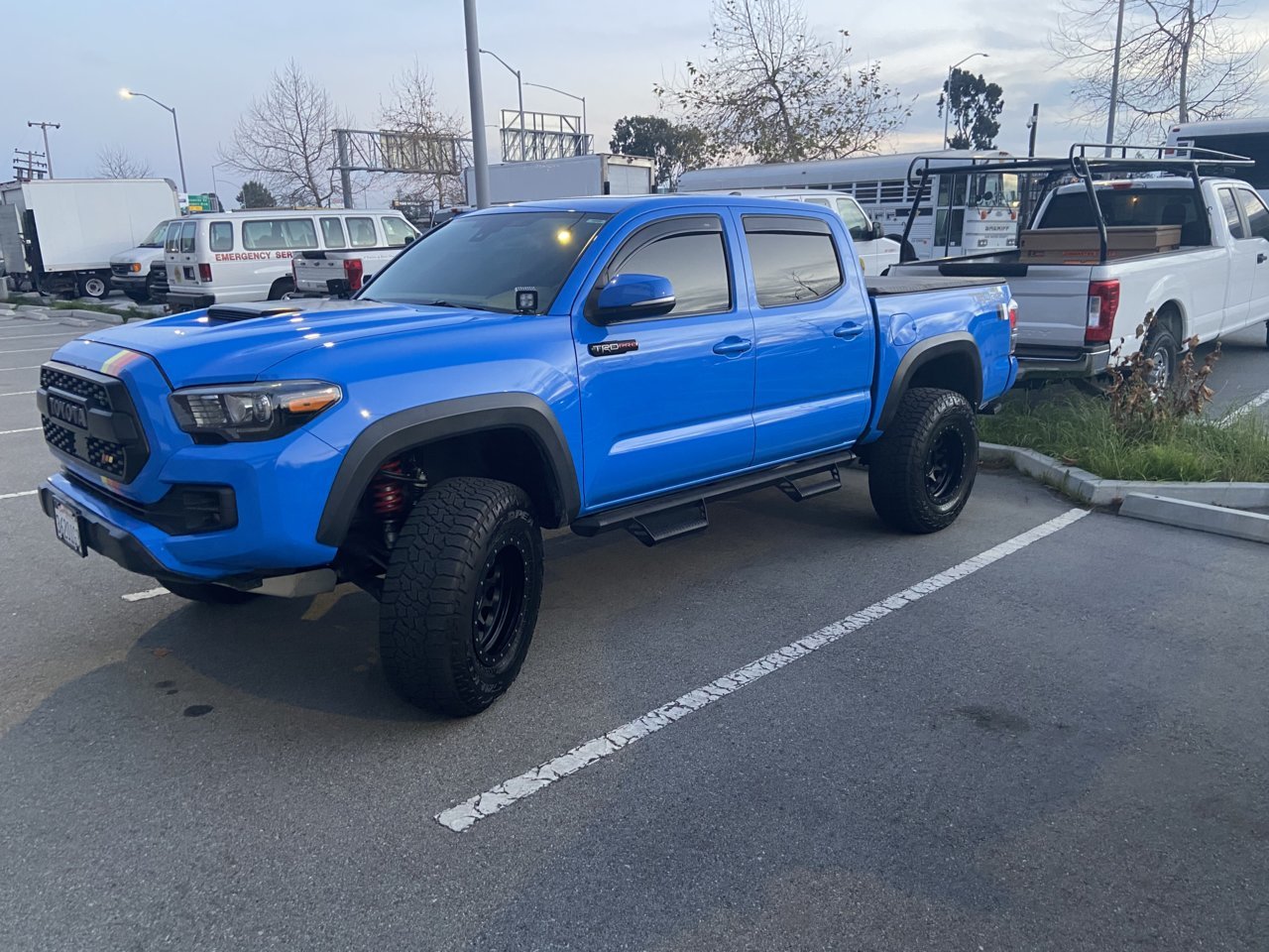

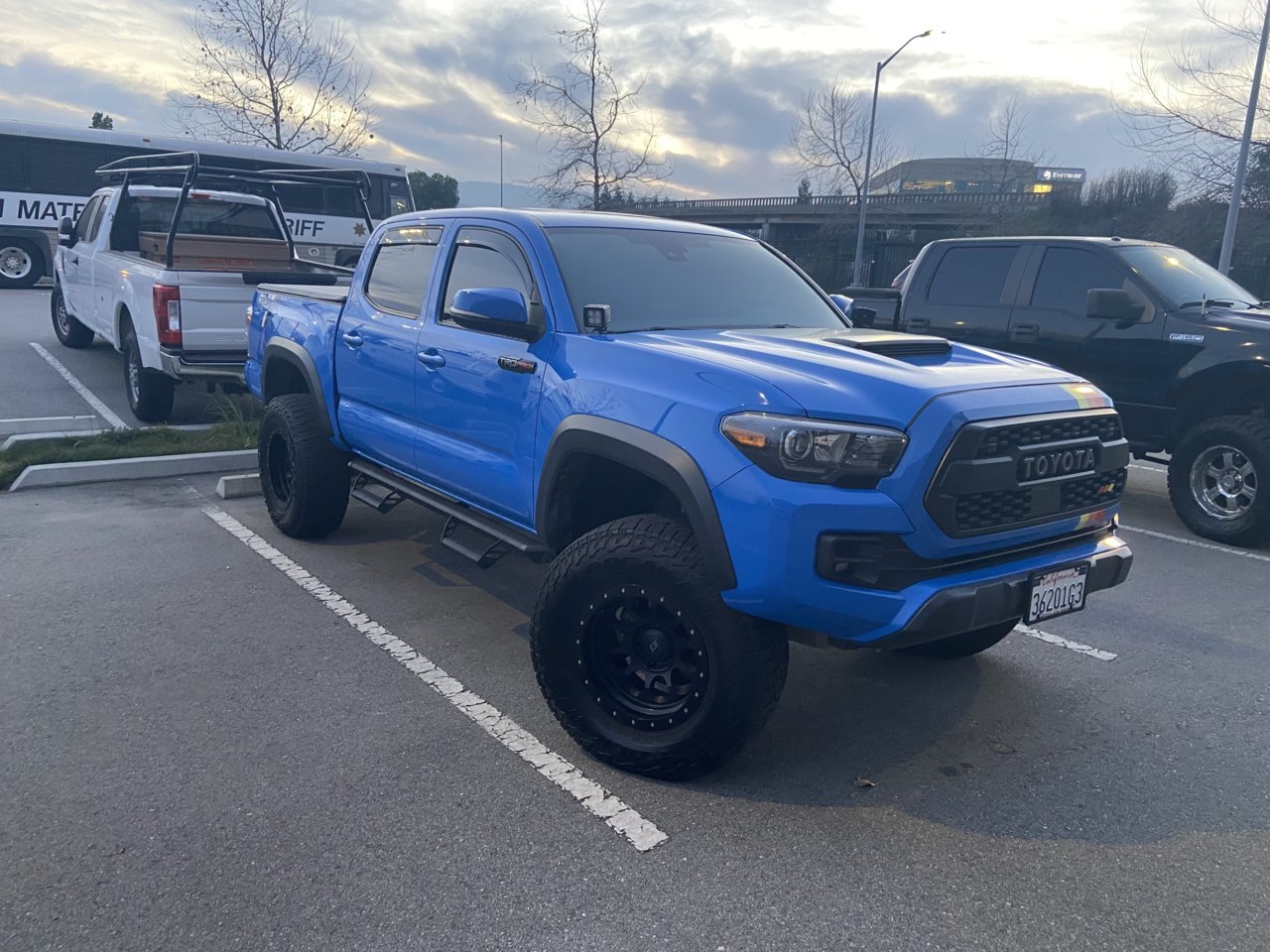

    OK, clearing 34's. . . . NOT so hard after all!
    What it is:
    Eibach Pro Lift Springs AND Westcott Fox Pro perch lift w/ CMR & Pinch Weld
    What it did:
    CLEARED 34's and NO fender cutting! WHOO! (Falken Wildpeak AT3 285/75-17 on SCS Ray10's -38)

    It’s gonna be tight.
    3” is a min. To clear a 34” with minimal additional fabrication. And a CMR really is a must. The CMC won’t do.
    hers what I did and I have no issues except a bit of rub in reverse at half to full lock.
    3” up front (westcott perch and Eibach pro springs)
    rear is Dakar medium packs with 1” eibach block =3.2” lift.
    17” -38 scs ray 10’s w/ falken wildpeaks 285/75 17.
    Alpine designs CMR
    SPC UCA’s.
    Stock trd pro fox shocks
    pinch weld removal
    so for the non Pro trucks, you’ll need just around 4” of lift to minimize cutting.
    the stance is aggressive with the -38, but I literally have done nothing else to the fender liners. The ride is AMAZING!

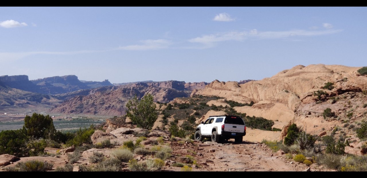

    Newer shot of my same old rig. 285/75s rubbed everywhere on Hell's Revenge.

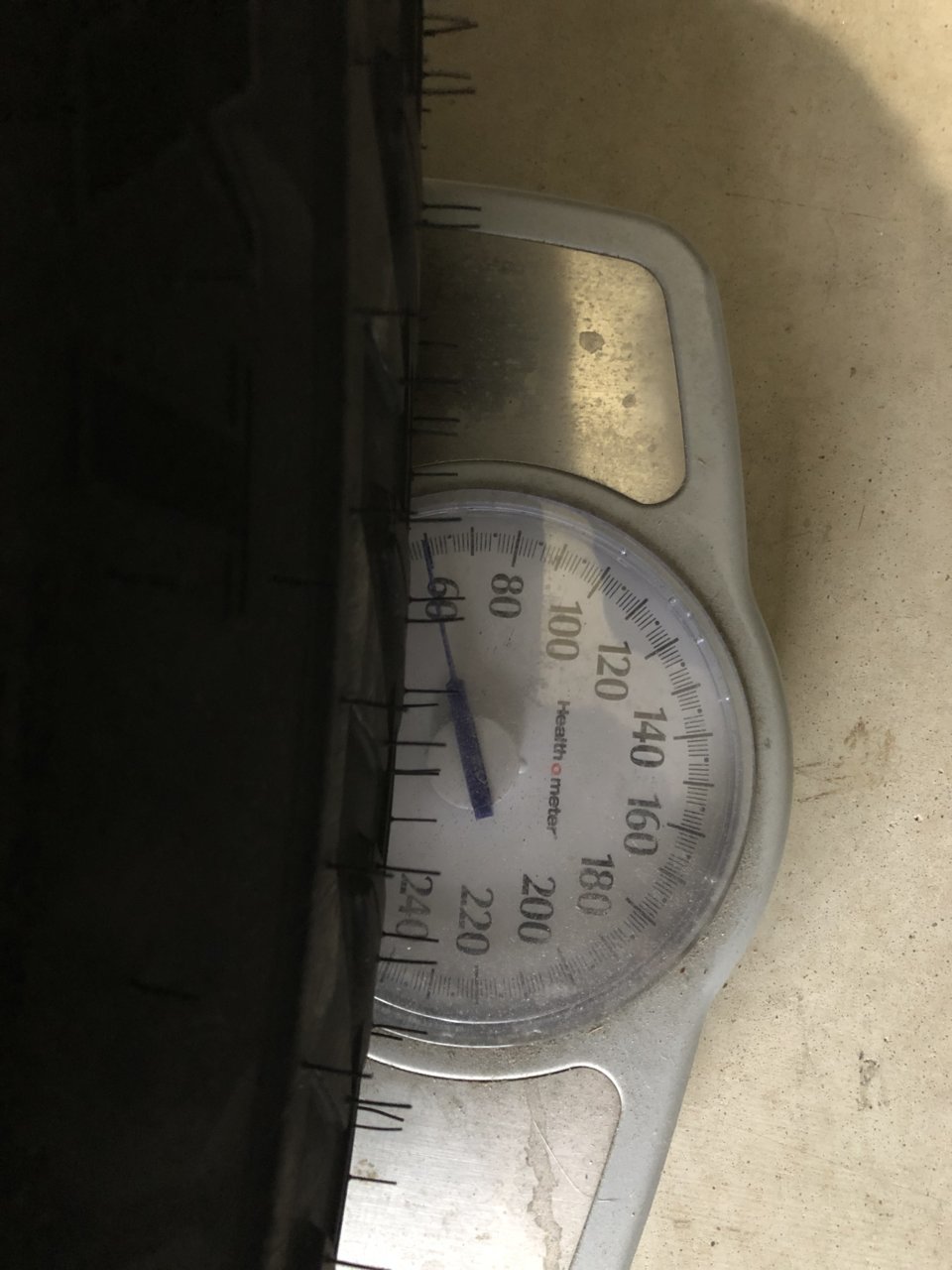

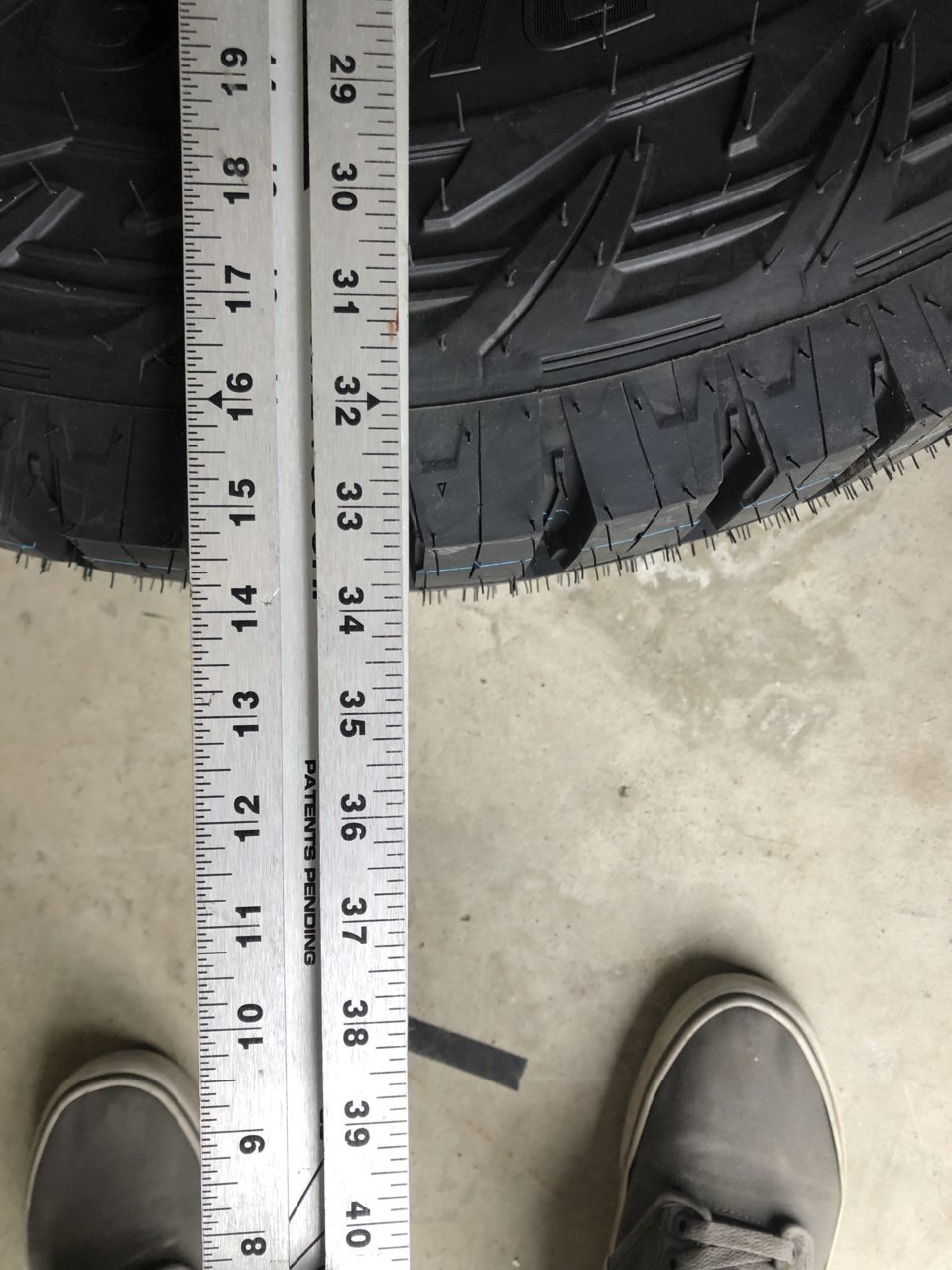

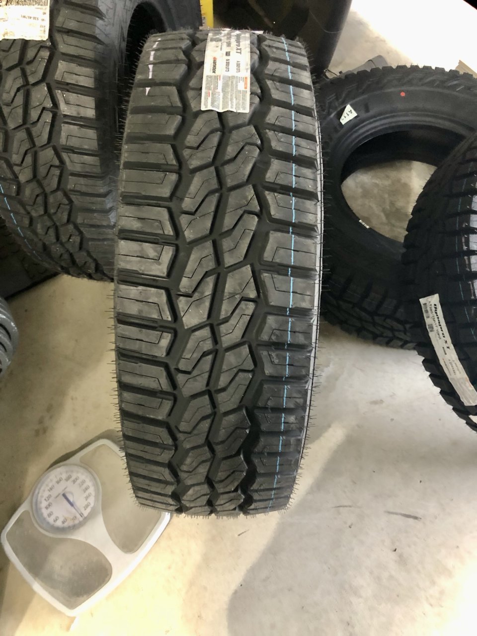

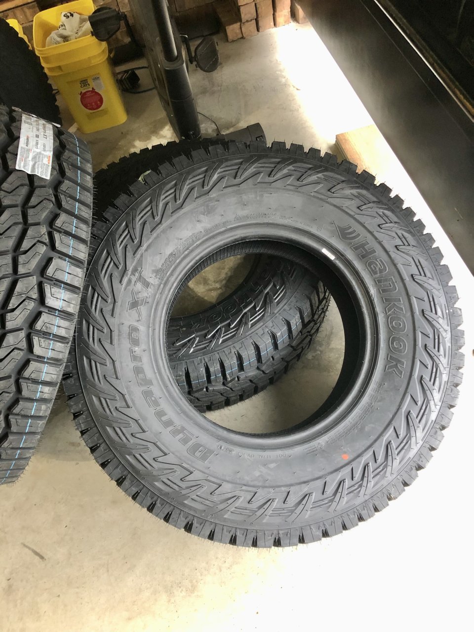

    Just received my new Hankook Dynapro Xt Rc10 LT285/75R17’s, FedEx say 60.3lbs each, my bathroom scale showed 60lbs. Measured at little over 33.75”, made in Korea stamped.
    Wally World charged me $770.16 + tax for 4 of them, could not pass them up, stoked !

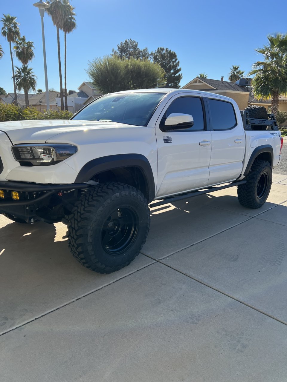

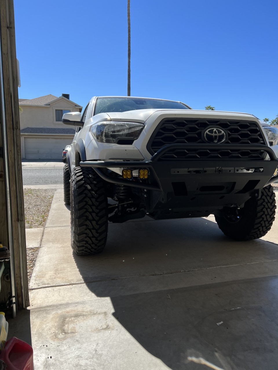

    Just put on 285/75/17 Toyo MT's, SCS gen 5 17x9 -38offset. CMC scheduled for next week. opened up a whole can of worms with this one lol the toyo mts are a stout 34

    That looks badass

    thank you i love the look!

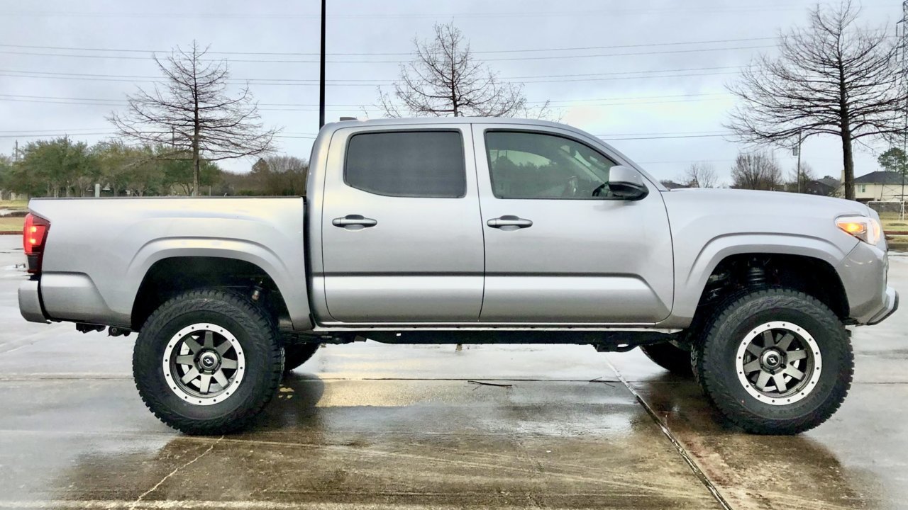

    Put them on today, might paint the wheels black. 285/75/17 Hankook XT’s.

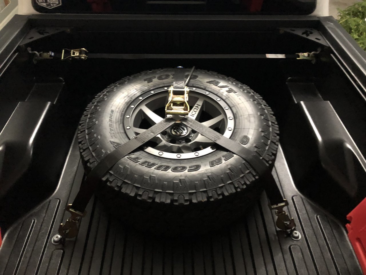

    Anyone know what the strap thing is called and where to buy one? I am looking to keep my spare in my bed completely flat (got a hard tri fold cover).
