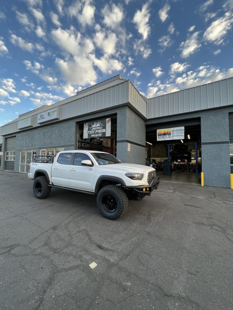

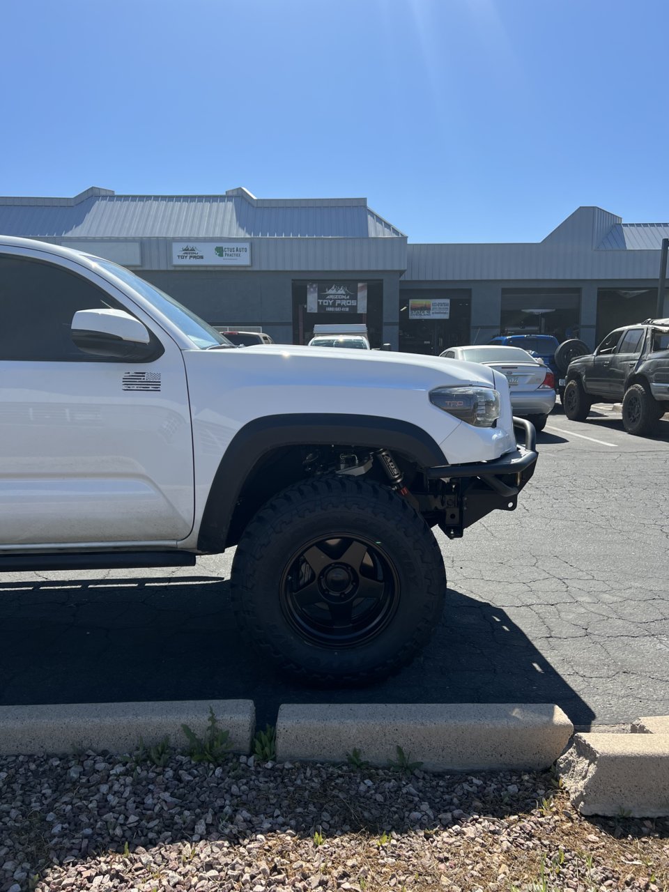

    the aggressive cmc helped a lot, still rub at full lock slightly but I can live with it, best you can get without cab relo which I didn’t wanna do

    Looks solid, hadn’t seen any -38s on 285/75/17 with the same C4 bumper. You have me sold on 285/75. I have an aggressive CMC already, do you know if your icon billet UCA are maxed on caster with the spacers provided? I’m on dirt king boxed poly bushing UCA with no adjustability… might need to get SPCs…

    Yes caster maxed out for sure, that might be required or else rub a shit ton more , the crazy offset is unforgiving lol

    yeah I love my look tho, was worth all the cutting and max efforts

    super clean

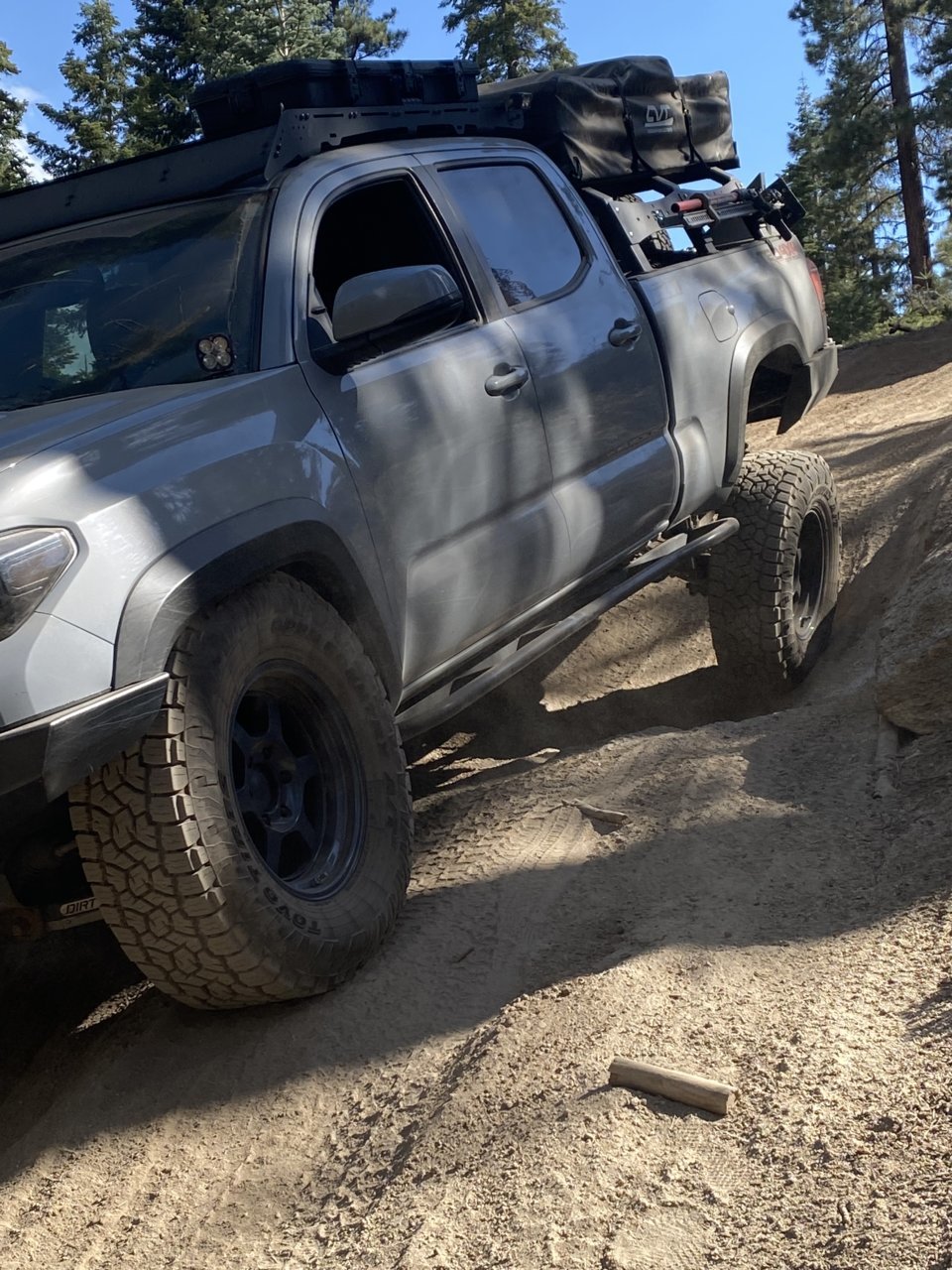

    Idk… I’m on 285/75/17 Toyo open country’s and rub. Maybe your talking just a street truck not rubbing? 2DD4EEA4-A858-4004-ABE6-619F55A05E73.jpg

    Well, yea, if you're going full stuff you're gonna rub, but you'd probably do that on 33's too. haha

    Are these 16” wheels?

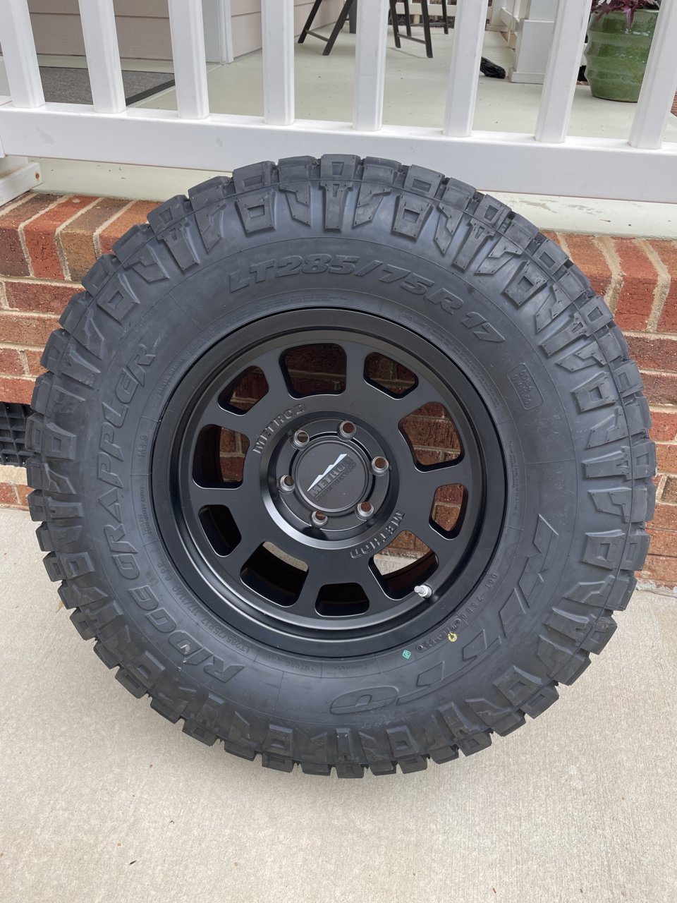

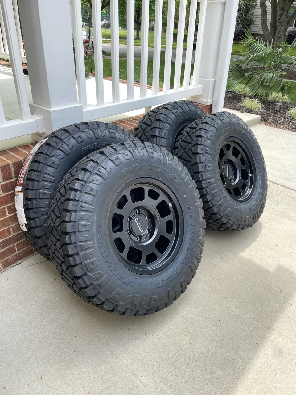

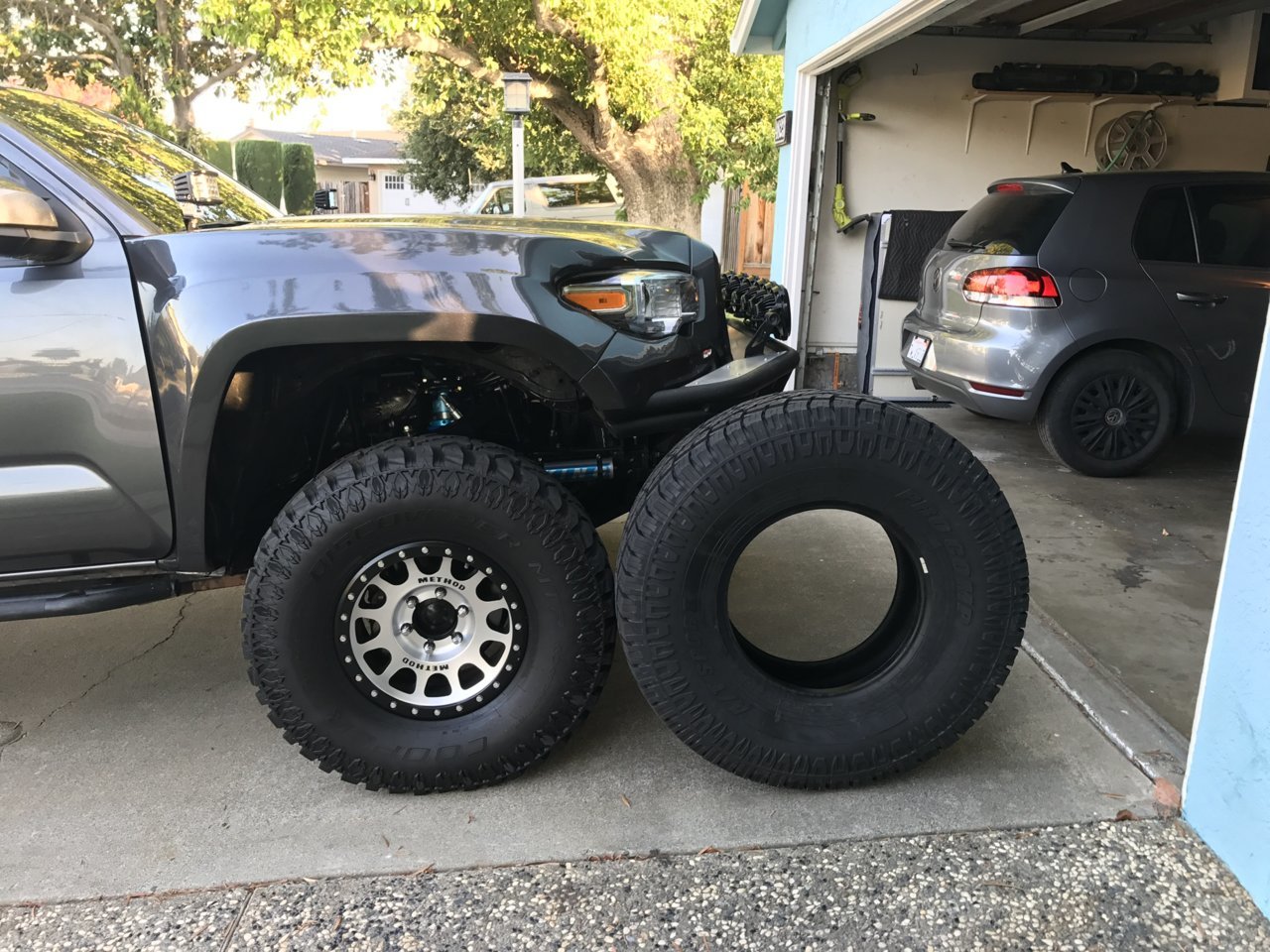

    These should do nicely.

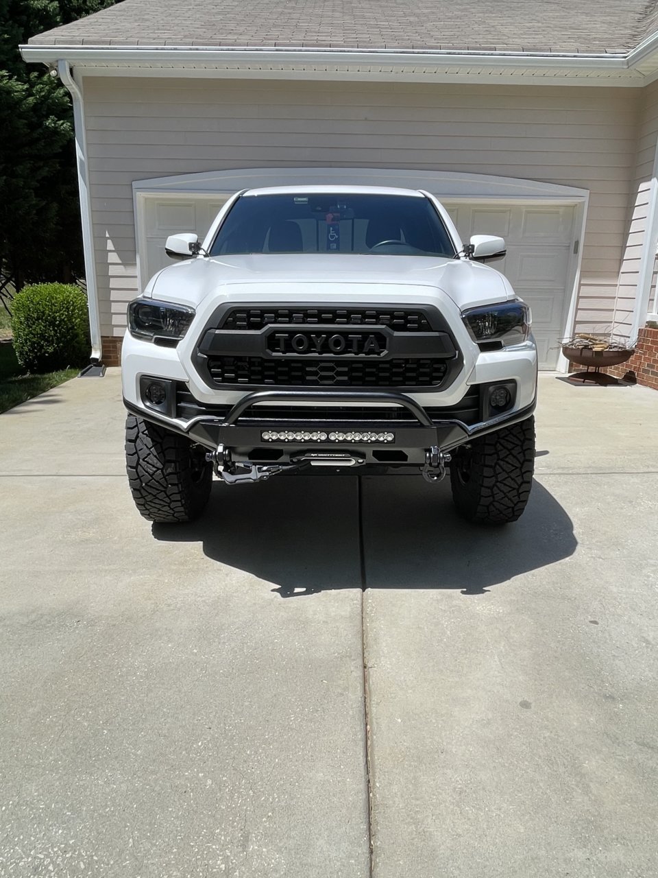

    285/75/17 Ridge Grapplers in C load.
    17x8.5 0 offset Methods
    3/4” Bora Spacer aka giving me a -19 offset.
    Super Happy.

    Same size and spec wheels I want to run with this tire size. What UCAs are you using? I did a CMC and would love to be able to pull this off without more rub using the correct alignment

    Uppers are SPC. Lowers are pushed max forward. Drt Fab CMR, but a deep CMC is going to be fine as well. Trim where needed.
    We did all the work ahead of time as wheels were on a huge back order. Everything fits great.

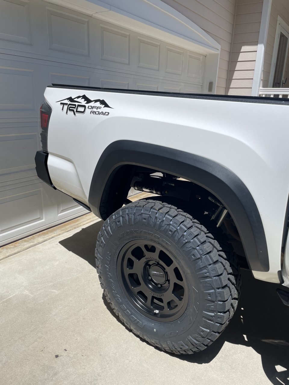

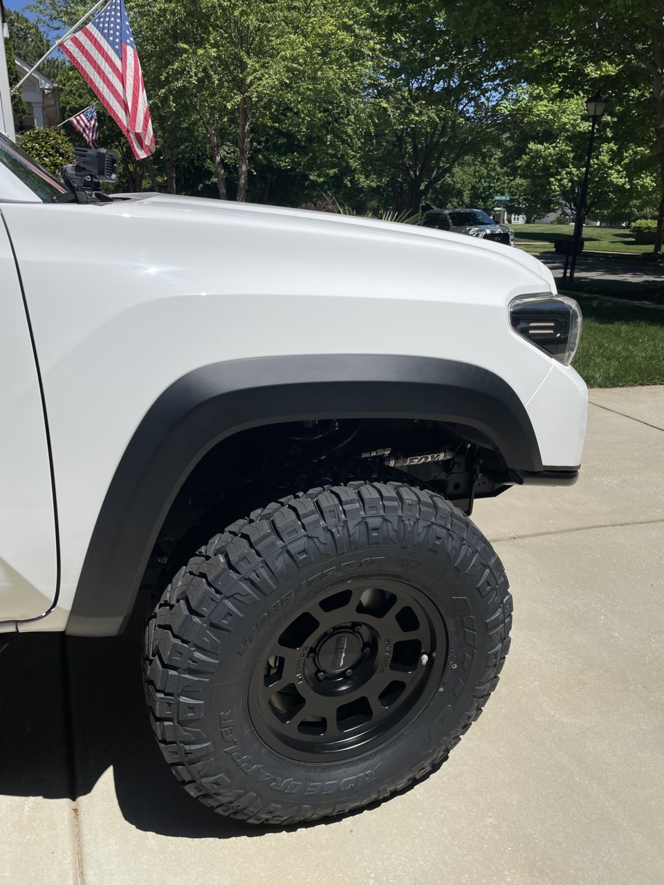

    Got some better pics today.

    Looks so good. I’m so sold on this tire size now.
