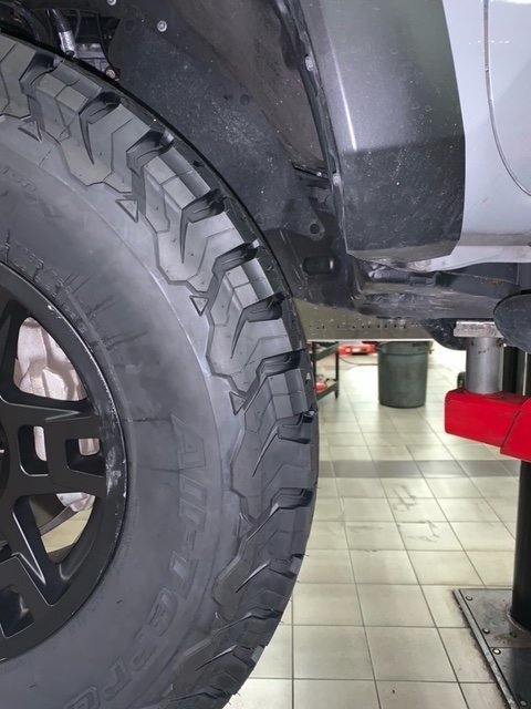

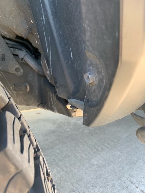

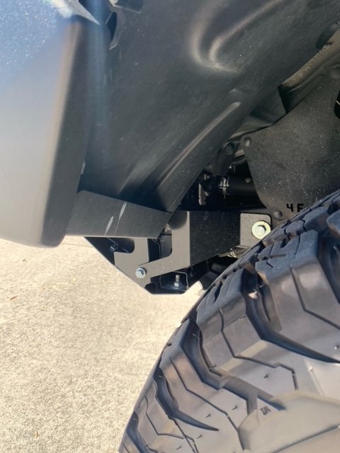

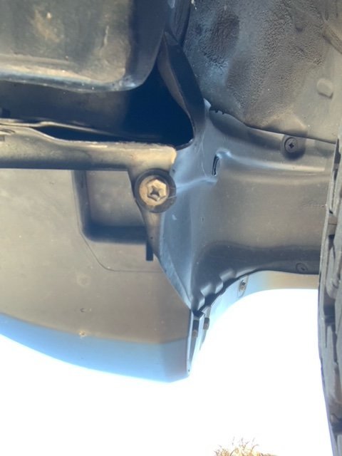

    Great thread. Has me debating now on to with 75s over 70s. I have a set of 17" TRD Pro 4Runner rims that I am looking to switch over from the TRD Pro 16s that are on it now. I have the clearance in the front with the ARB bumper that is on the truck but on the back end of the wheel well in the fender is where I forsee any contact. Looks like the previous owner did do something for clearance already but wanted to get your opinions on if you think I will need to cut or hammer out some more. These are of the driver's side wheel well. Looks like lots of room when the tires are straight but gets closer when turned. I'll see if I can get a pic of that.

    Safe bet i'd say you need to do a CMC/CMR + Pinch welds, also maybe additional plastic trimming in the fenders

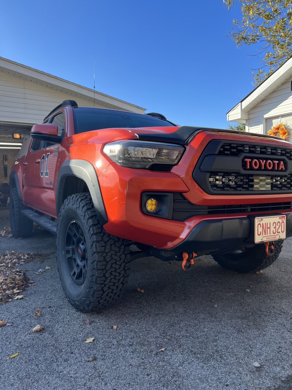

    AA515228-715E-4B93-B43E-17A3404FA909.jpg New shoes on the General… 285/75 KO2’s. First set of BFG’s. Second set of 34s. Love this size.

    Nice! Same setup I will be doing next week! How's the fit?

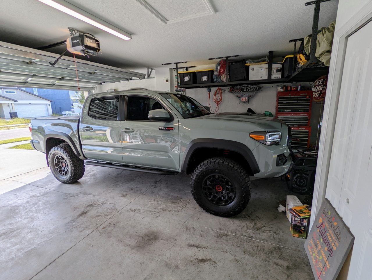

    Here's my 4runner wheels with 285/70/17 on a Pro.

    Clean! Like the new design pro wheel over the older one. Nice sliders too.

    Little rub on the plastic but to be expected. All in all they’re good.

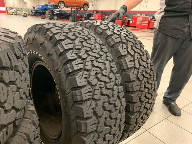

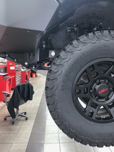

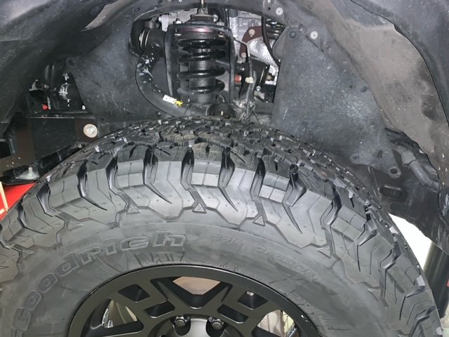

    Installed new rims (TRD Pro 4Runner wheels, matte black) and tires (BFG KO2 285/75/17) and glad that I went with this size. Looks great, perfect like this thread says! Didn't have to cut anymore than what was already done by the previous owner. Have a finger amount of space between the tire and swaybar and frame and no contact with the UCAs. Happy that I went with the 75s instead of the 70s. Was on the fence lol
    (Will be selling the old set of rims/tires if anyone is interested, PM me:))
    285/75/17s:
    Tires1.jpg Tires2.jpg Tires3.jpg Tires4.jpg Tires5.jpg Tires6.jpg Tires7.jpg Tires8.jpg Tires9.jpg Tires10.jpg
