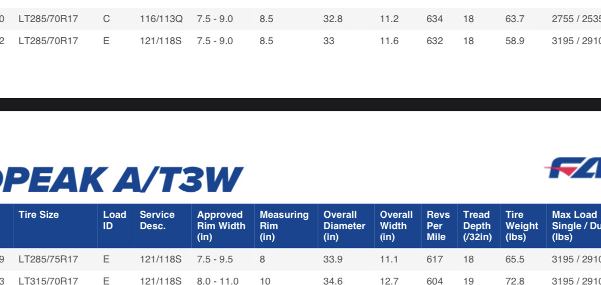

    So I haven’t read all 56 pages but skimmed some. It seems for the wildpeaks at least, that the 275/75 tire is a class E load only at 65.5lbs per tire. I’ve read it’s not recommended to run a e load tire on the Tacoma. Why is that? And also why would a C load tire weigh more than a E load at the same size?

    E load tires are heavy duty, they can handle more weight, higher psi and are less prone to puncture.They tend to weigh more, ride rougher and don't fold as well when aired down especially on a lighter vehicle. Not sure about the weight discrepancy.

    First, you don't need E rated's payload for a Tacoma. Yes, E also has higher ply rating, however I've seen E rated tires also cut sidewalls (watch your tire placement off road). As far as ride quality, personally, I have a Jeep TJ that use to have 32" C rated, and I went to 33" E rated (same Goodyear MT/Rs) and I noticed no difference in ride quality, and my TJ feels road conditions a lot more than my Tacoma does. I went with the E rated simply because that's what the 33's were.
    However, if the same size tire is available in C and E, I'd go with C to save some tire weight. I'm a huge believer in saving weight however you can.

    The E load only in the KO2 is a drawback for sure. Toyo AT/III has a C load option

    The interesting thing is Toyo shows the "C's" only a pound less than the "E's".

    Sorry let me explain again. So it seems a lot of guys say the 285/70 tires looks small say on a lifted 2-3” with coilover type setup. I was just using Wildpeaks bc that was what I planned to go with and what a lot of people recommended. 285/75 looks bigger but it’s only in a E load tire. But why is the c Load heavier in the same size?

    Very interesting bc a wildpeaks a c load is heavier by 5lbs

    Sorry, I missed your question ... wow, that is odd C is heavier?!
