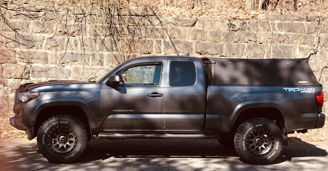

    2018 Access LB Tacoma in MDG
    EGCS bushing,SCS Ray10 wheels, Bilstein shocks, Kryptek seat covers, Softopper bed cover, speaker upgrade.
    I found that a slight lift and wheels designed for the Toyota was a good choice. Had it set up since 2018 I guess. IMG_2.jpg

  2. Nov 30, 2022 at 1:18 PM
    #1122
    CalcityRenegade
    CalcityRenegade Well-Known Member
    Jan 29, 2020
    #317623
    1,652
    Calgary, Alberta, Canada, Earth
    2023 T4R ORP KDSS
    I wonder if they mixed the two up?

  5. Nov 30, 2022 at 2:56 PM
    #1125
    Motofox
    Motofox Well known hermit
    Oct 7, 2017
    #232257
    1,573
    Stephen
    Northern California
    2014 DCLB
    custom pin-striping and dirt
    100% the poor person doing data entry fucked that up

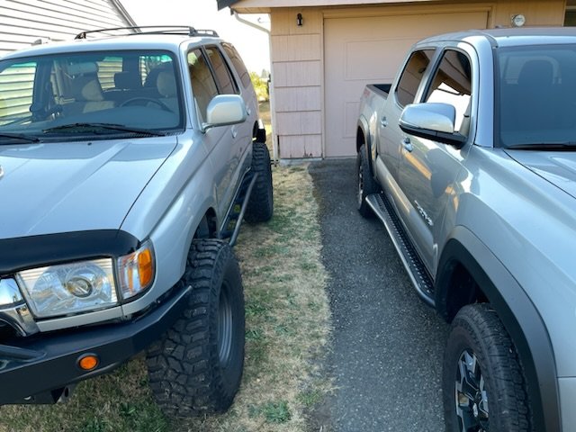

  11. Dec 10, 2022 at 9:55 PM
    #1131
    Road Bull
    Road Bull Well-Known Member
    Feb 28, 2017
    #211893
    380
    WA
    2022 Tacoma TRD OR; 2002 4Runner
    Cool. I was looking for examples of someone using a similar set up. I am just waiting on the 5160's and final tire selection.
    6112/5160’s (top clip both sides)
    3” leaf pack in the rear
    Spc UCA’s (set to max caste
    How is it all still working out for you?
    I have what you are running along with Icon RXT leaf packs.
    I didn't know if the 6112's up front would be enough for a 285/75/17 tire set up.
    I have SCS F5 wheels in 17x8.5" 4.30" -10mm.
    I also have Durobumps F/F with Durobumps flip kit.
    Some extended rear brake lines.
    I am still just trying to figure out how much I would need to cut with all my selections. I am down to do an aggressive CMC and fold over pinch welds and cut fender liners. I just don't want to cut much in the way of external fender stuff. I have a 2002 4Runner that I have built up w/ 35's and full armor. I want to keep this one fairly nice. I might not stick with that very long and end up going full potato with front and rear bumpers again. For now, all I have besides the lift coming is my RCI sliders, and RCI full steel skids. I like the size and proportions of the 285/75/17 because it looks like just about the largest size you can go without having to cut painted fenders and whatnot. I am hoping the size SCS F5's I picked will make be a good size that allows for clearance from suspension and body through the suspension cycle and, not so much that it rubs the top of the fenders. I had been considering 285/70/17, 255/80/17 & the 285/75/17 tire options, but I am attracted to this one the most.

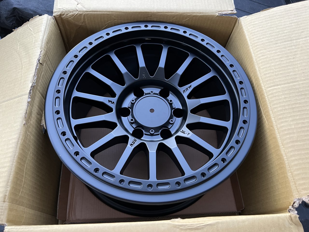

  20. Jan 1, 2023 at 7:07 PM
    #1140
    Mystery252
    Mystery252 Well-Known Member
    Aug 24, 2021
    #375179
    77
    285/75/17 Ridge Grapplers going on some RRW wheels next weekend!
