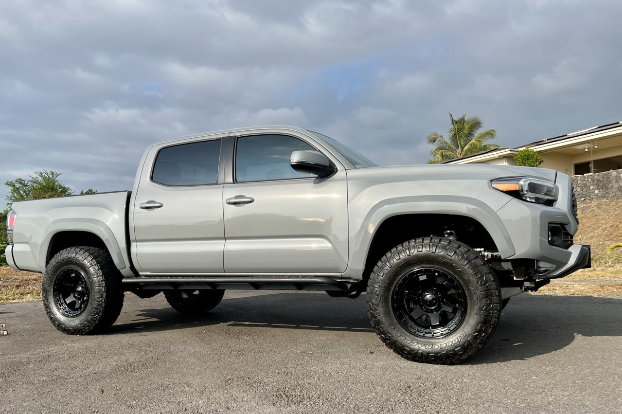

    Finally on! 285/75/17 Ridge Grapplers on RRW 17x8.5 -25 offset.

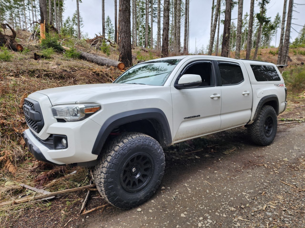

    Accutune Offroad 05+ Tacoma Mid Travel Suspension Kit, Stage 5A – Fox SKU: AOR-3000-0021 Adventure tune -Front Coilovers: Fox 2.5 Performance Elite Series, DSC -Sway bar relocation brackets included with shocks -Front UCA: AccuTune Offroad -Rear Shocks: Fox 2.5 x 12″ DSC – Modified -Rear Archive Garage Shock Relocation Brackets -Rear Springs: Icon RXT Pack -Archive Garage Rear Shock Relocation Brackets -Archive Garage Hammer Hangers -Rear U-Bolt: AccuTune Offroad -Rear +4″ Crown Performance Brake Lines Remove: Front UCA - Icon Delta Joint Add: Camburg Kinetik Series Billet Upper Control Arm, Uniball, 05+ Tacoma, 03+ 4Runner SKU: CAM-310103 Add: CAMBURG TOYOTA TACOMA PRE/4WD 05-20 PERFORMANCE SPINDLE KIT SKU: CAM-310114 Add: CAMBURG TOYOTA TACOMA PRE/4WD 16-20 PERFORMANCE LOWER ARM KIT Code: CAM-310126 Add: '05-CURRENT TOYOTA TACOMA CAMBURG FRONT BYPASS SHOCK MOUNT KIT add recommended FOX 2.5 bypass shock PART#: CAM-310052 Durpbumps - 3rd Gen Tacoma Front Off Road Bump Stops (2016-2023) DBF212 DRT Fab TACOMA CAB MOUNT RELOCATION DRT Fab UNIVERSAL HITCH SKID PLATE Fuel Offroad - Block Model D752 - 17x9 Matte Anthracite w/ Black Ring Negative -12 offset Nitto Ridge Grappler 285/70r17 Nitro Gear and Axle '16-CURRENT TOYOTA TACOMA W/8.75 INCH REAR 4.88 RATIO FRONT AND REAR GEAR PACKAGE KIT VENDOR: Nitro Gear and Axle PART#: GPTACO2016-4.88-8.75 Yes to REM gear polish OV Tune Tacoma 3.5L vF Tune Pack Get right tune for gearing of 4.88 Vftuner.com Nitro Gear and Axle '05-CURRENT TOYOTA TACOMA 8" CLAMSHELL STUB AXLE BUSHING VENDOR: Nitro Gear and Axle PART#: NITRO-AKT8S S.O.S Performance Stoptech 6 PISTON FRONT BIG BRAKE KIT fits 2005-21 TOYOTA TACOMA TR340.6TA SOS PERFORMANCE 4x4 Black Slotted rotors Paint fender flares cement gray to match Custom Viper Cut Front bumper. Seibon Carbon - TR-STYLE CARBON FIBER HOOD FOR 2016-2021 TOYOTA TACOMA, custom painting to look like a TRD Pro. C4 Fab - TACOMA ROCK SLIDERS / 3RD GEN / 2016+, shipped raw, line-x by local shop TACOMA BED STIFFENERS - 3RD GEN, 2016-2023 TOYOTA TACOMA ACCESSORIES,REAR CHANNEL BED STIFFENERS, PART #48676 Wet Okole Seat Covers WeatherTech Floor Liners Full Custom Stereo with 2x8” subs behind the seat, Kenwood head unit. Taco Garage - Dashtop Multi Mount (DMM) for RAM mount system Toyota - TRD Pro Skid Plate Toyota – Bed Mount Step
    They are the perfect size imo. But they took some work to get em to fit.
    Cab mount chop, viper cuts, fender trimming.
    Every time I go offroad I come home and seem to grind a little more.

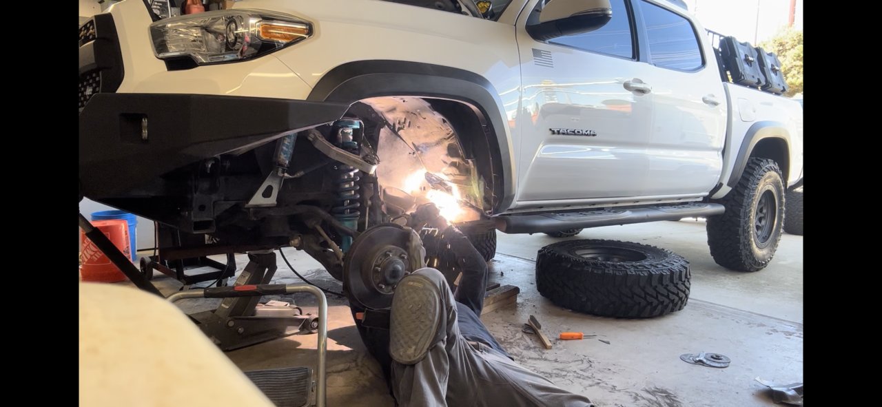

    6C3992AC-5F6C-4244-B29F-C1E2FEEC0F9D.jpg B74F8474-6A3E-444B-8329-2998A38F7CF9.jpg 7E4DA9CF-6607-4053-9428-06B0B53EF204.jpg Welp. Gotta say, I’m bummed it’s over. Really enjoyed cutting up my truck. The CMC wasn’t bad at all. Pain in the ass to weld though. Molten metal is hot fyi..
    4.88’s and these tires get along great. Still in the break in of the gears so still have yet to drop the hammer. But, between gears and Dave from KD Maxx updating my tune to said new gears, I can tell she wants to run. Super duper happy fellas…

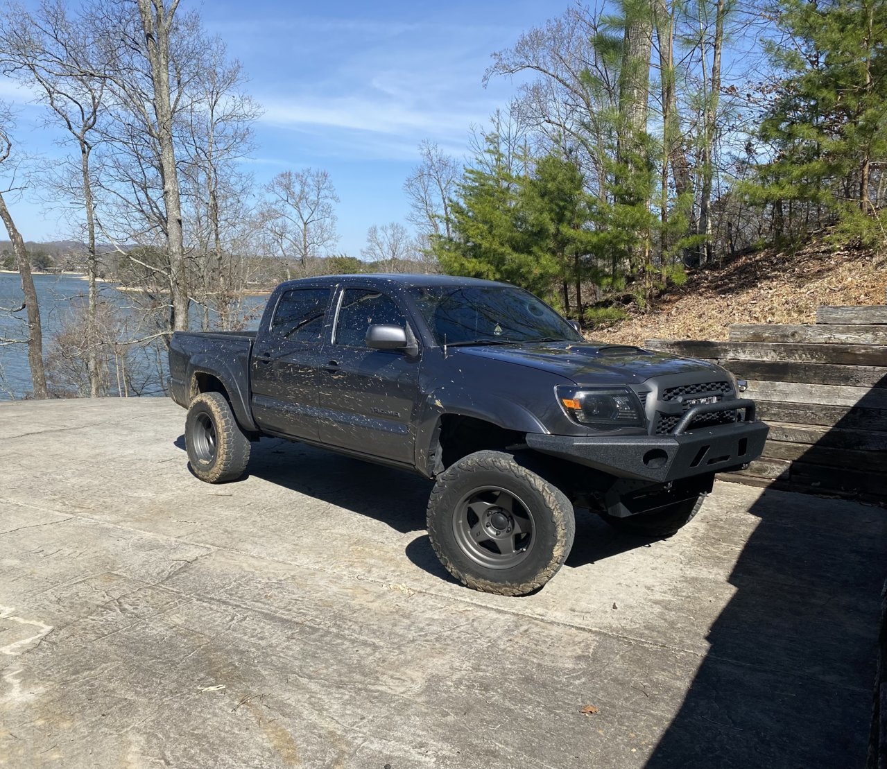

    I’m currently on bald ass 285/70/17 KO2’s, and running -38 offset F5’s. Been on the fence between these, 295/70/17, and 305/70/17. I just ran into a friend who got some 285/75/17 Geolandars on her FJ and between that, and you fellas I think I’m sold. Hopefully update here in a month or so!!

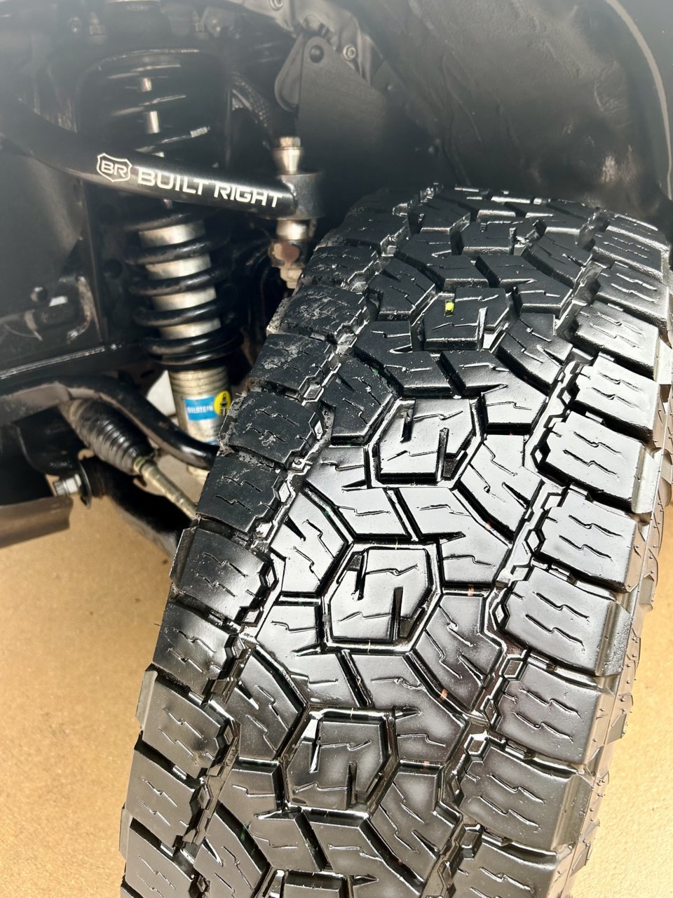

    Do it!
    I love it. I just made the change last week. BTW, I would consider the Nitto Ridge Grapplers. I got them on Amazon for a little over $1300 delivered. Their unbelievably quiet on the road and handle great offroad!

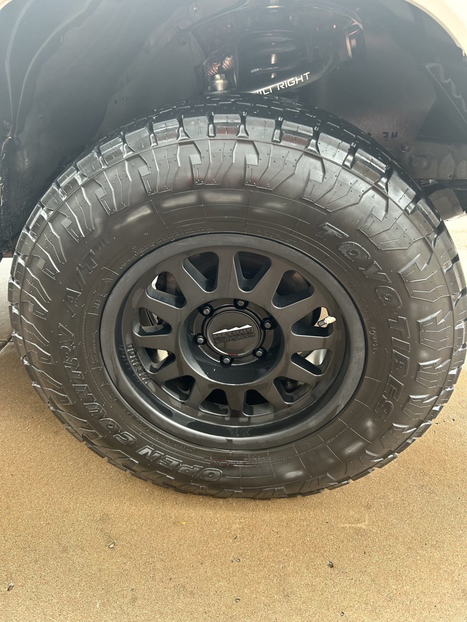

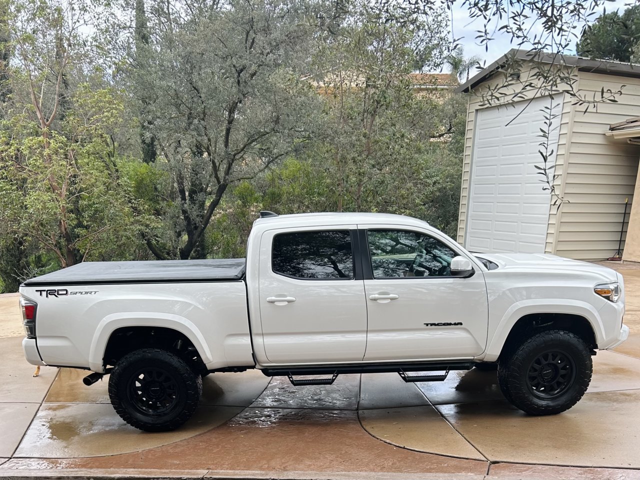

    I went with LT 285/70R17 Toyo Open Country AT 3:

    Wrong thread, my friend. 285/75r17. Nice looking truck though.

    Yeah I probably wouldn’t have laid under the part I was welding unless I was tigging it. I always lay off to the side if I have to weld on my back…too many pock mark scars on my abdomen and chest to attest to the lessons learned there.

    Thats exactly it. I’m on dirt roads at most, the RG’s will be plenty but those muds look so good. Sometimes I’m in the crap to get somewhere, not out there wheeling just for fun. I think if I go RG, I’m going to go for the 305’s. Decisions decisions…
    Either way, glad I found this thread with some great rigs. The diameter makes it look great on 17’s.
    oh, and thanks for letting a 2nd gen hang lol

    Bro, I blew coffee out my nose when I read this at 0330 this AM. Thanks for the laugh my man
