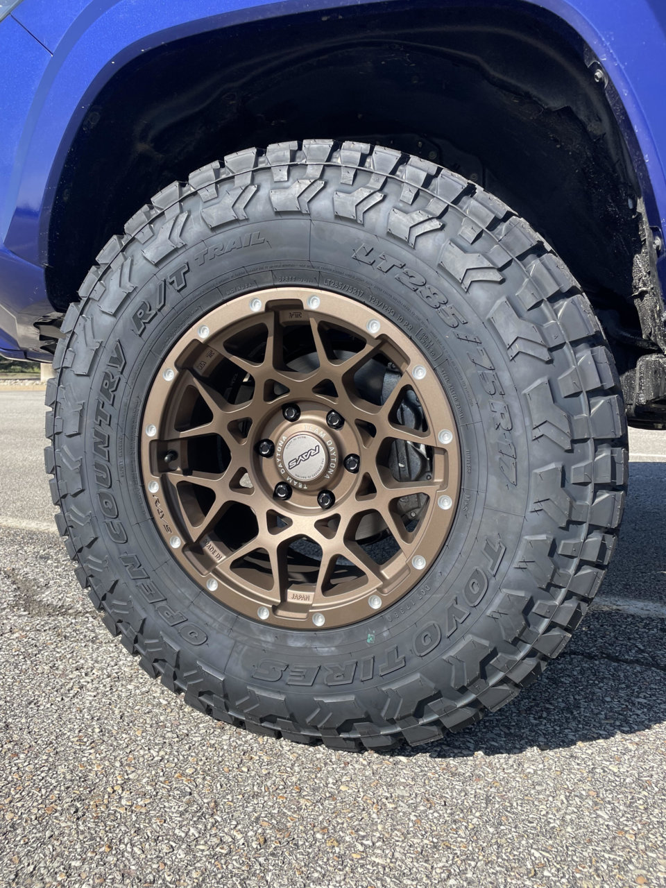

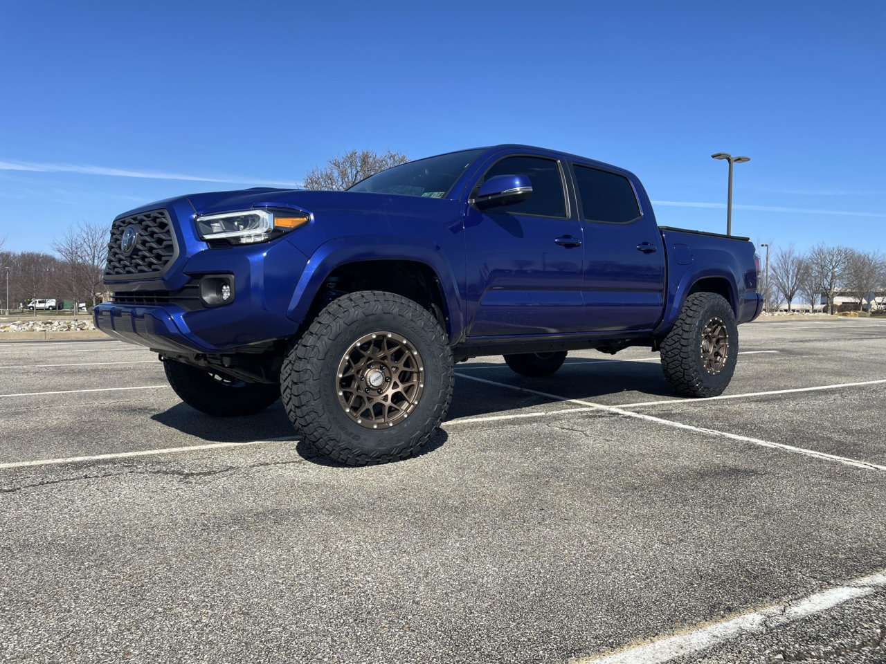

    Wiseone
    Wiseone Well-Known Member
    Jan 10, 2017
    #207191
    64
    Jacob
    Pittsburgh
    2023 Trd Sport
    285/75/17 toyo open country R/T trails on on rays daytona M8s. Really happy with how it looks!
