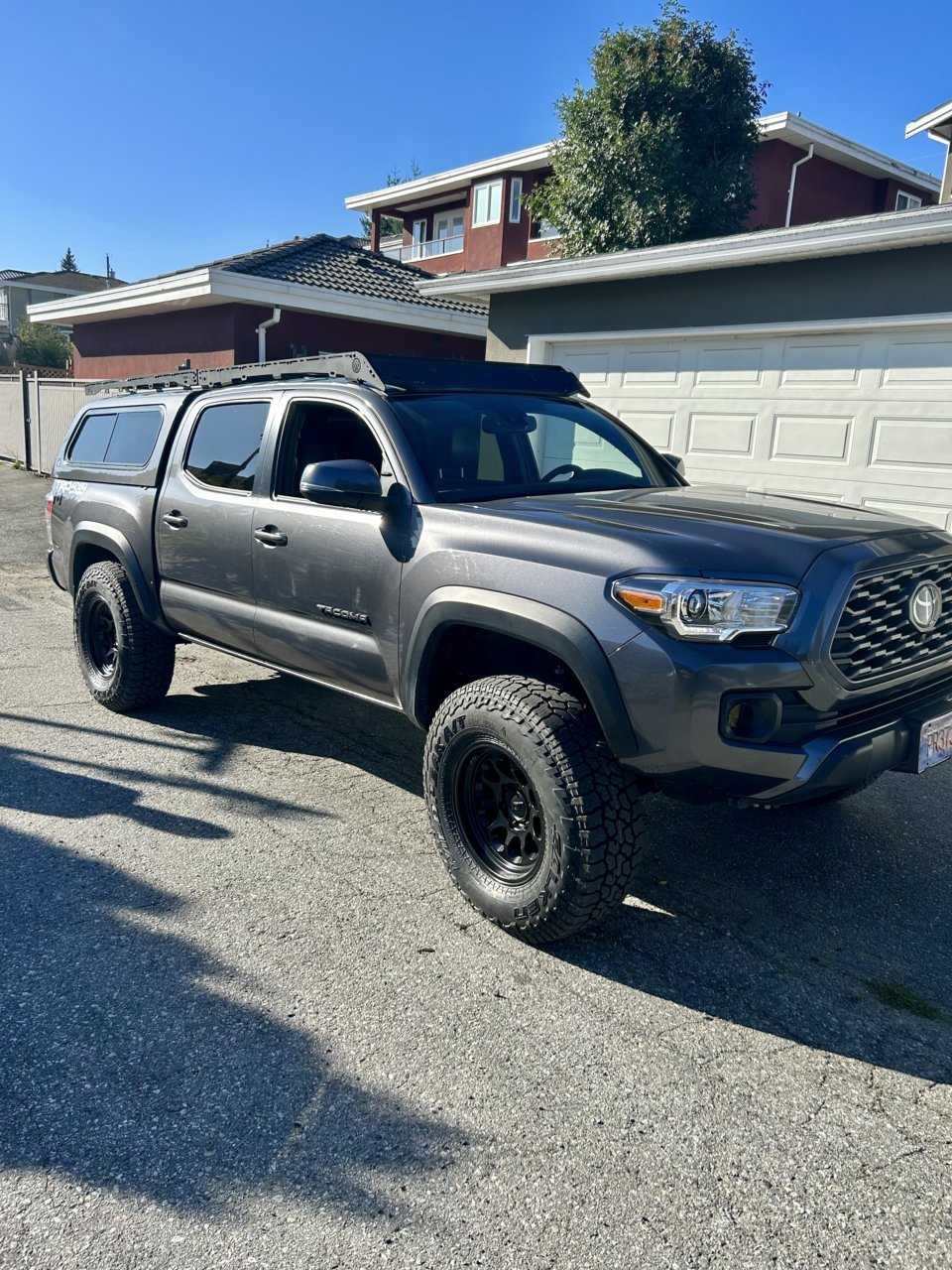

    285/75/17 Yoko Geolandar MT’s.
    Got about 8500 miles on them, mix of highway and trail miles.

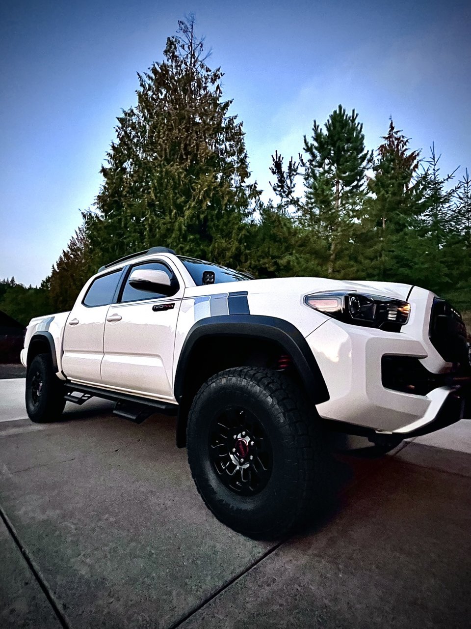

    Anyone else running Toyo AT3’s in E load? If so, what tire pressure are you running? I’m currently rolling at 36 lbs.IMG_1953.jpg

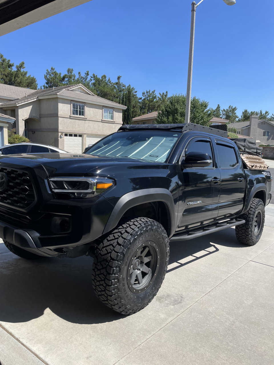

    Westcott Designs Toyo 285/75/16
    36 is where Les Schwab set mine. Ride is awesome.

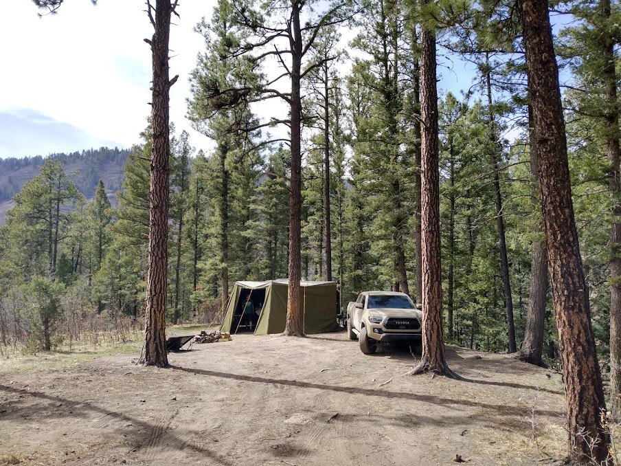

    You're not wrong, there can be a LOT of mud.................which is why all of our vacations take place a LONG ways away from the city.
    Thats why this is what our vacations normally look like:
    01 dhrracer[QUOTED] likes this.

    Its a remote dispersed camp area in the Pecos Wilderness area, a bit north of Tererro NM, and about and hour NW of Santa Fe New Mexico. We hit 72mph winds the night that pic was taken and utterly RIPPED apart our OD awning in that pic.
