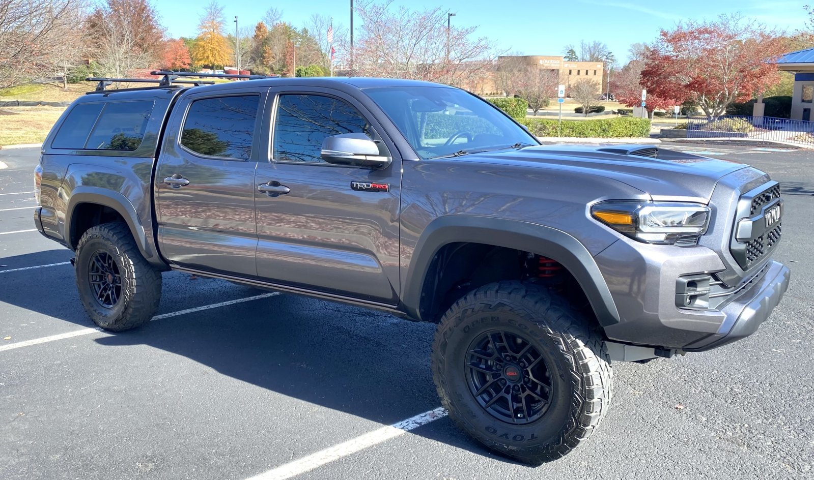

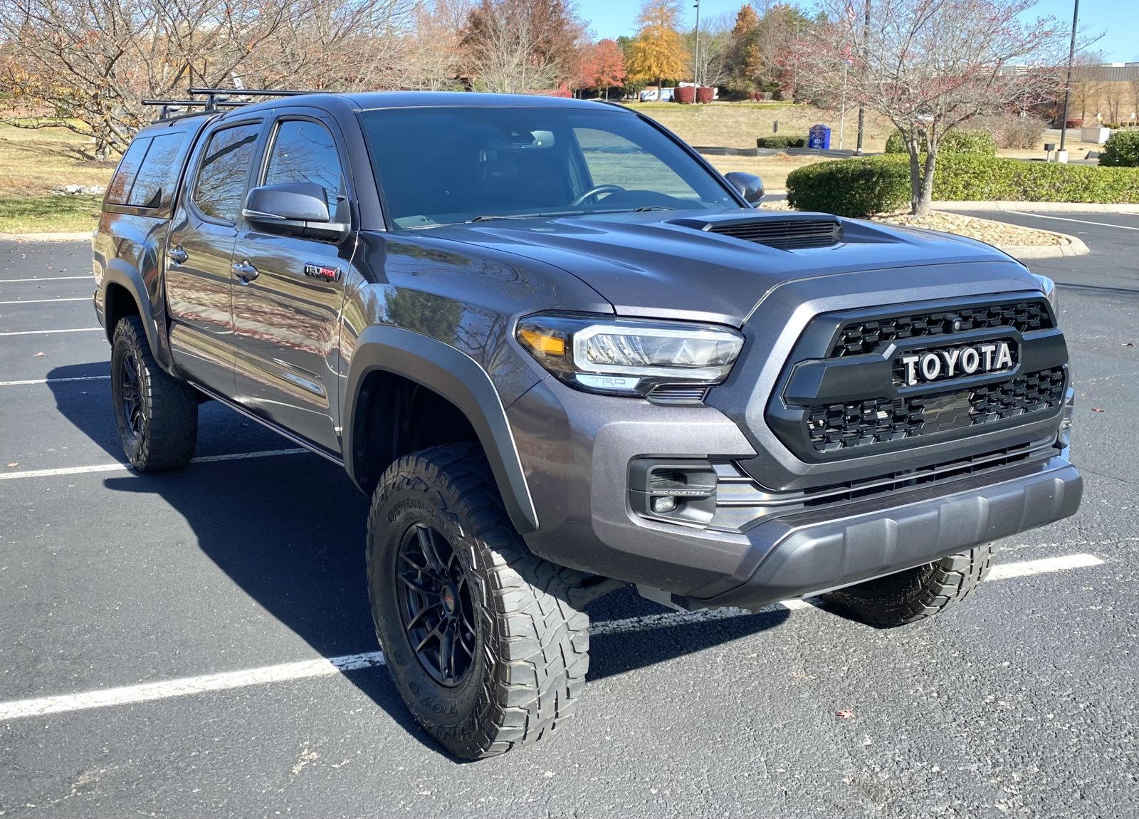

    The more I read this thread the more i am confused on my situation. I picked up a 2020 TRD Pro yesterday with 19k miles like new condition, and it has a set of Toyo 285/75R/16 tires. The tires are shot pretty much so I ordered a set of BFG KO2 AT (285/75R/16). The previous owner put a crappy spacer lift on which looks to be 2 1/2 to 3", but the tires fit perfectly with no rubbing and there are no signs of pinch weld mods or inner fender adjustments. As soon as I get the new tires on, I will be looking into a proper lift. Had a 3" Toytec on my 4Runner with 285s and those fit fine with no adjustments needed (Probably not going with Toytec again though). Any thoughts on how this previous owner made these fit with no real adjustments? I would love your input on Lift recommendations for this setup (I realize thats like asking which oil to use, but lay it on me.)
    Anyway here's the new (To Me) TRD.

    Are you ABSOLUTELY sure that is an actual Pro?
    I only ask and others who are more knowledgeable may correct me because I'm definitely not usually the sharpest crayon in the box, but I have a 2020 and AFAIA the 2020 Pro only came in 1 color and that was Army Green.
    I could be wrong here but that has always been my understanding.

    Yes I am sure it is a Pro.
    The colors for 2020 came in the following:
    Super White, Magnetic Gray Metallic, Midnight Black Metallic, and Army Green

    Yes, army green was the “exclusive” colour.

    I was iffy on it but seeing this pic, that grill looks damn good

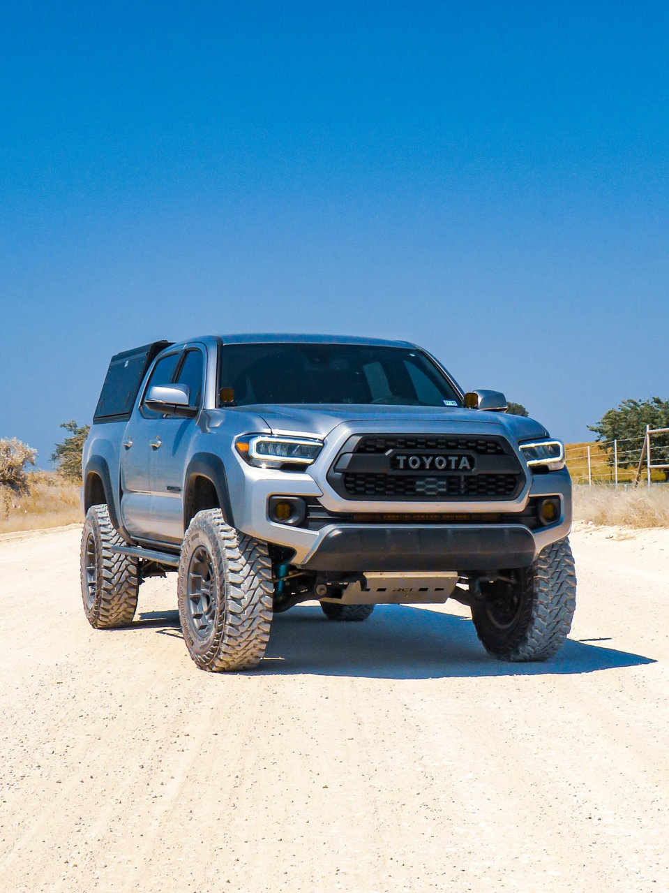

    Do you mind sharing your lift specs? Your truck sits exactly how I'd like mine to be.

    For sure man.
    King 2.5 extended coilovers and shocks
    650lb springs and OME Dakar Heavy duty leaf pack
    SPC UCA’s
    I have right around 2.75” of lift. Very happy with how it turned out. I wanted to keep some rake since I load the bed up for camping/offroad trips, same reason I opted for the HD leaf pack.

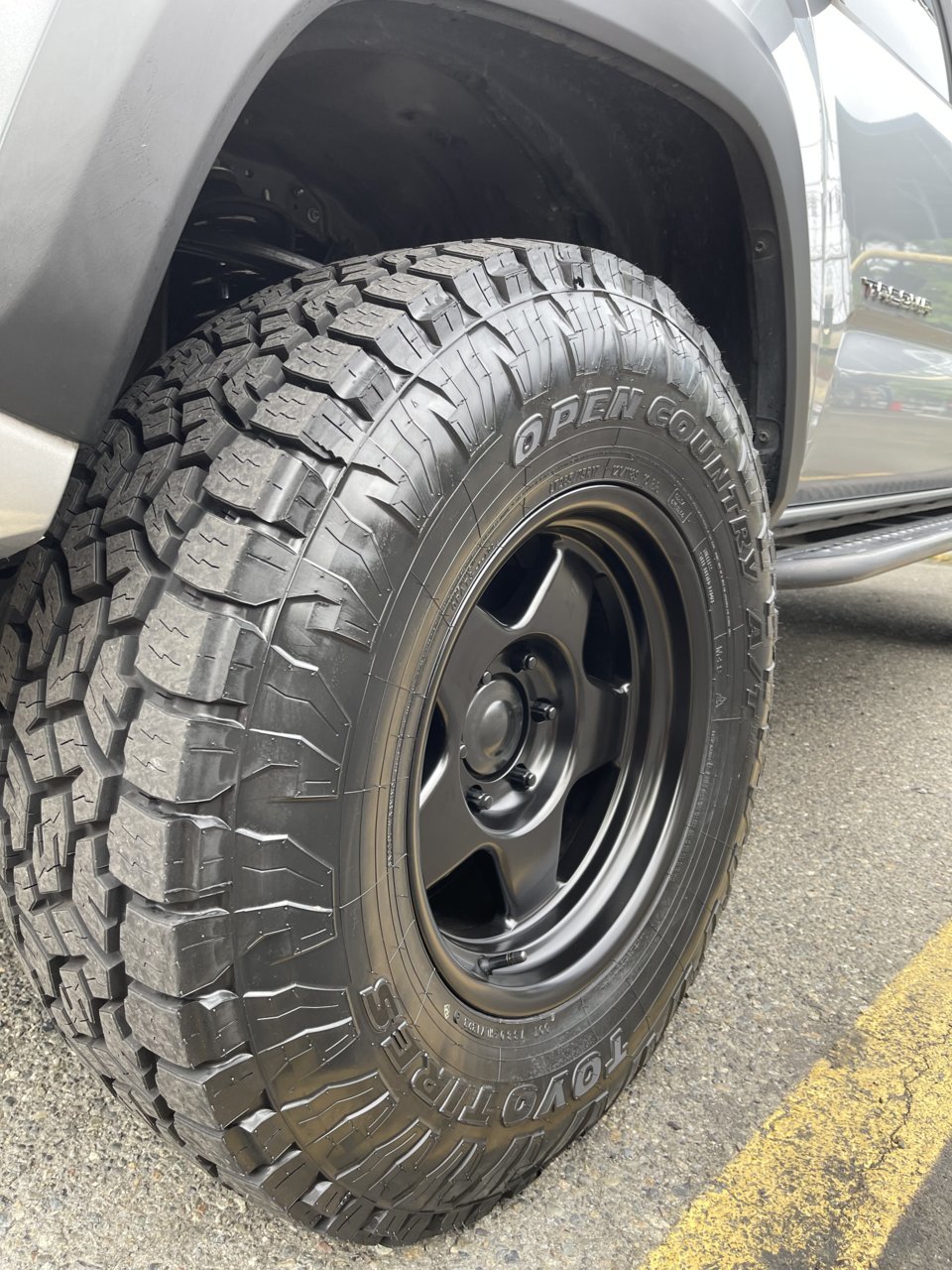

    Feel like I’m asking a similar question to others before, but going to anyway for my specifics.
    I have a 2.5in lift in front and 2in rear with 0 offset 4.75in backspace wheels. Lil B’s hybrid bumper in front so fully trimmed up there. Aggressive CMC scheduled where pinch welds will be knocked back too. Running Ironman UCAs currently which should be good to run 11.5in width tires just fine. Though I might change them to DK or Icon; not sure.
    Should I be expecting any real issues with fitment? I don’t mind knocking back the rear-facing liner in front. Probably don’t mind cutting the fender to be honest but would rather not.
    Floating between these 285/75r17 and 255/80r17. I don’t wheel a ton since I never have time, but I do care about fitment when I do. A bit more tire size for clearance probably doesn’t matter if I keep smacking shit in the wells.
    And tbh, I’m more worried about clearance under full stuff in the rear.
