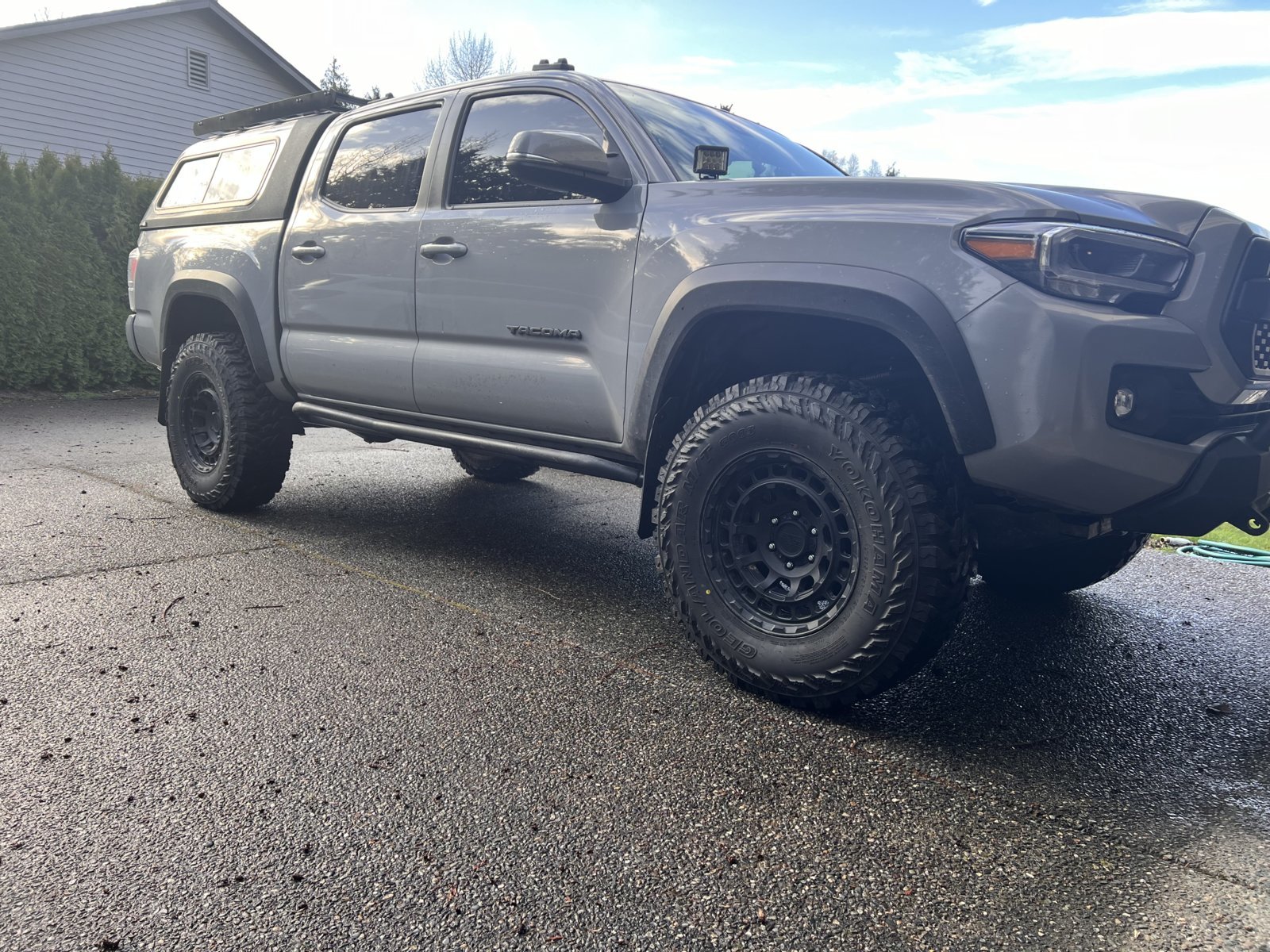

  16. Mar 23, 2024 at 9:45 AM
    #1256
    Pnw_tnerb
    Pnw_tnerb Active Member
    Nov 5, 2023
    #436871
    40
    2021 sc Tacoma
    Put these on 2 days ago. 2” lift, 0 offset methods, stock uca. Cab mount chop has been done. Tires will rub a tiny bit up front but nothing to worry about. Caster is set at 3. They get close to to Uca but don’t rub.
