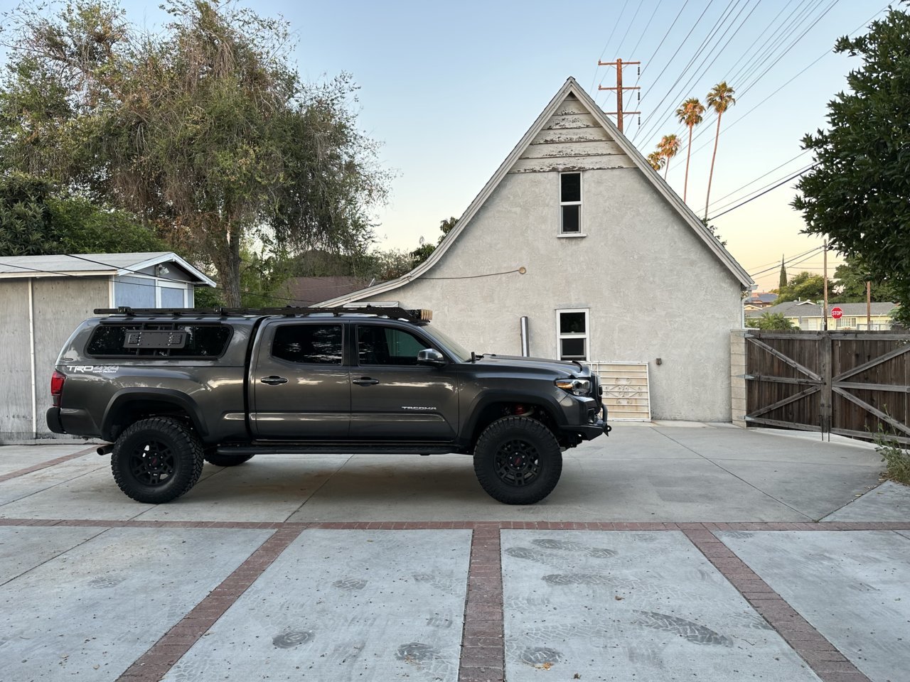

    Ome 3" front lift (887 coils & nitrogen sport shocks) 2" ready lift rear blocks w/ ome nitrogen sport shocks 285/70/17 bfg k02's on 17x7 trd pro 4Runner wheels Bakflip teaunno cover N fab step bars Heritage grill 15% window tint
    Pic for reference

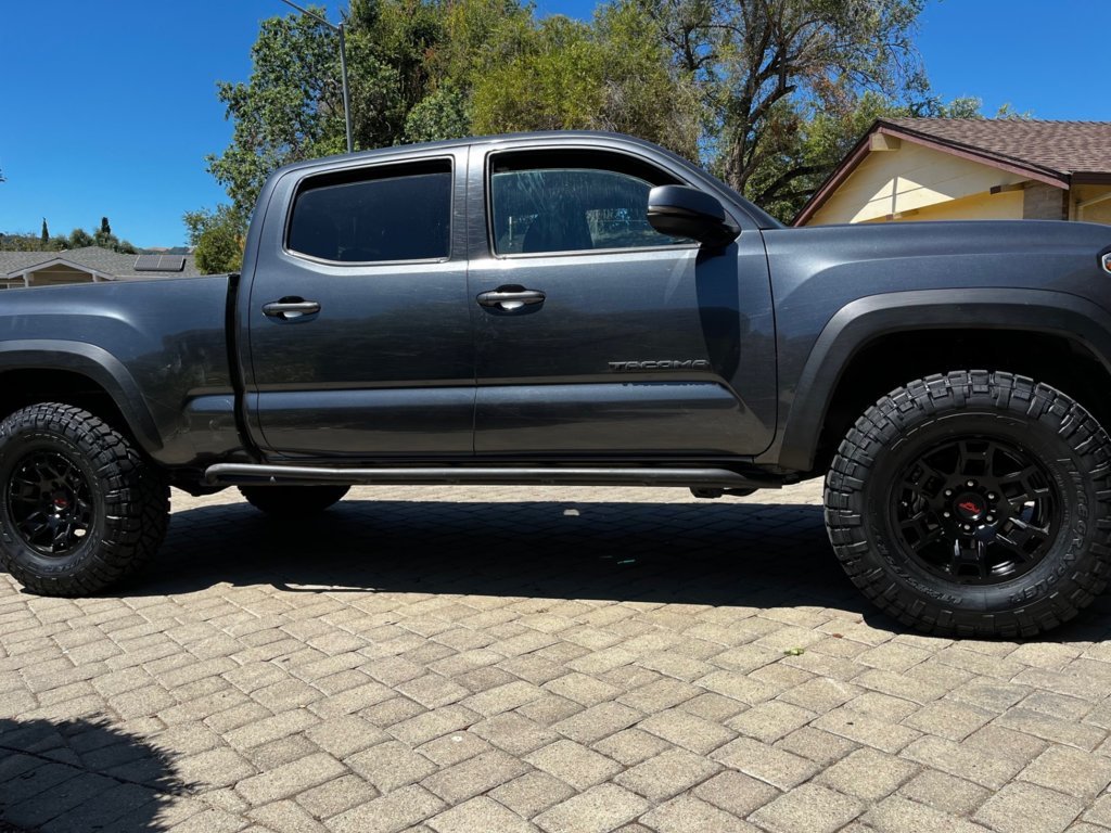

    2017 tacoma trd offroad
    Stock 17” trd pro 4Runner wheels

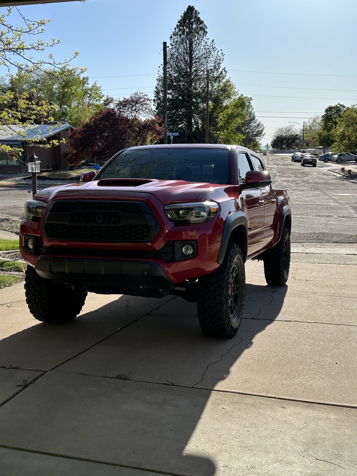

    New member, but spent two years on this thread. Finally able to comment. Appreciate the help on this thread, nice to have actual helpful information. Toyo open country rt’s, UCA’s, diff drop, cmc, fox 2.5’s with a 2.5” lift, new fender liners, needle bearing replaced, wheels are a -12 offset.

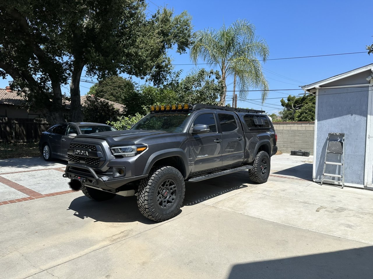

    2021 TRD OR

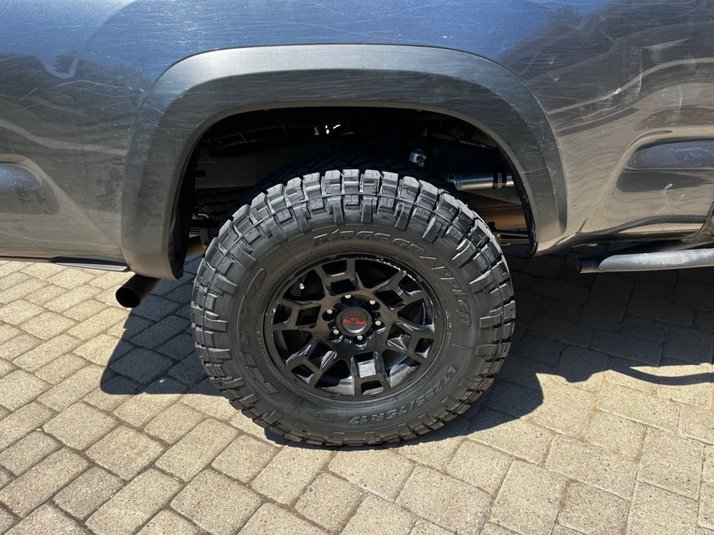

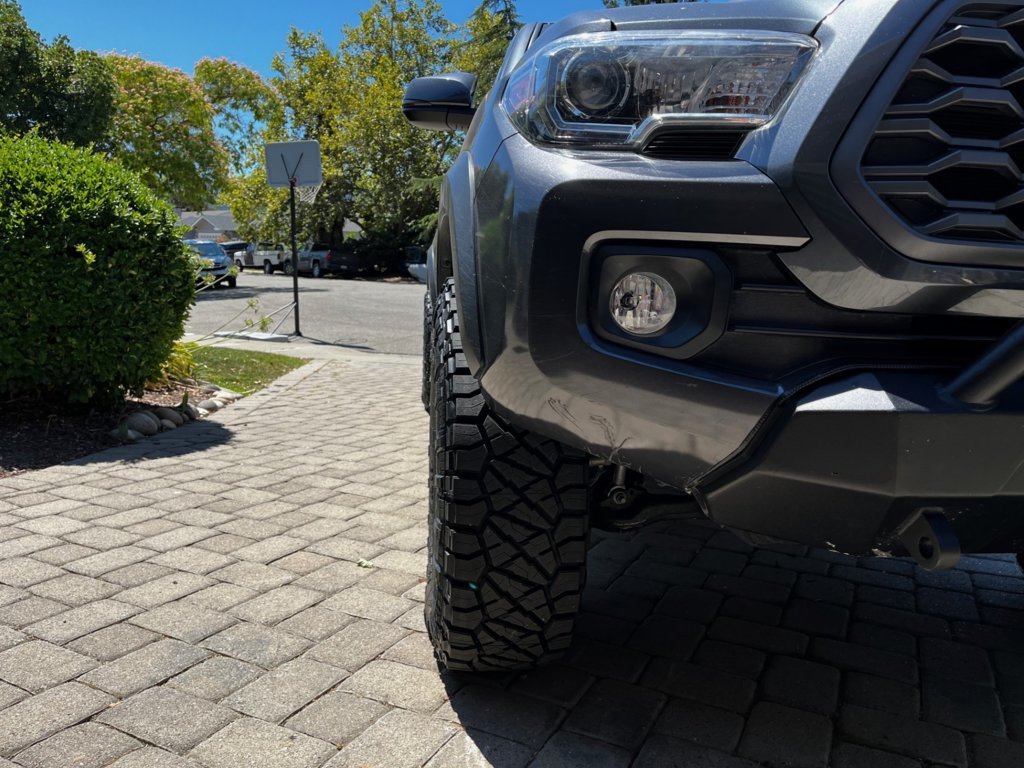

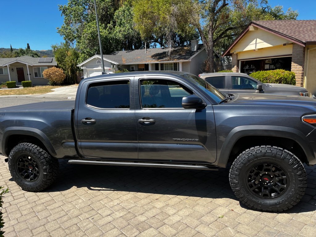

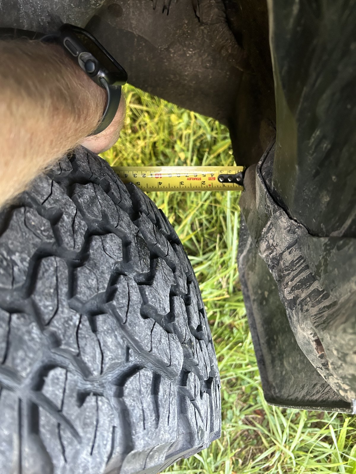

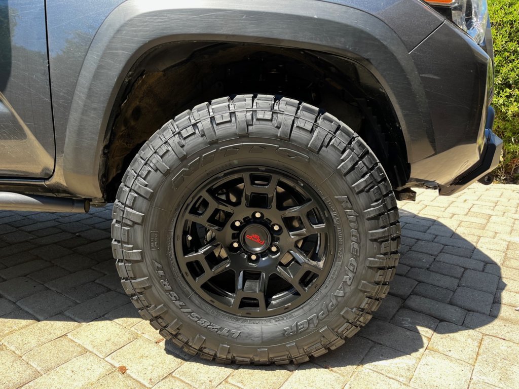

    This thread convinced me. Nitto RGs went on the long boy today. I am very pleased, they fill the wheel well nicely and I measured over an inch of extra ground clearance at the lower control arms over my worn out 265/70's. I can actually notice the height sliding my ass into the seat.
    Had to do a modest CMC and massage the front inner fender liner (heat gun, remove bottom most screw and tap a new one further up, and pushed the whole thing forward a couple inches). I have tons of room around the tire, but cut it VERY close to the UCA at full lock. Should not be any issues, but I'll find out in a couple weeks when I head out camping and hit Niagara rim trail and stuff the Nitto's.
    For those looking for specs: 285/75/R17 Nitto Ridge Grapplers, AGP SEMA style wheels (17x8.5 +4mm offset), stock UCAs, Bilstein 6112's @ 1.5" of lift (probably less with steel bumper and winch), 5160's in the back and Icon RXT leaf pack on lowest setting (1.5-2" of lift).

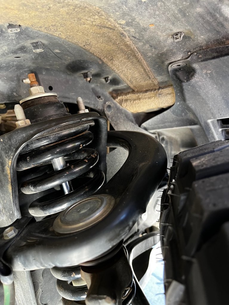

    2021 TRD OR
    Don’t think you meant me, but now that I got them mounted, no rubbing with 4Runner pro wheel offset, but super close to the stock UCA. See images above.
