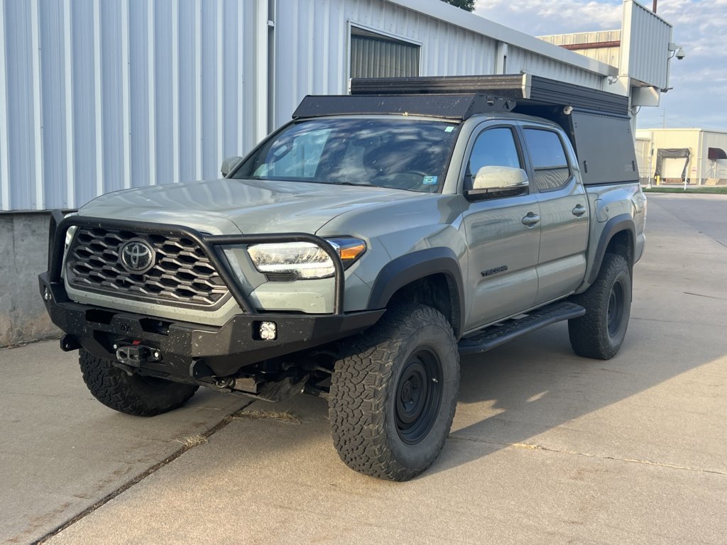

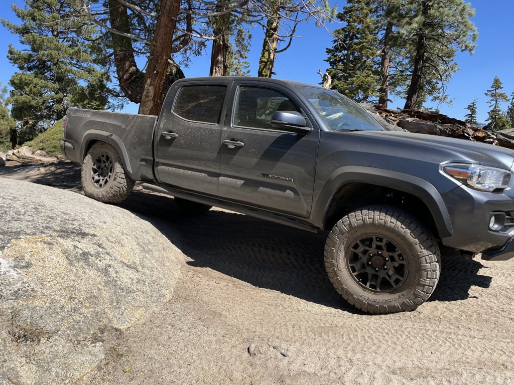

    Thanks! I pulled the trigger and just barely clears UCA with +4 offset.

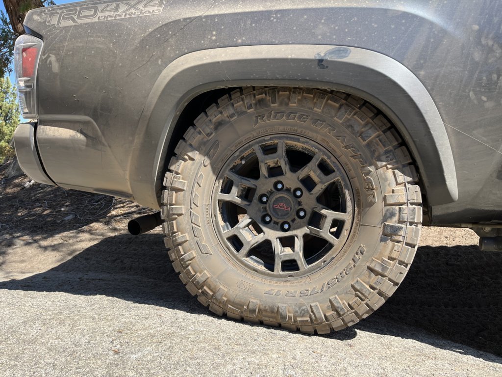

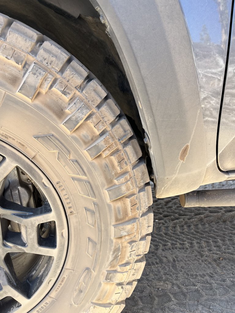

    Took it out on the trail and got some rubbing on the mudflap screws at a couple degrees of turn and bump. Took those out and it’s all good. The back tires stuffed get close but amazingly make no contact - or at least none that I could hear.

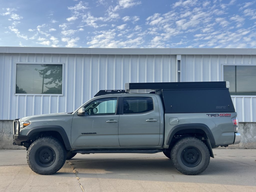

    Just ordered some 17x9 -25 SSW wheels, I currently have 285/70r17 ridge grapplers with a 17x9 -38 wheel. I have a cmc, lots of plastic trimming and I’m putting on some Dobinsons billet UCA’s (currently have SPC). Do we think I would rub with a 285/75r17 Wildpeak rt?

    Do you have a finger or two of room everywhere now? You should be fine, since the tire is less than an inch bigger and you’re bring the wheel back in.

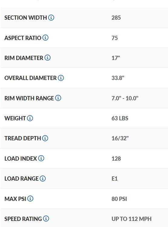

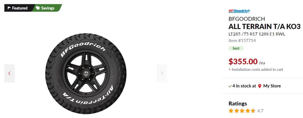

    Does anyone know if BFGoodrich plans to make the KO3 in this size?

    Yes

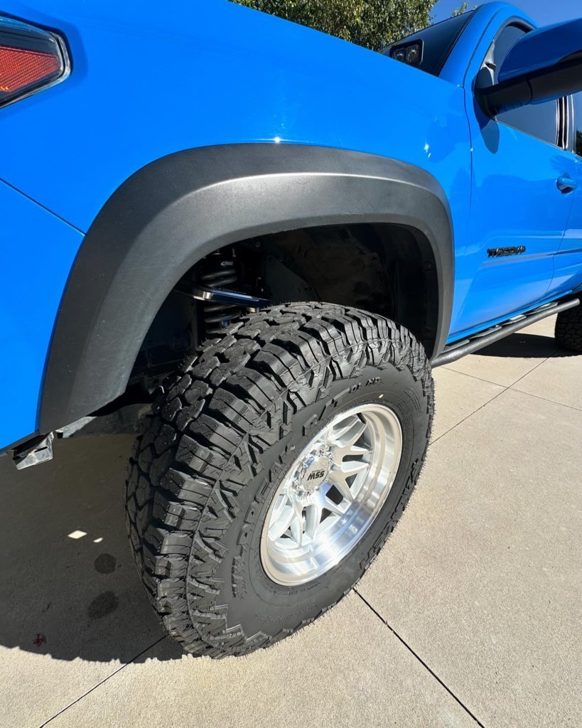

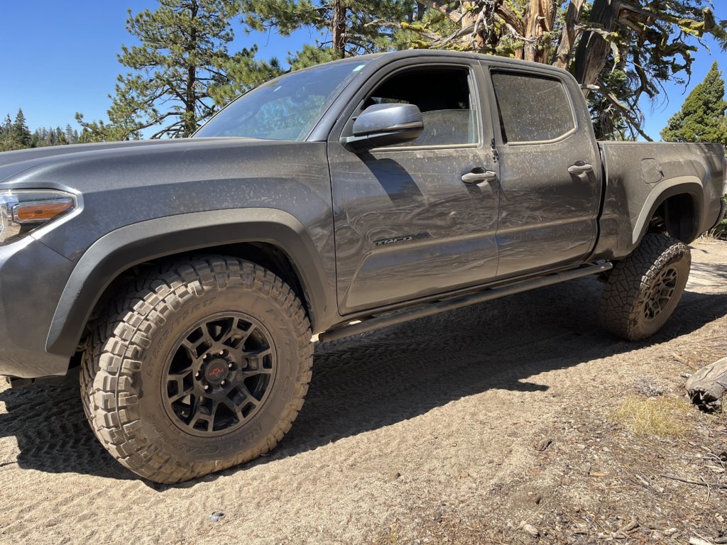

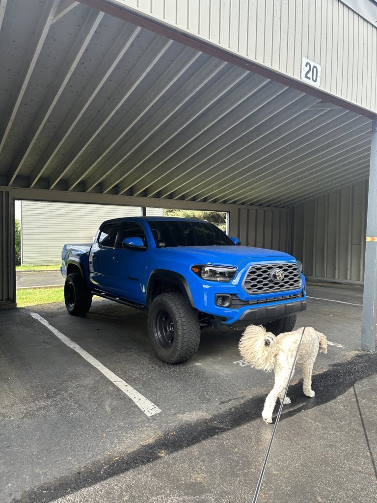

    New setup with 285/75r17 Falken R/T’s, SSW Sierras 17x9-25 with a 1 inch spacer, and new billet Dobinsons UCA’s. Rubs a little in reverse. Haven’t had a chance to take it offroad yet. I’m

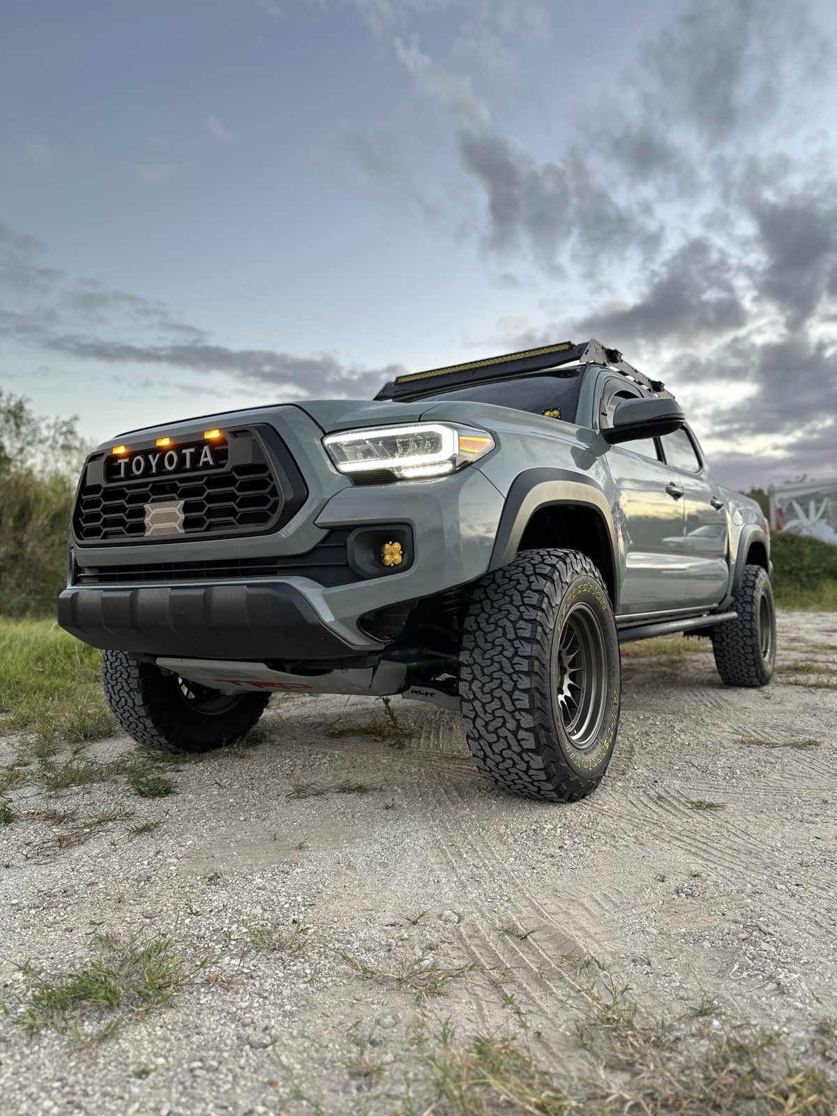

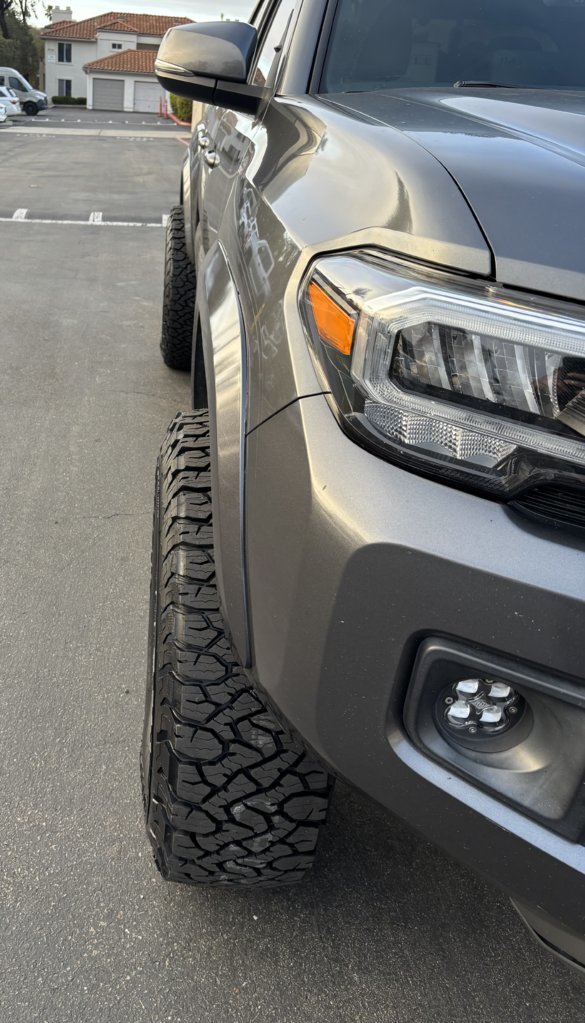

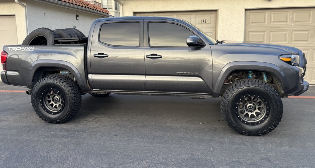

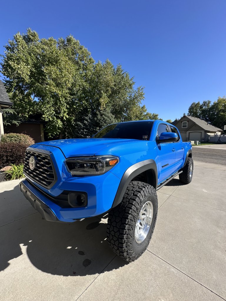

    285/75/17 KO3’s with 17x9 -38 Ray 10 wheels.

    Kicker speaker upgrade Rockford Sub TRD Grill Raptor Lights Oedro Running Boards Seat Covers Black Emblems MBRP Exhaust Sound dampened doors Blacked out turn signals Pro comp 7069 wheels BFG KO2 285/70/17 Ram mount Joying Head Unit Fogs Soft topper canopy Fox 2.5 RR DSC Fox 2.0 RR rear HS AAL 1.5" rear plus overload (2" total) Center console divider Axe/Shovel Mount Traction boards 32" light bar Shift sense pro v2 iDrive throttle controller Xentec 35W HIDs Vair 88p air compressor Dome LEDs LED reverse lights + pods JBA Upper Control Arms Full size spare tire Driver seat riser
    Looks fantastic. Are the KO3's offered in load range C in that size?

    Negative, only in E Load range.

    You got any more photos??? Or feedback on snow/ice performance?? I’m thinking about doing this exact same setup
    how do they measure out on the truck? You think you could have fit a 314/70r17?

    I only have a couple other photos on my camera roll. I’m in SoCal and rarely in the mountains so I likely won’t be driving on snow or ice anytime soon. I haven’t measured actual height but a 315 is definitely out of the question with this offset!

    Gotcha. Well I realized you’re on a -38. I’ve got a -10 which would help in the clearance department
