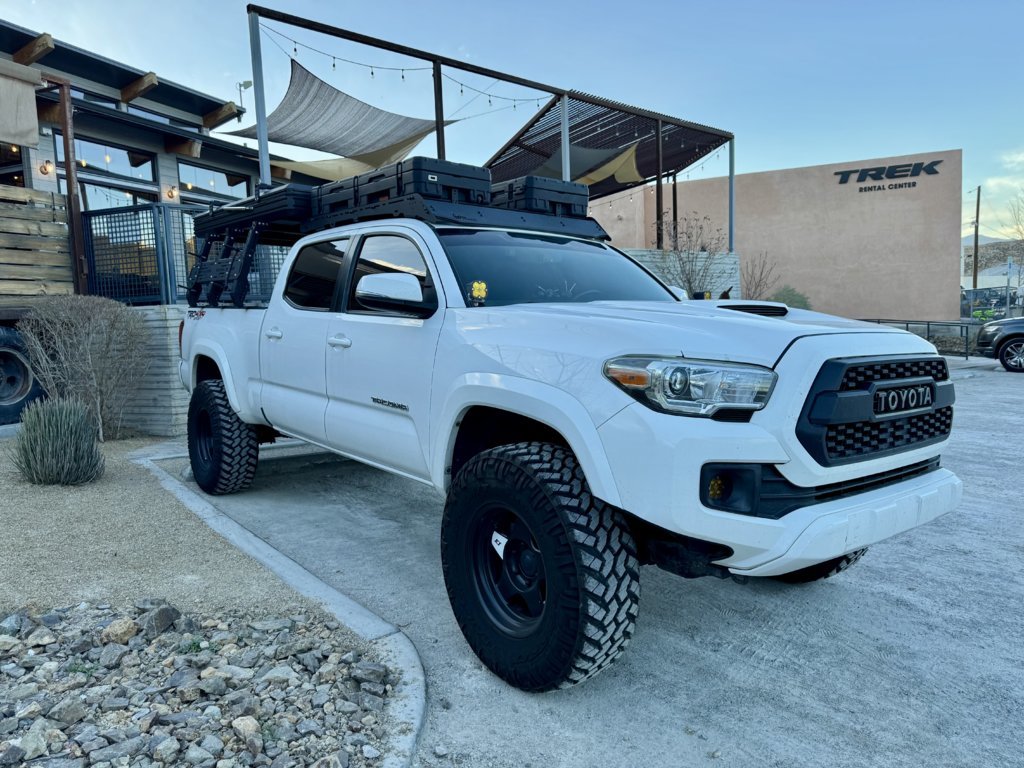

    2017 Black DCSB TRD Sport 4x4
    Fox 2.5 Performance Elite Deaver aal Camburg Tubular X-Joint UCA Falken Wildpeaks AT4W 275/75r17 RRW RR2-S Wheels - 17x8.5 0 Offset Muddy Offroad Rock Sliders CMC Pinch Weld mod Diamondback HD tonneau cover
    bump to get y'all to show off your 34's!

    Love the look , did you have to do CMC, and a lot of hammering underneath to fit 285/75/17 ?

    Are these a 34” skinny?

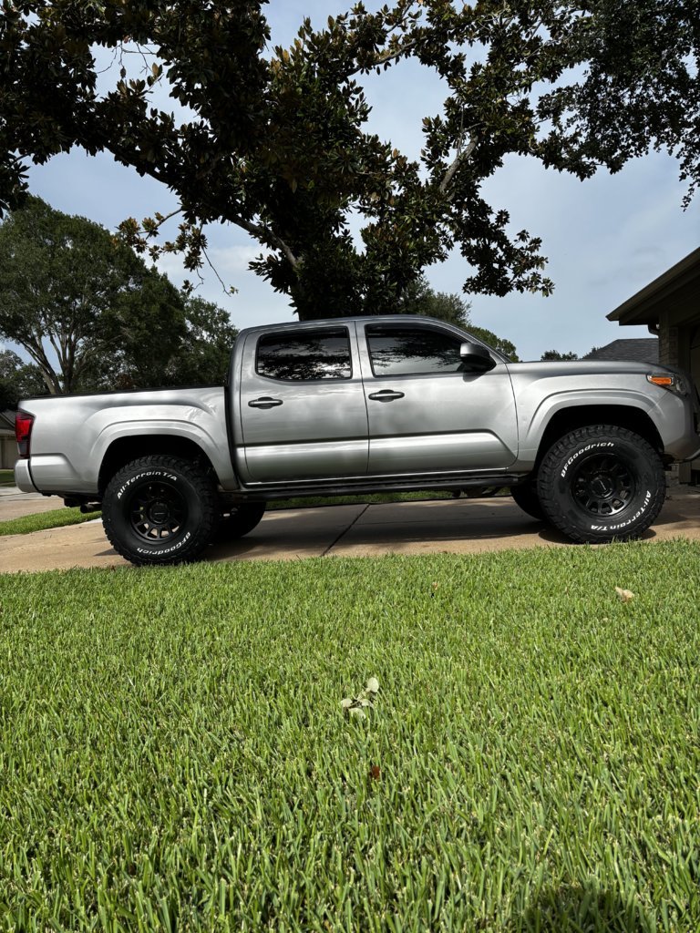

    21 SR 4x4

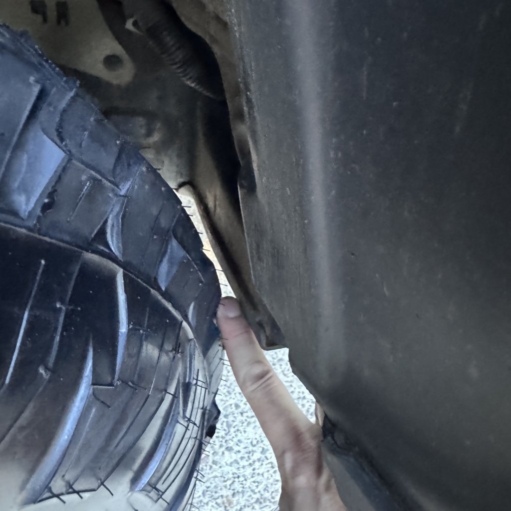

    285/75r17 KO3s on 17x8 0 offset Method 703s.
    On 5100s w/ OME 887 and 5160s w/ 2 inch wheeler AAL.
    Getting CMC and pinch welds done on Monday. Rubs pretty good on the front outer edge of the fenders liner. Massaged it back some with a heat gun but i think I’ll have to send up trimming it.

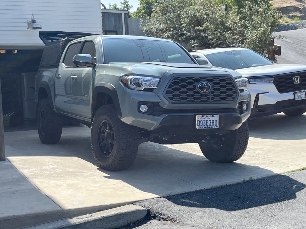

    2023 Tacoma MT
    285/75/R17s on Zero Offset wheels.

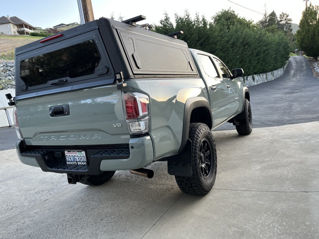

    2023 Tacoma MT
    Also, Spirit of 1876 makes a nice bed mount for a full size spare. I was impressed at how well it was designed and fits perfect even with the camper shell on.
    Allows for mounting of a 285/75/R17 in the bed.

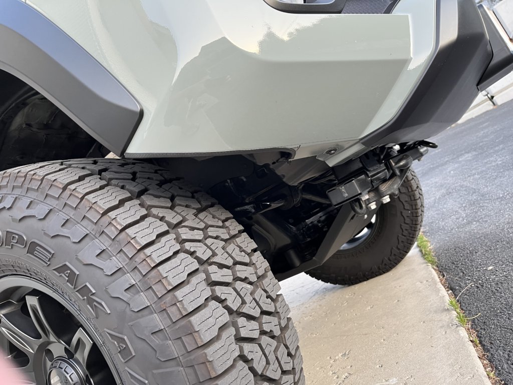

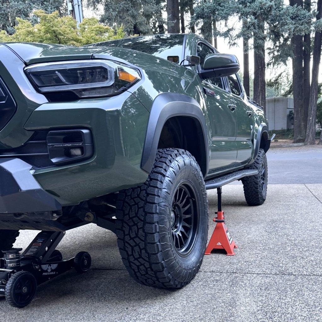

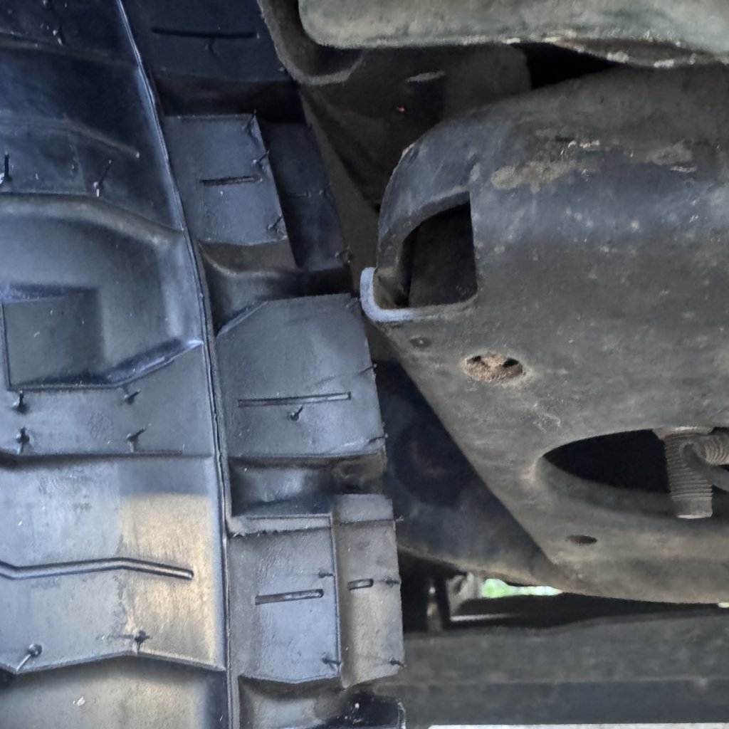

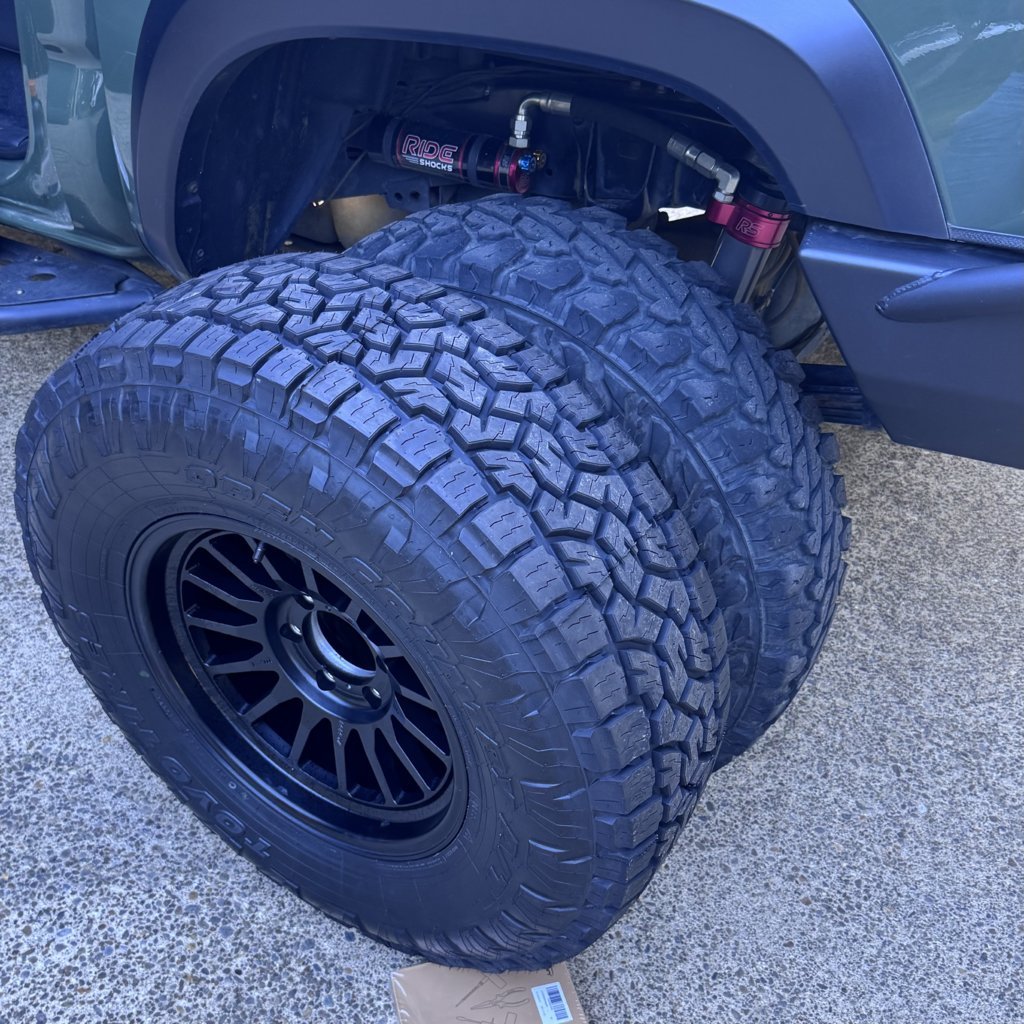

    Just had some 285/75r17 Toyo AT III mounted on new forged RR7-s Relations Race Wheels (17x8.5” 0 offset).
    Haven’t done a CMC yet. Here is what a 33.9” with 8.8” tread width looks with the stock lower control arms moved all the way forward (rear cams out and front cams in)
    It barely touches the cab mount at ride height, but will still require a CMC for when the suspension compresses.
    I saw a few posts in this thread asking about SPC clearance on 0 offset but didn’t ever see a clear answer. My SPCs are set at position D. With the wheel straight there is no issue. With the wheel fully turned it also clears at ride height with about 1/2” of clearance. It would be closer for some of the other brands in this size where the tread pattern is 9.1” vs 8.8”.
    The issue is at full droop. The tire rubs the arm when fully turned, but this scenario would really only happen if you were off-road and lifting a tire off the ground. A tubular UCA would clear no problem.
    Visually this is a great size for these trucks, especially when lifted. The rear tire in this pic is 255/85r16. Can’t wait to get all 4 on.

    255
    That looks so good!! I'm waiting for a restock of the SCS wheels I want, then I'll order my geolander m/t tires in a 285/75 /17. My 285 70 17 look tiny

    255
    Those are the wheels I want!! SCS is out of stock of the polished 17 inch with a - 38 offset. Your truck looks fantastic

    I wouldn’t really consider these “skinny”, that would be closer to a 255/80/17 size in my opinion.
