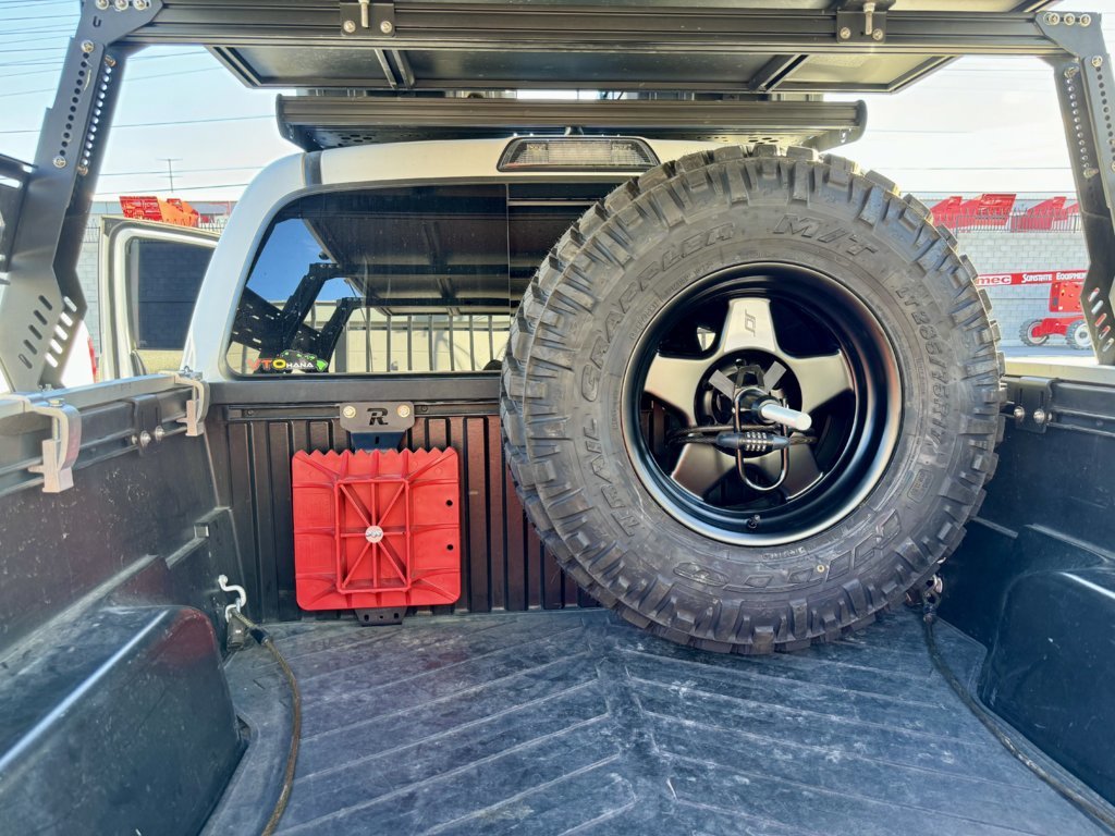

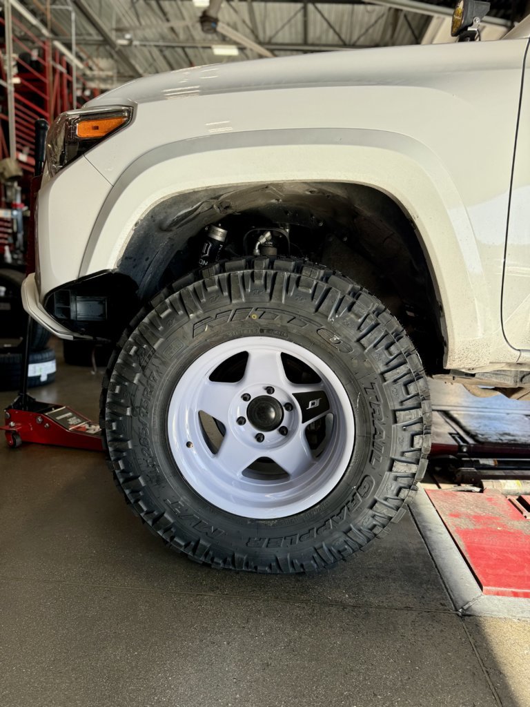

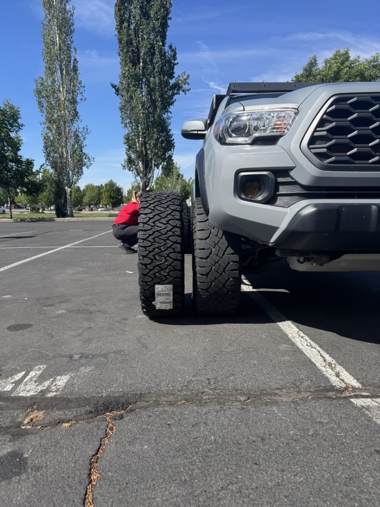

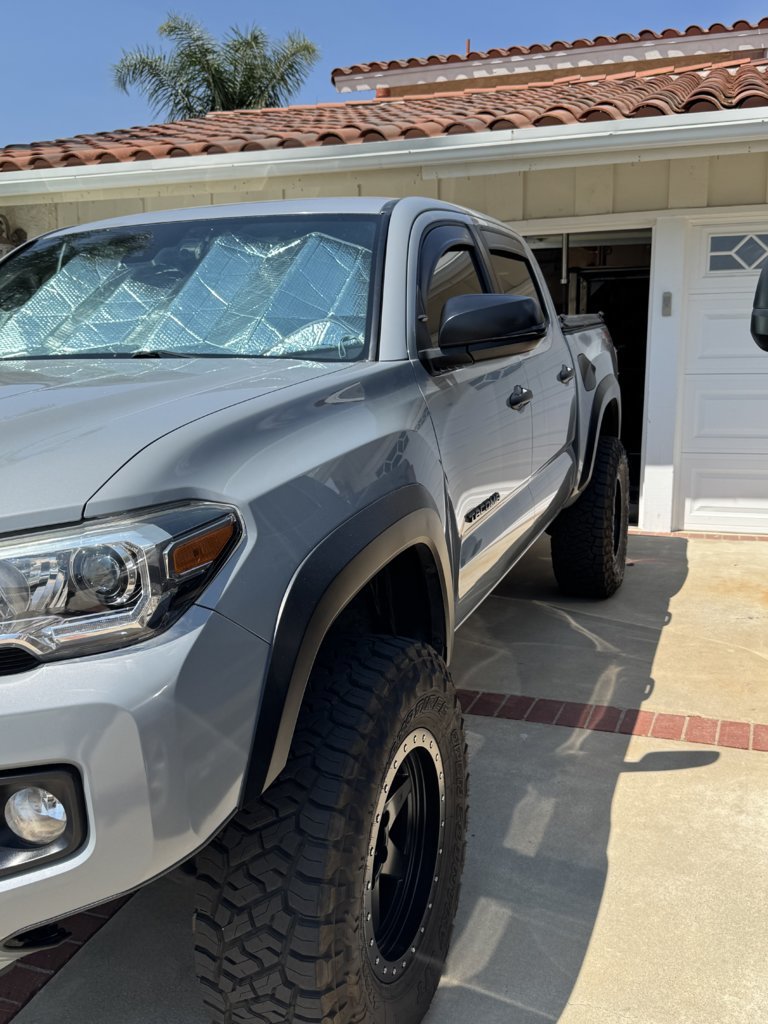

    Thank you! I originally purchased these in a -38 and couldn’t get the fronts to fit without rubbing, and that was even after doing a CMC, fender trim, and alignment, so I settled for the -10 with no issues at all.
    The light gray color was my first choice, but then went with black on the second set.
    Here’s the matching spare in the bed for size reference.

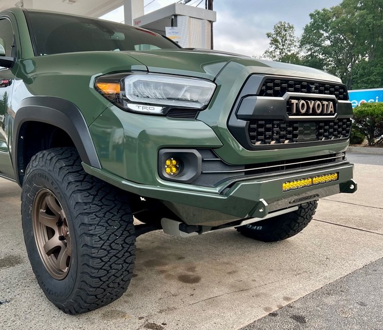

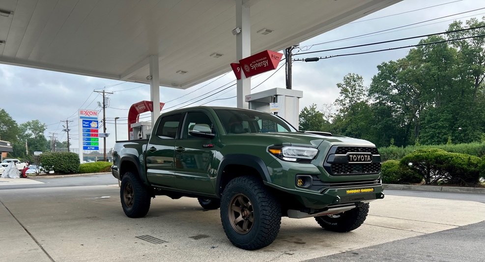

    Here's an update on the 285/75/17 BFG K03 with the Rays 57DR-X wheels

    You got any more photos you can post? I’m on the fence between a 295/70r17 and a 285/75r17

    Great looking front bumper. Don’t see many color matched ones.

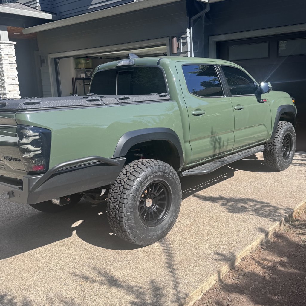

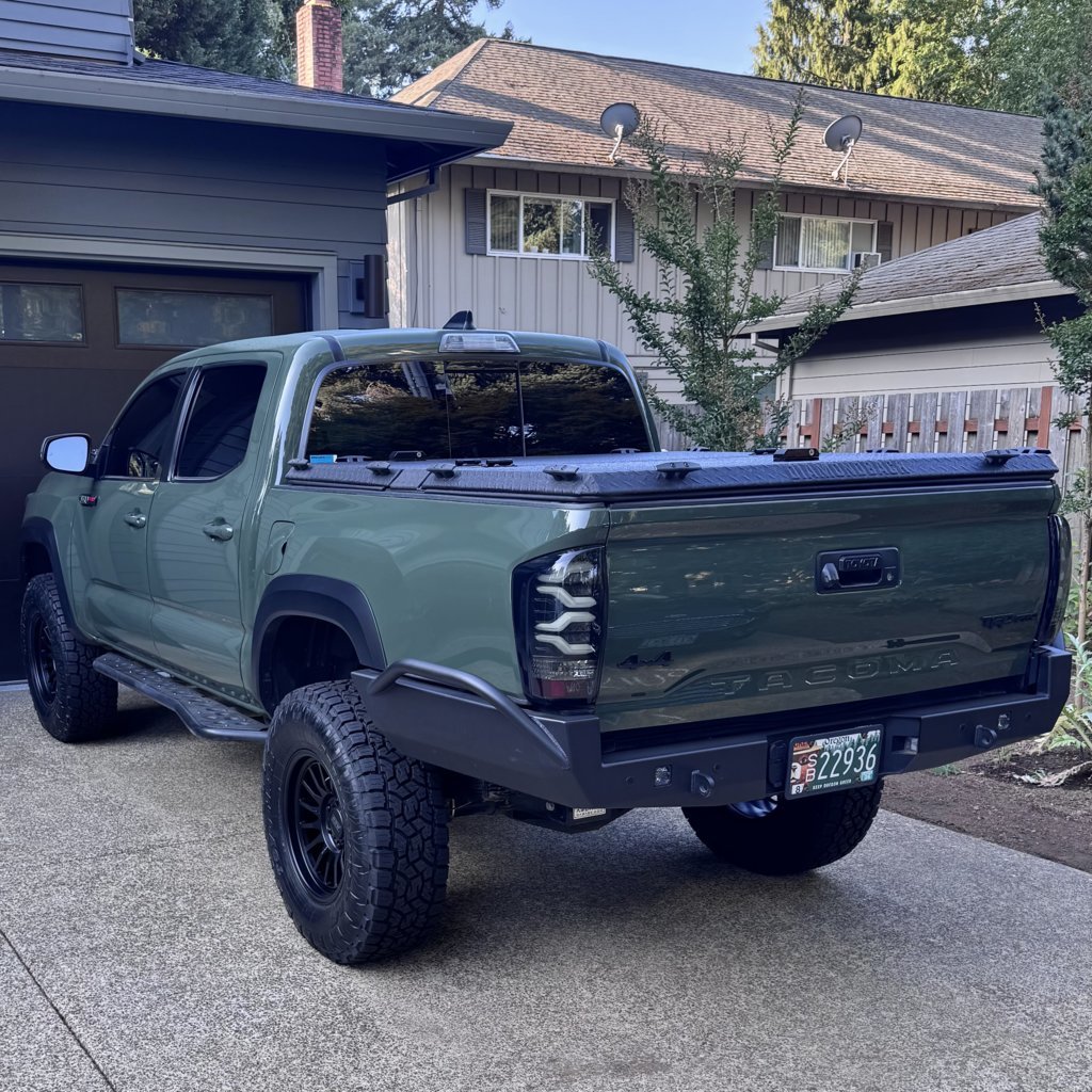

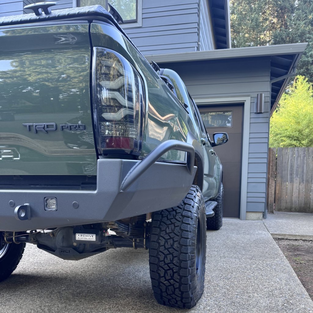

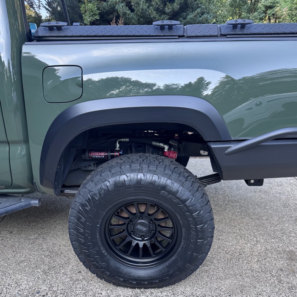

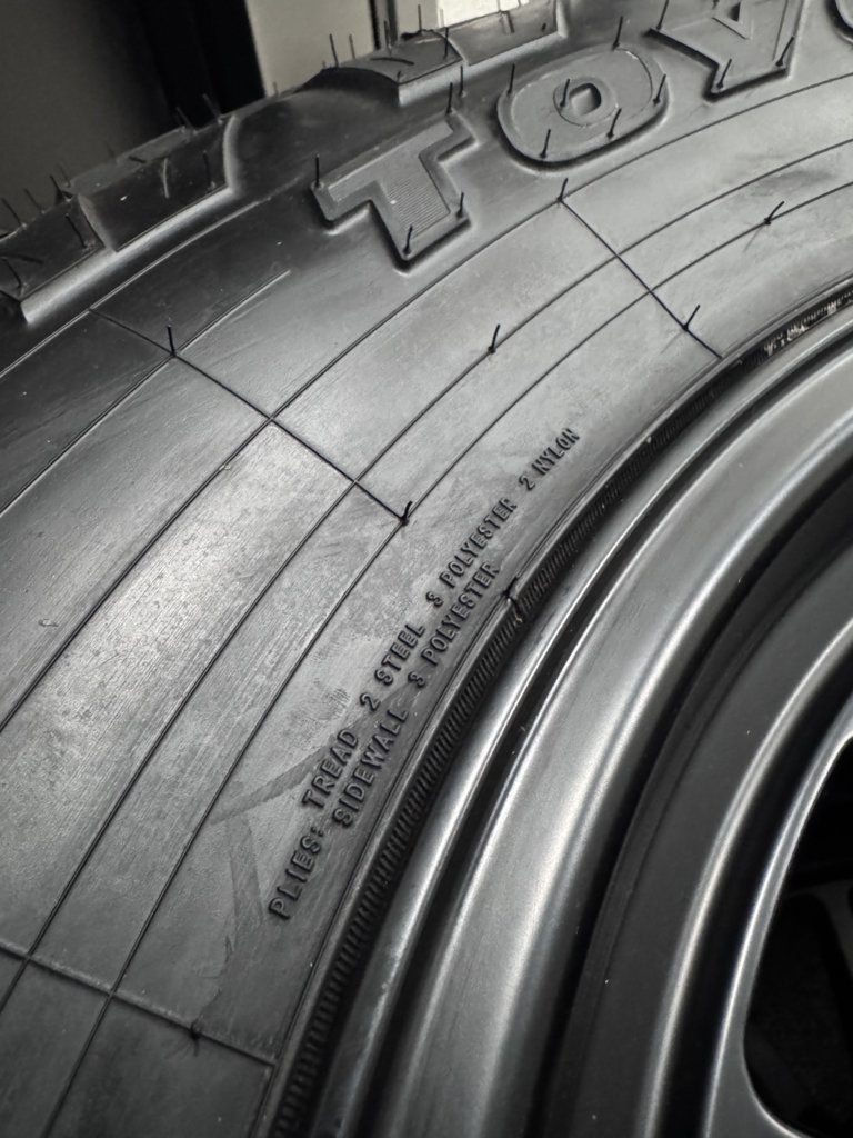

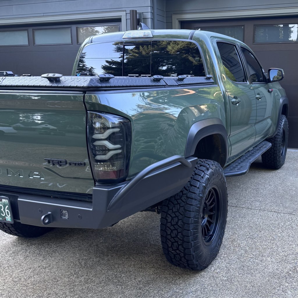

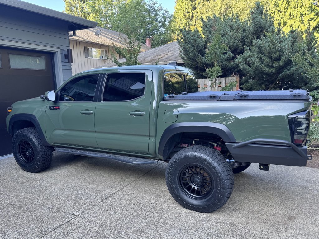

    RIDE Shocks 285/75r17

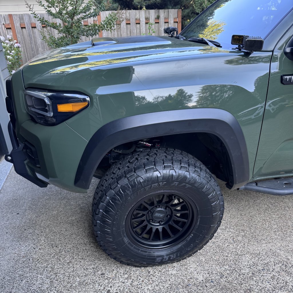

    Cab mount chop was completed this past weekend, and I just installed the 285/75r17. Mounted on 0 offset forged Relations Race Wheels.
    Went with Toyo ATIII since they are the lightest weight C load option in this size. They are 59 pounds and still have a 3 ply side wall.

    does your bumper still have the sensors in it for The parking in blind spots?

    No blind spot monitoring. This Bay Area Metal Fab bumper did come with 4 holes for the 4 parking sensors, and those all still work great.

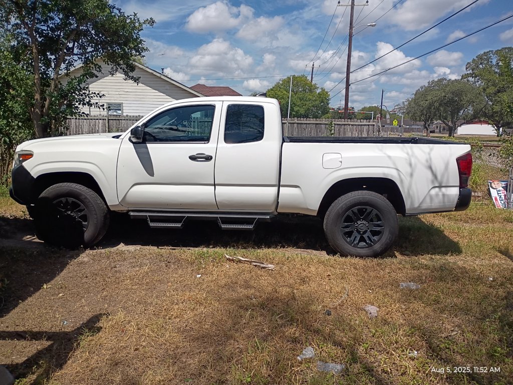

    Nice!
    My 2019 Taco SR, 4x4 came with Landsail 265/70 R17 tires. Dealership swapped out the stock steel rims for the Black OEM Toyota rims. Looks nice on my rig.IMG_20250805_115256702_HDR.jpg

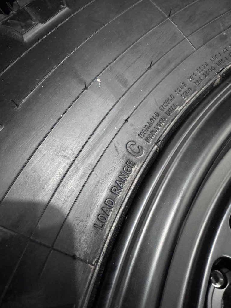

    I actually just ordered up some 34” falkens. We’ll see how they go! I got a C load, not an E..

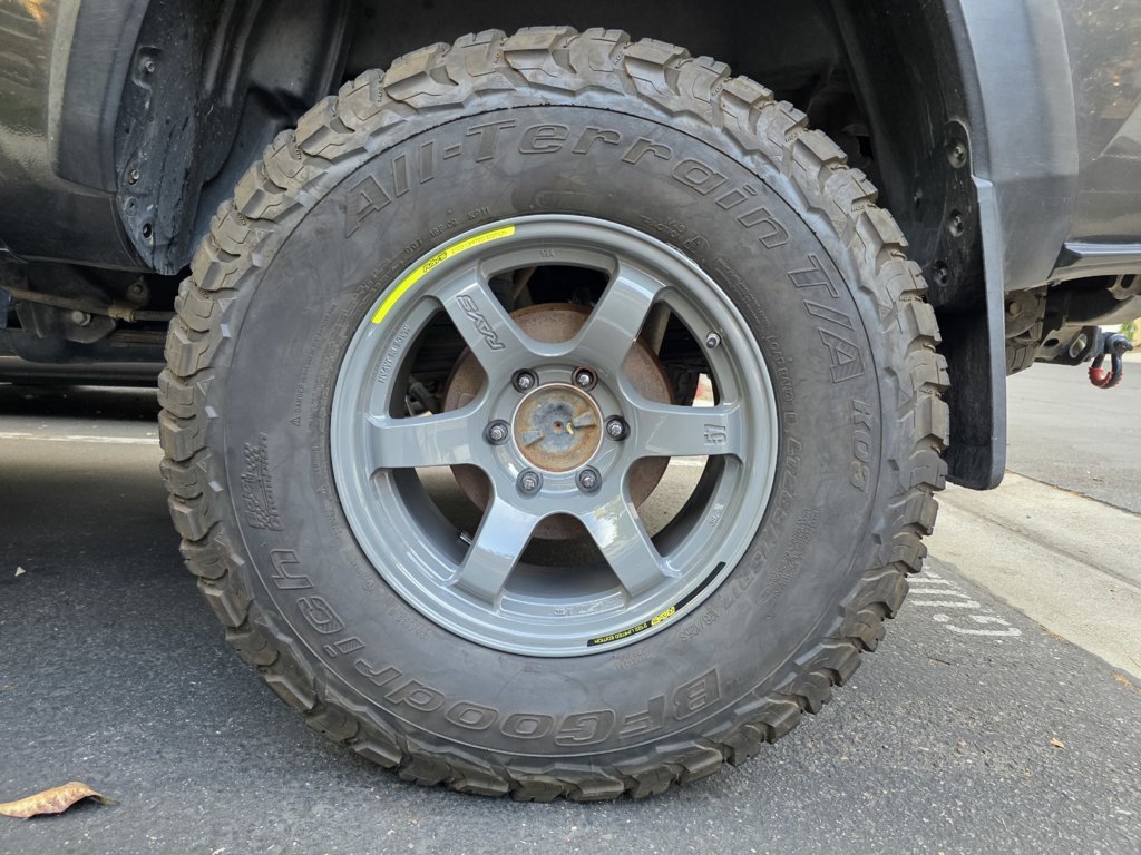

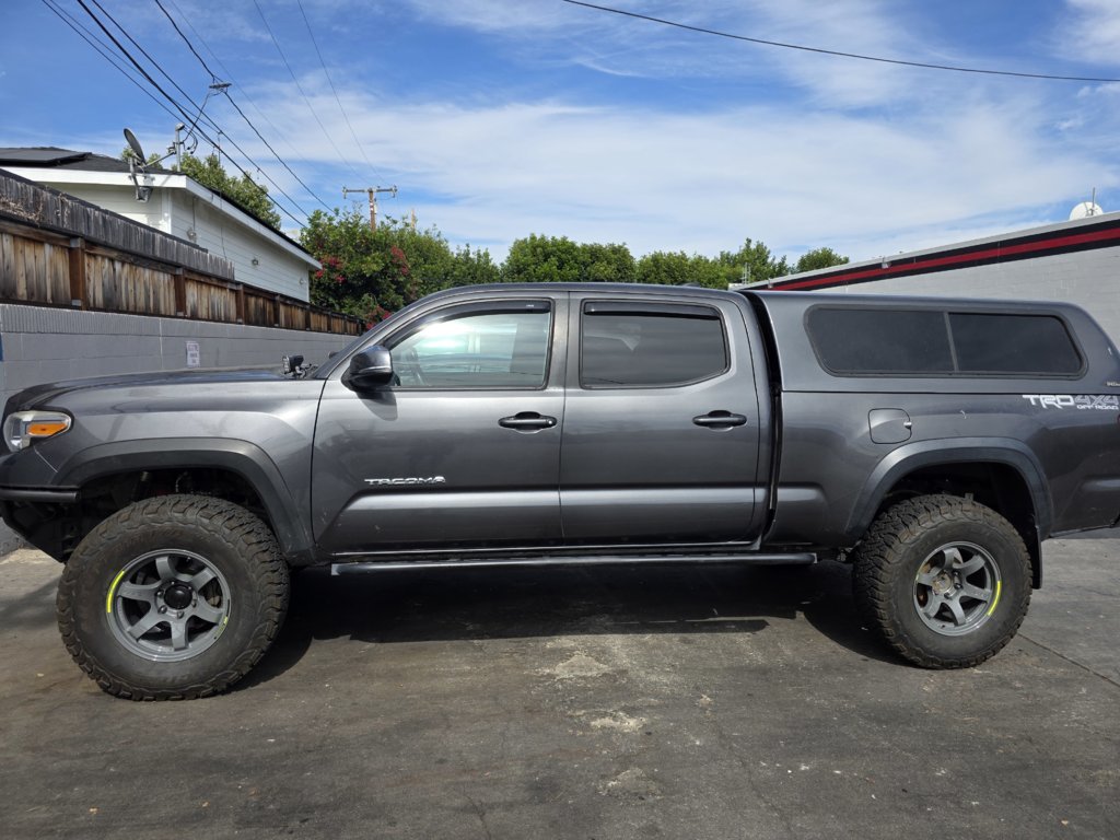

    Running 285/75r17 BFG KO3s on Rays 57DR-X 17x8.5 0 (had to get a spacer for the fronts to get to -10 and also make it hub centric)

    Yes, I'll get some more soon. No CMC, I was only rubbing slightly on the fender liner in front of the wheel before the bumper went on. That issue is gone now. I have OEM UCA, 17x8.5 0ET Rays 57DR-X wheels & 285/75/17 BFG K03. TRD Pro Fox suspension - Eibach pro lift front springs - Icon AAL S2 rear.
    Thanks! Painted flares next to finish it off. I haven't seen any painted either and wanted a more OEM + look.
