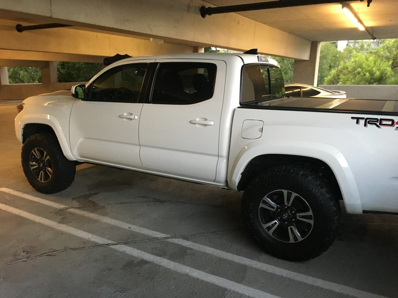

    I have a 3rd Gen Tacoma TRD Sport 4x4 with Bilstein 5100's at 3rd clip up front. Spidertrax 1.25 spacer and Milestar Patagonia 285/70/17. I removed the mud flaps and no rubbing at full lock on either side. I have a video of it on Youtube.

    Quick pic of the truck/tires. Will get more later today
