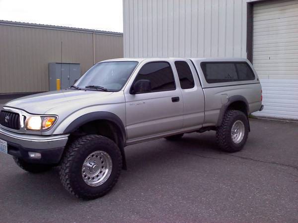

    Ah ok, I didnt want to hack anything off of my truck just to clear the tires. They are 265 toyo m/t they are pretty agressive and have really thick tread.

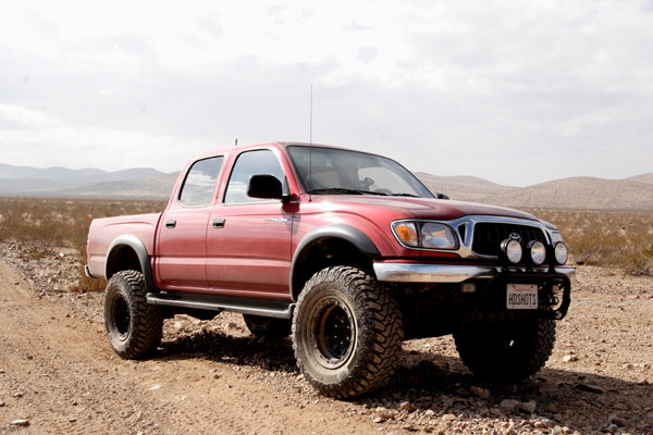

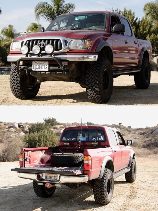

    before long travel, i was on coilovers cranked up 3" with 285-75-16s on 16x8s with 4" backspace... i had the casters set at 1.7degrees forward and they cleared both aired up and aired down...
