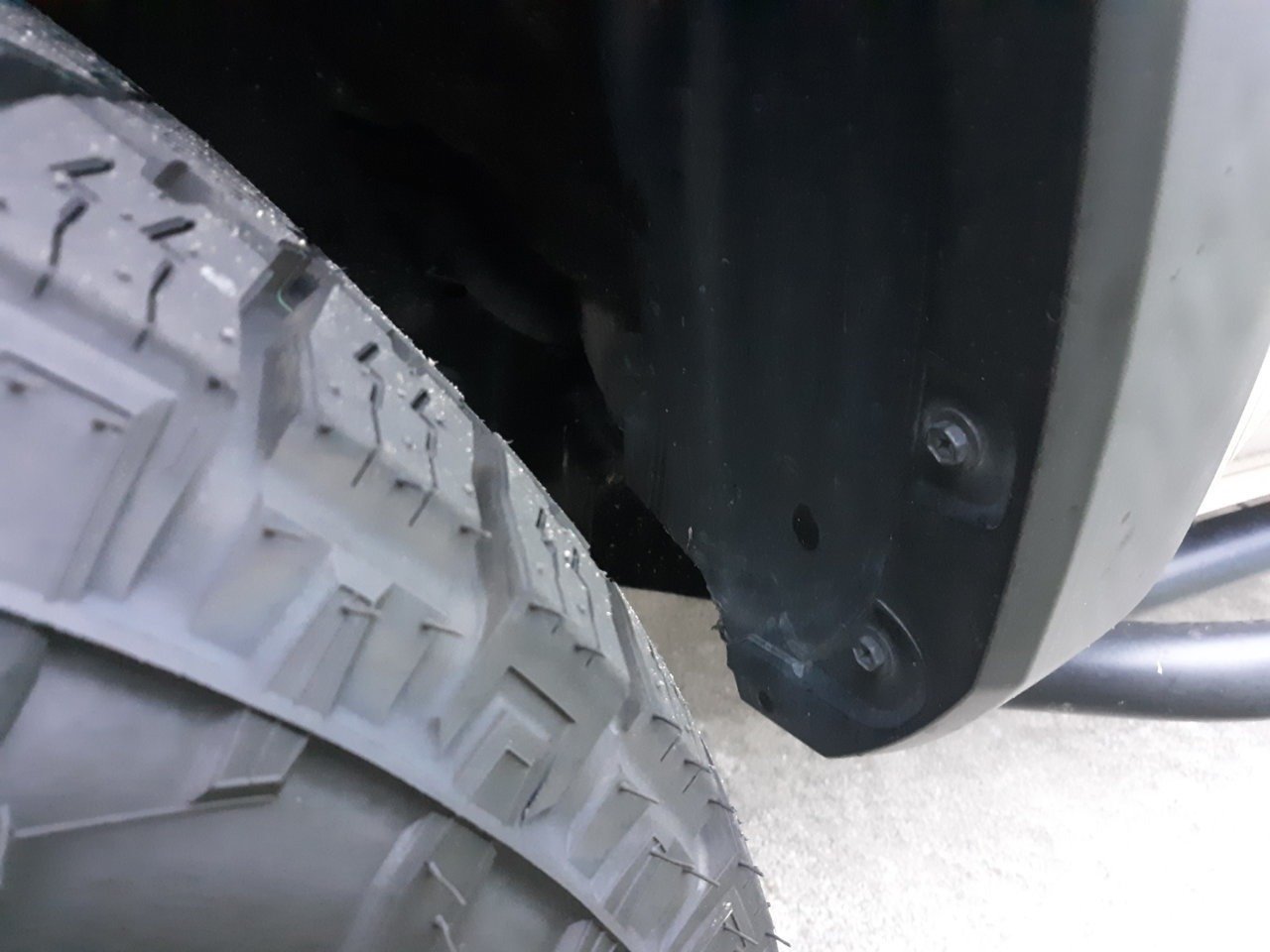

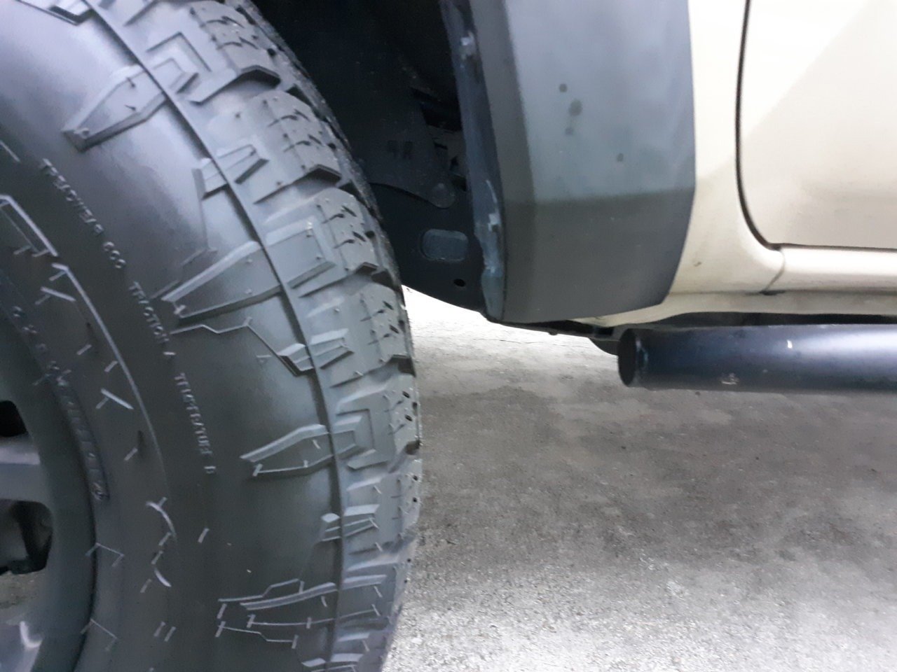

    Here's my clearance with wheels straight and turned showing closest angle to rub without compression and I have a CMC.
    I still need to touch up the inner fenderwell. Wheels are the 4runner Pro wheels and I have a 2 inch lift in front with SPC UCAs to help with alignment and I still rub occasionally backing out of the driveway at an angle.

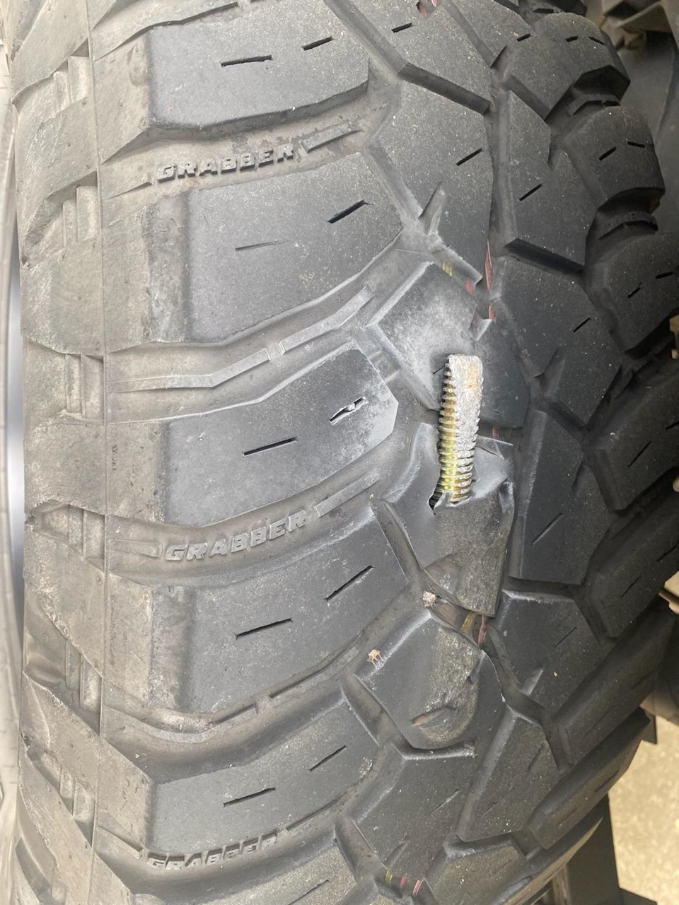

    Apparently x3's are pretty puncture resistant too .pulled this out yesterday. It just skipped off the radial .
