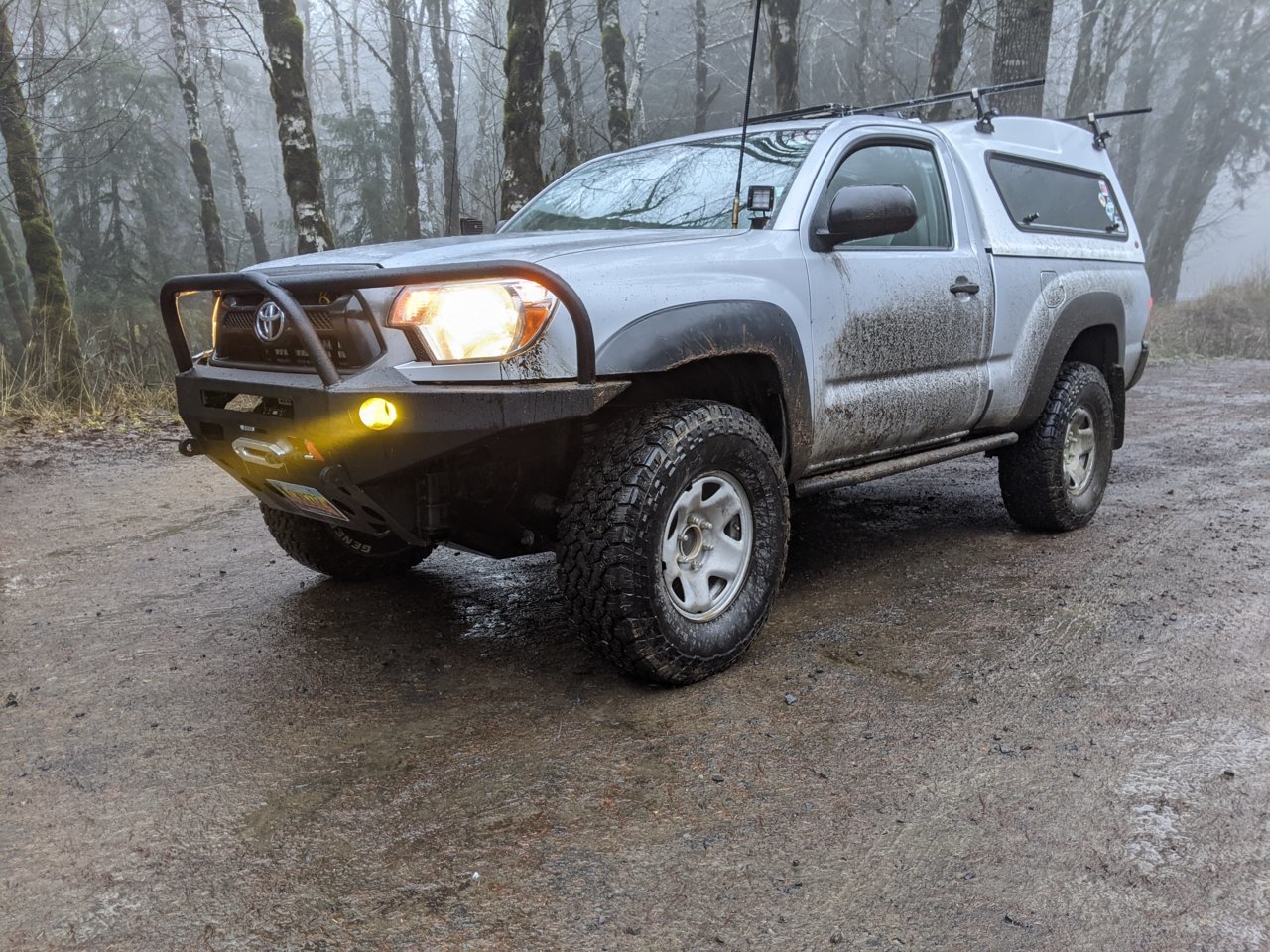

    I have 285's on stock steelies. I believe most (all?) stock wheels have +30mm offset. The 285's will interfere with the uca, not really a way around this. I have 1" wheel spacers to combat this. I have yet to find an instance of a wheel spacer failing. The issues and reasons they get a bad rap is because of these bad boys:
    DONT run a spacer like this. A good hub centric wheel spacer with properly torqued nuts and loctite will give you what you want.

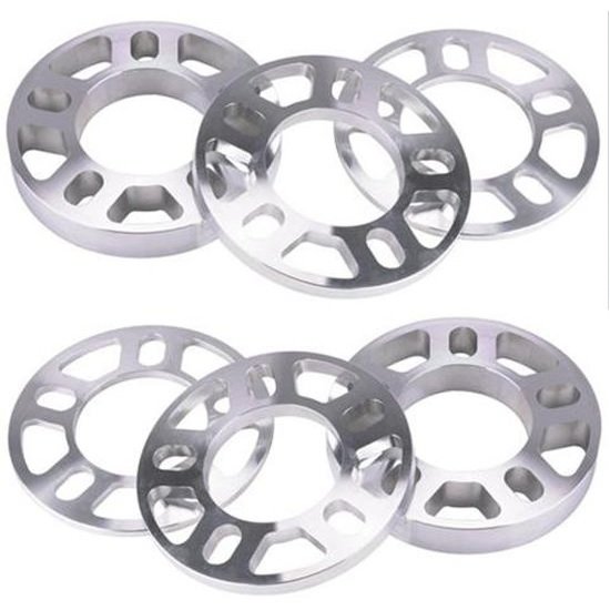

    My suspension setup is stock. I have 285/75/R16 Duratracs on the stock wheels and went with 1.25in spacers all around (not necessary on the rear) to clear my UCA. I also did a CMC, plastic trimming, and massage of the pinch weld to get it to cycle off road with no issues but it's possible. Let me find a pic

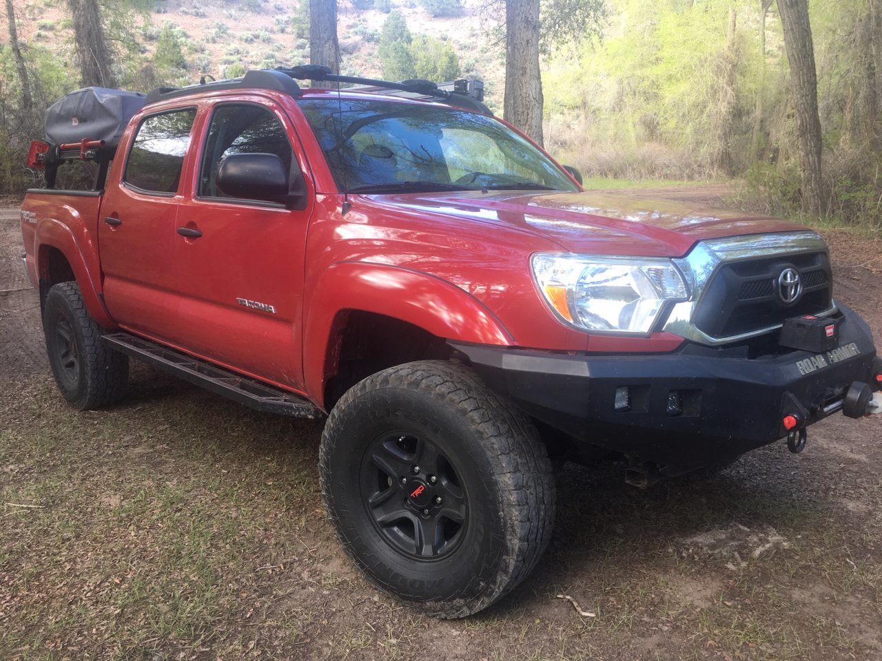

    That's what it's all about man. Enjoy your truck and build it how and when you can. I will say that the added 1" both in hight and width with the 285s is a lot more significant than expected (at least in my case). But you also will be paying for that in the initial purchase and then lost mpg. When I first bought new tires for my truck I went 235/85r16 and loved them. Next time I upped the ante and went 285's. In a lot of ways I miss the little skinnies.
    And here is my truck :)
    I have photos with the 235's if you'd like to see that too.

    A 1.25in spacer will center a +30mm offset to 0mm IIRC. I know some aren't fans of them but if you use a decent one (Bora/Spidertrax) and torque and Loctite them properly they should be fine (I haven't heard of folks running into issues).

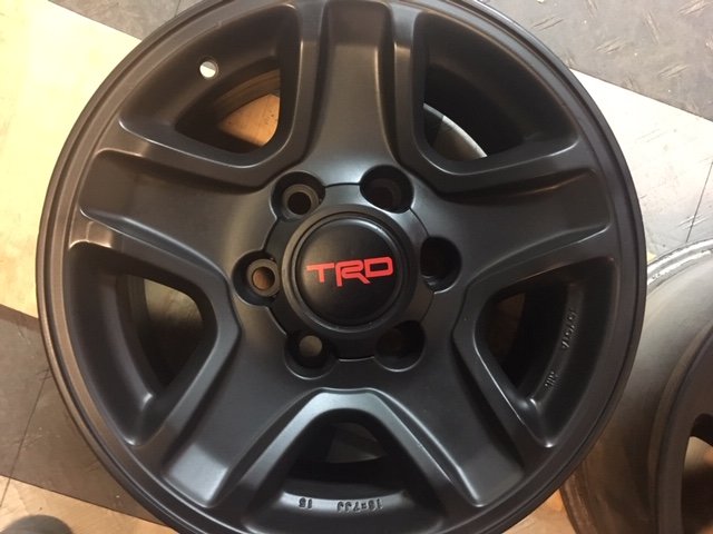

    One popular option are the wheels of the 4runner's of about 2000 vintage. I picked mine up for $25 apiece and then Cerakoted them. They give the perfect offset for 285's with no rubbing on my SPC upper control arms and come just to the edge of the wheel well without sticking out. I have a set of 255/85/16 studded snow tires that I run in the winter and they look pretty wimpy in comparison and are about an inch shorter and 2 inches narrower. Chances are I'll never run anything but the 285's, they seem like the perfect size to me.
