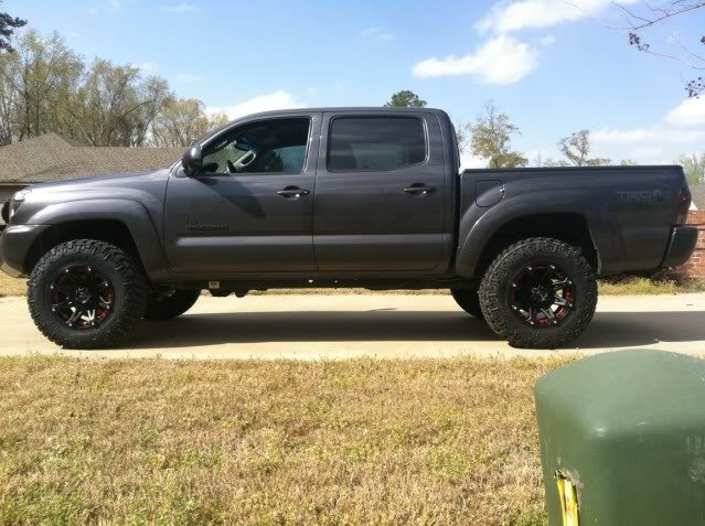

    It's more the wheel offset than the tire width that will give you a wide stance. You need to go with a 4.5 backspace wheel (9 inch wide -12 offset for example).
    The tires on my truck are skinnier than stock (255/75/17) but the 4.5 backspace gives it an aggressive stance.

    A 265/75/16 tire will look similar to my truck on that wheel. You would stick out maybe 1/2" less and your tires would be a little less than 1/2" less in diameter. With the 265s you won't have any rubbing issues and you shouldn't loose too much mileage (unless you are going with a much heavier tire)
    Depending on your lift height you will have a little more room in the fenders, I'm only running 1.75 inches of lift. Check out this thread to see some pics of 265s with 3" of lift.
