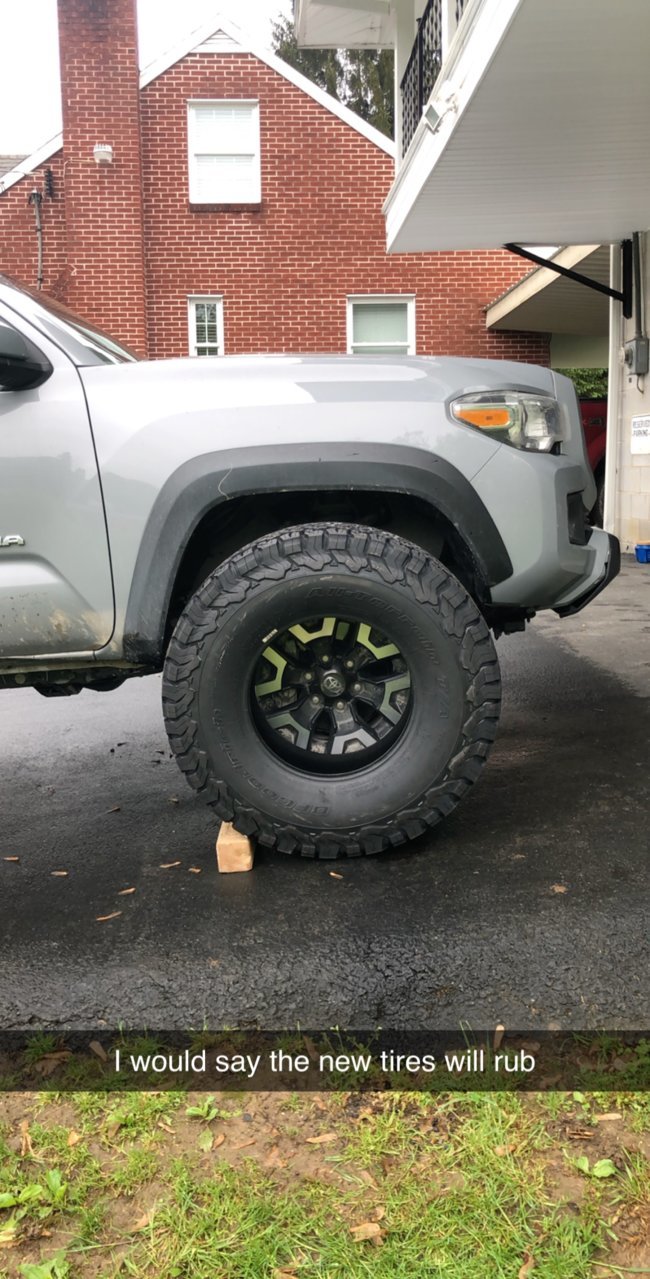

    Well I had a tire blow out earlier this week so I ordered some tires! I planned on getting a lift but after seeing a few posts with 285s on stock trucks I had to try it myself. It looks like it should only rub the UCA at full lock with some uptravel, but I’ll find out next week when I get them mounted up with the new wheels. I’ll post pics of the truck and I’ll try to show how close and where it rubs when they’re on. Also wheel and tire setup are 285/75/16 Ko2’s and Konig Countersteer Type X from FN Wheels. Hoping I don’t have to massage the fenders too much!

    They wont rub the UCAs with the type X. UCAs and the wheel essentially remain constantly distant from each other if it doesn't touch when parked it never will. Unless you get a wider wheel with low offset, like 17x9 with a positive offset, the tire will never touch unless you find a way to flex the top of the tire. I can say with confidence, since you're getting a 16x8 type x, your're moving the wheel almost an inch outward from stock. Scrub radius will increase, you will have rub at the cab side of the fender.
    Aside from body lifts, the wheel and tire still make the same up/down stroke travel with lifts, unless you have long travel. With just about any lift normally seen here you can and will have the same rub lifted or not if you compress the suspension because it will still travel upwards to the same amount as stock. Basically rub will most likely happen lifted or not if no cutting or work is done. The variables are the wheels and tires you choose. BFGs run small so you have an advantage there.
    If you want to decrease the occurrence of rubbing, stock wheels will work better for you. I don't exactly remember the stock OR offset and size, but people have run 285s on the SEMA style 17s without UCA contact.
    Good luck.

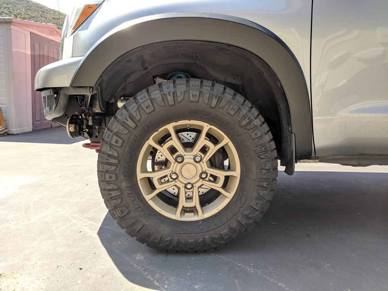

    2017 trd pro
    Cab mount chop . and the pinch weld is at the rear of the wheel arch behind the fender liner . Picture just before welding on the CMC plate .

    UPDATE:
    They fit... kinda. luckily I didn’t work today so I could go to the shop and watch them get mounted. The owner was nice enough to lend me a heat gun and grinder so I could make it home. Might do CMC and some more trimming on Sunday. I’m pretty set on not doing a lift but I think I’ll at least level it.
