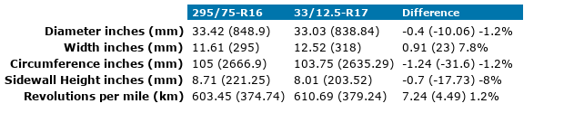

    Tried searching, but couldn't find the answer I was looking for. Sorry if this has been covered. What is the difference between 33" tires and 285 tires? From what I read, they are both 33" tires more or less. If that's the case, why the different numbers? Does one get better gas mileage than the other? Why are 33" cheaper than 285s? Thanks! Still a newbie and learning :confused:

    Thanks for the info! If I'm reading the chart correctly, the 33's are slightly bigger. Would the slight increase in size result in less mpg? Or is the difference so small that it wouldn't change the mpg between 285's and 33's?

    It would be very small but yes a 33/11.5/16 will get less Mpg's but if your worried about mpg's don't even lift your truck just stick with the 265/70/16's

    You don't want studding. Studded tires are for ice in the winter. Unless they are dedicated winter tires,no studding (its illegal in most places in the summer).
    285 is the width of the tire by the way, its the other number that tells you how big around it is going to be. 285/75 means sidewall is 75 percent height of the width of the tire. So double that, convert to inches, and add your rim size to get the diameter of the tire.
    Kind of annoying, but 285s aren't all 33s. There are 285/65 285/70 and 285/75. All pretty different tire sizes.
