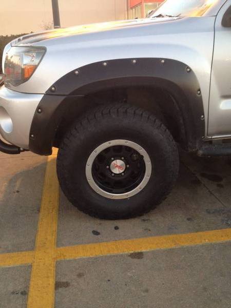

    I had 265s on my truck with 1.75 lift in the front and they looked small to me so I rolled the dice and ordered some nitto terra grapplers size 285/75/16 and hoped they would fit. Well I figured I would rub a lot and have some issues but I was surprised when they only rubbed my right front fender when I turned right all the way. I love the look and they ride way better than my old MTs. I know that if I offroaded that I might have some problems with them but for my use which Is 90 percent street driving I have no rubbing with a little trimming. I have the trd fake beadlocks which have the perfect offset for the 285s I have about an inch of clearance between the tires and UCA and no rubbing now on the street with a little trimming. So I just posted to say it can be done if you want the looks and aren't serious about off roading.

    Power loss isn't bad I can tell a little but it's a truck so I don't really care as far as mpg I haven't had it long enough to know yet I'll have more info soon. I think the offset is what makes mine work

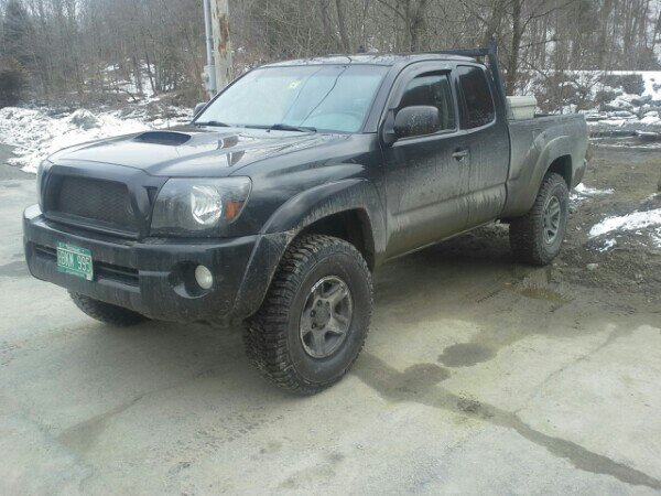

    I have Treadwright guard dogs on my truck at the same setting I believe.

    Here is a picture of them. They fo rub some.

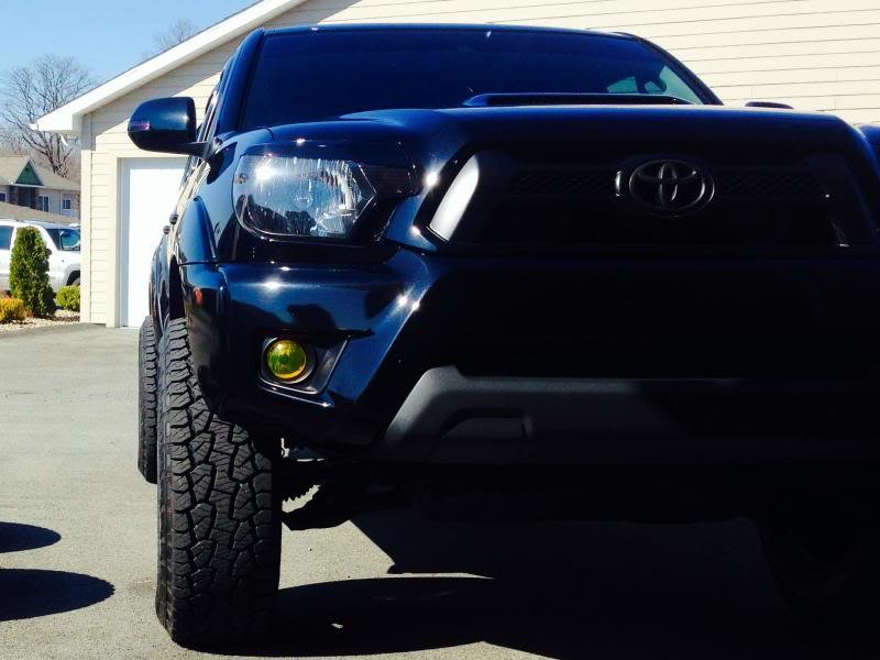

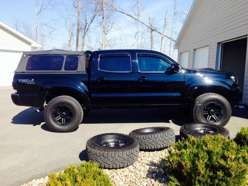

    im now running 285/70r17 hankook dynapro at's on tuff at wheels (de-bro'd). 5100's set at 1.75 and 1/4in lean spacer on the drivers side. already had my mudflaps removed. no rubbing.
