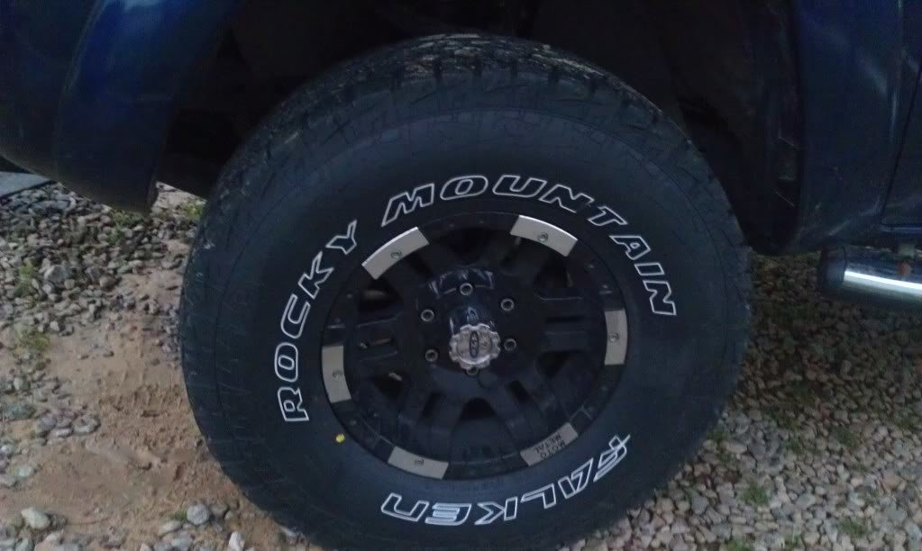

    Here is the tire I will be putting on in the morning at discounttire store in Alcoa.
    They have refereed me to another tire shop that will do my alignment at a good price. so hopefully I will not have to do the chop on the cab.

    I went with the tires above. 285/75/16 so far no issues. I went ahead and trimmed a little plastic yesterday

    Not bad. I have those tires with a 3" lift. Rubs on full turn but thats about it
