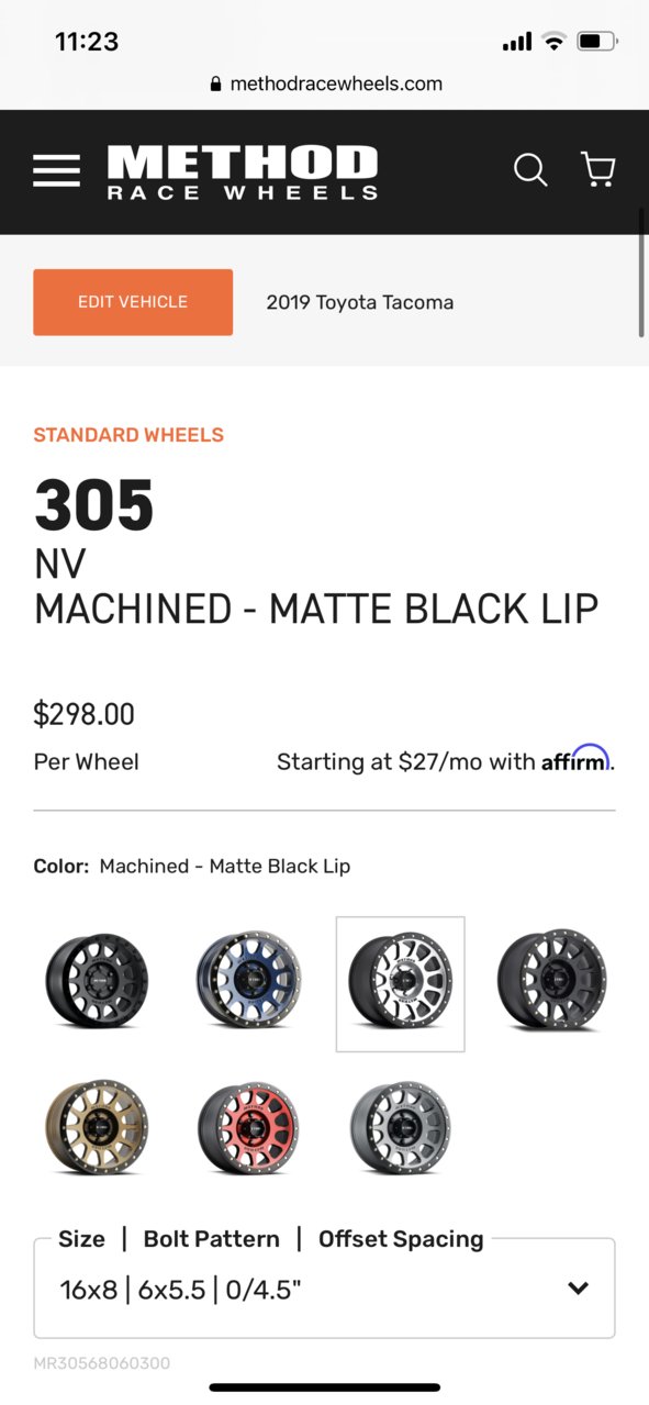

    I have the nv 305s 16" love em

    Here's my 305s still on stock tires
    banditcamp and 1776Taco[OP] like this.

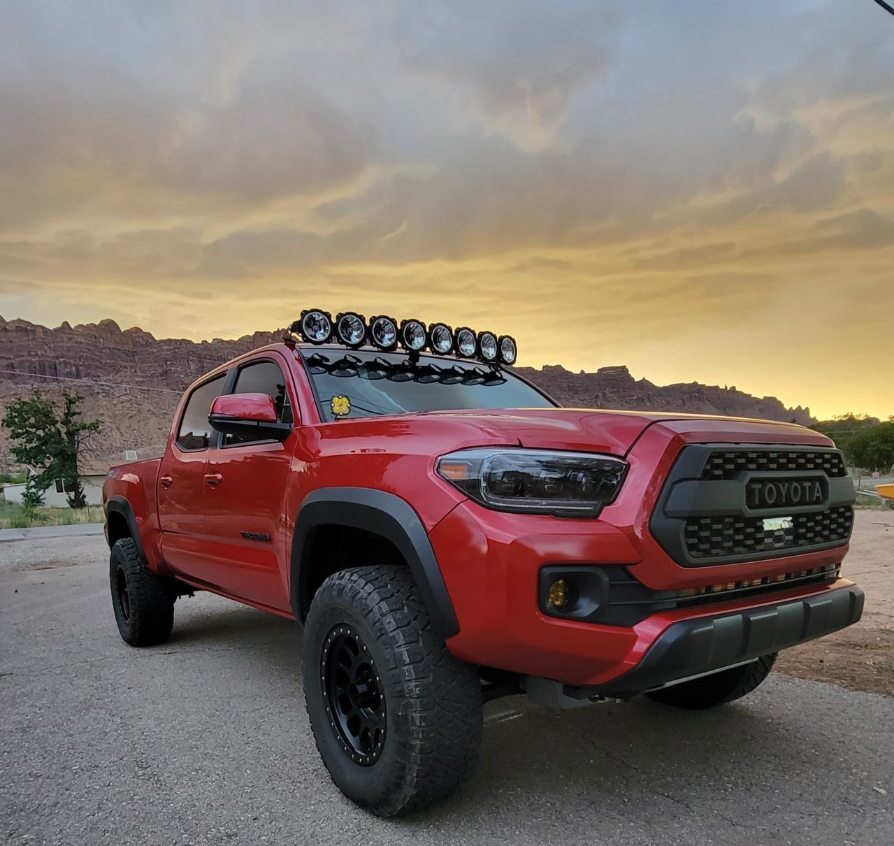

    Methods with zero offset
    285/70 17

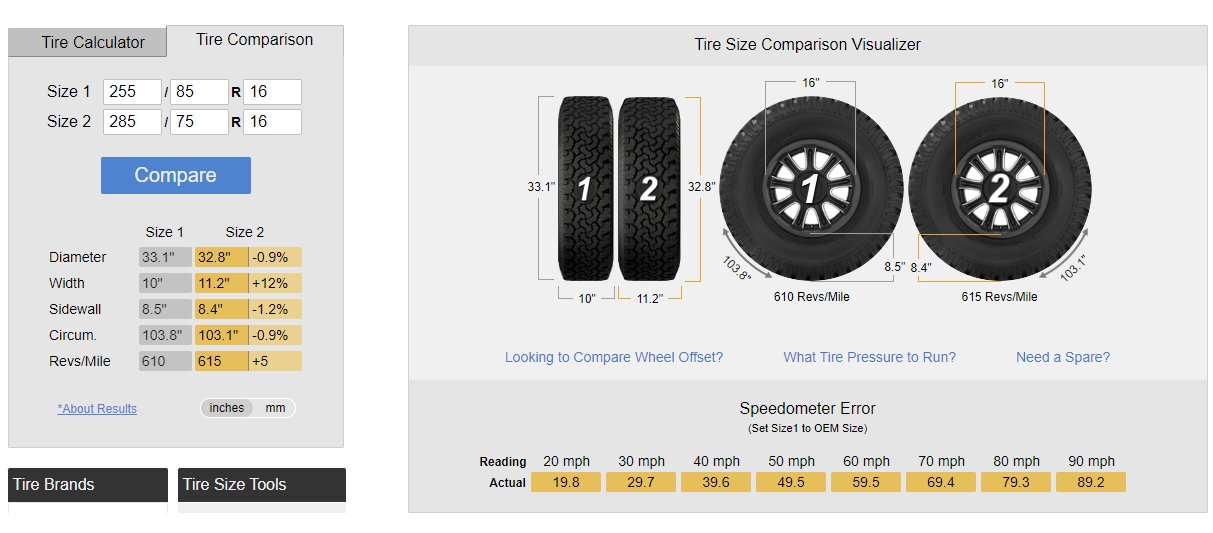

    Although not a massive difference I'd stick with 255/85 for the 2.7 personally. Taller, skinnier for mass and footprint
    285 75s are slightly cheaper than the 255's (with STT Max)
    The 255's are 5lbs lighter a tire. Not a hug difference, but combined with slightly less rolling resistance, its tempting.
    Just a thought. Less rubbing as well.

    I’d have zero problem sticking with the 255s on the truck right now, but they’re mud terrians. I’m lucky if I get 2-3 solid off road trips in a year. I can’t justify driving around on a mt the other 360 days in a year for that. If bfg made the 255 in a at, I’d do it in a heart beat. 265s are to short for the trailsi go on, 255s barley give the truck enough clearance already, so I’m forced to make 285s fit. Plus I think 285/255s are perfect for the Tacoma looks wise

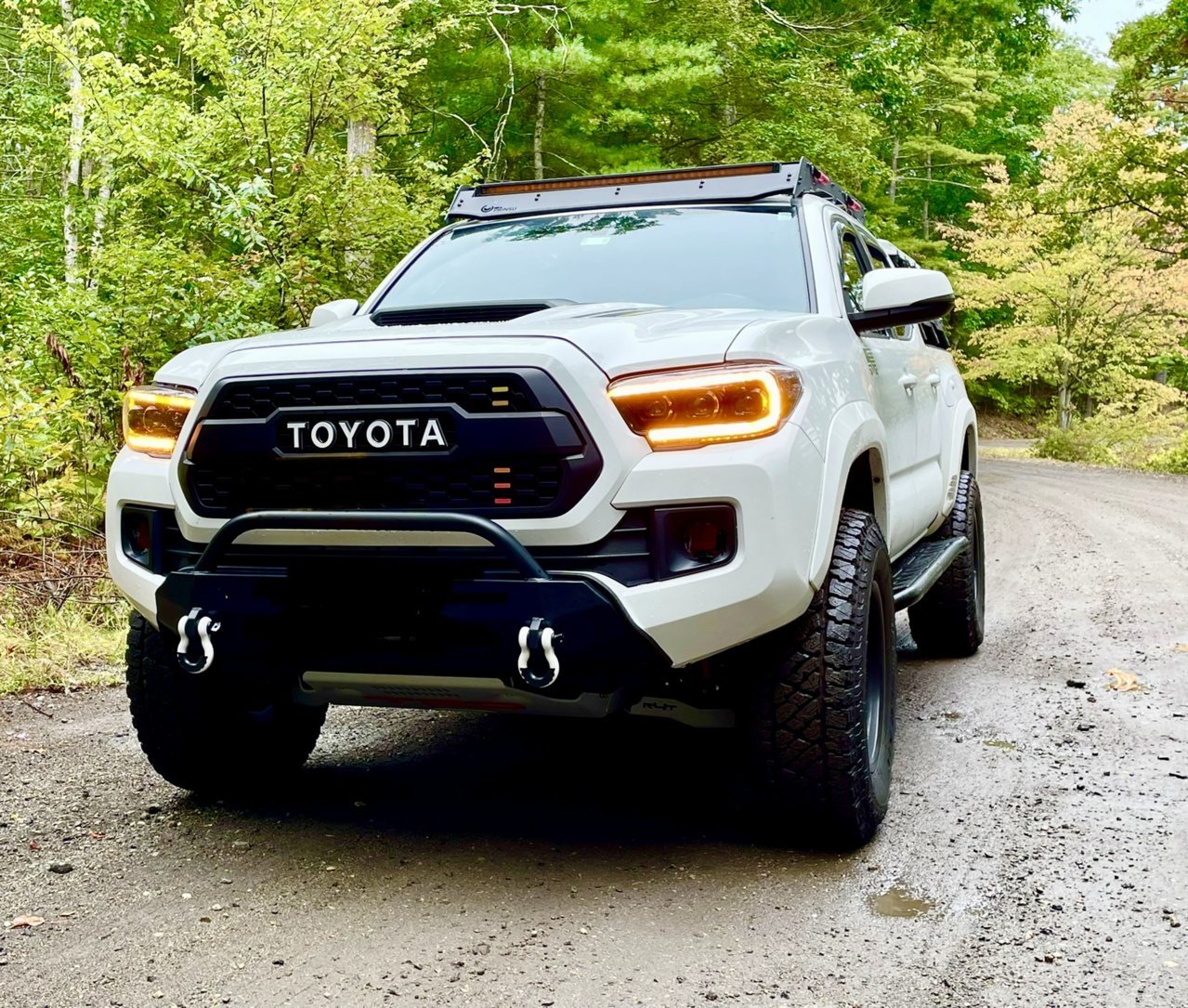

    285/70/17 with cmc . I have SCS f5 -10 offset wheels. I have a 2 inch lift OME just to give you an idea 58667A78-7275-4895-A78D-D232698C1CA8.jpg
