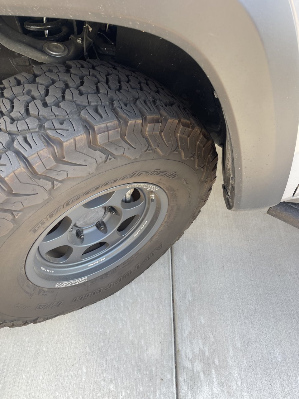

    285/75/16 16x8 0-offset Minimal Rub (Used Heatgun to soften and flatten inner fender plastic)

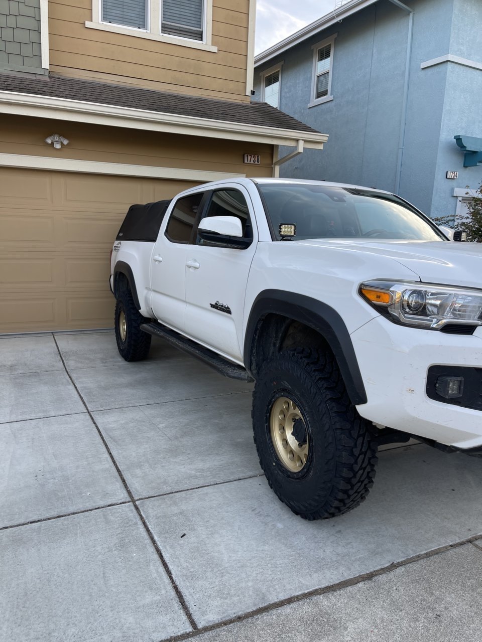

    Kings 2.5” front and rears from Accutune / ICON RXT LEAF PACK black badges doors and tailgate / method 315 / 255/85/16 Yokohama G003 / magnaflow exhaust , axle dump / meso int delete kit / meso led map lights / dome lights / wheelers front super bumps / accutune Flip kit with spacer and new bumps / Cali raised fog light pods / Cali raised ditch lights / RCI FULL SKIDS / SLIDERS / RCI rear bumper / rigid backup lights / tuned on 4.88’s
    255/85/16 0 offset

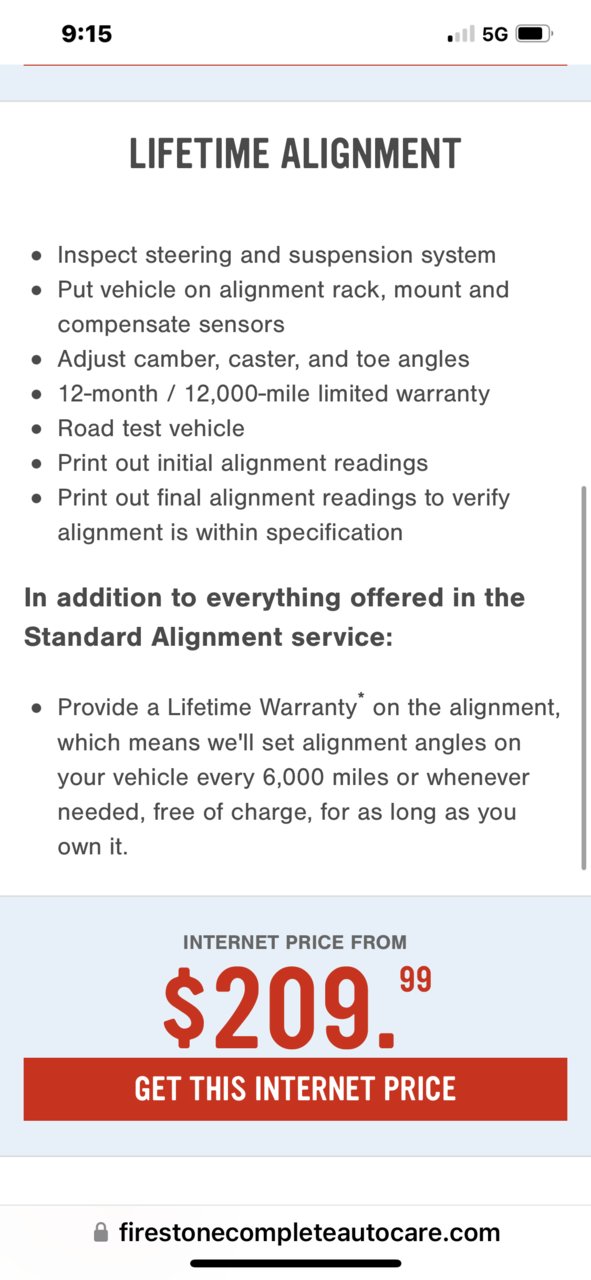

    As far as alignment, Firestone has a deal $200(Not sure on exact price) for Lifetime alignment. I usually get my alignment every other oil change.
