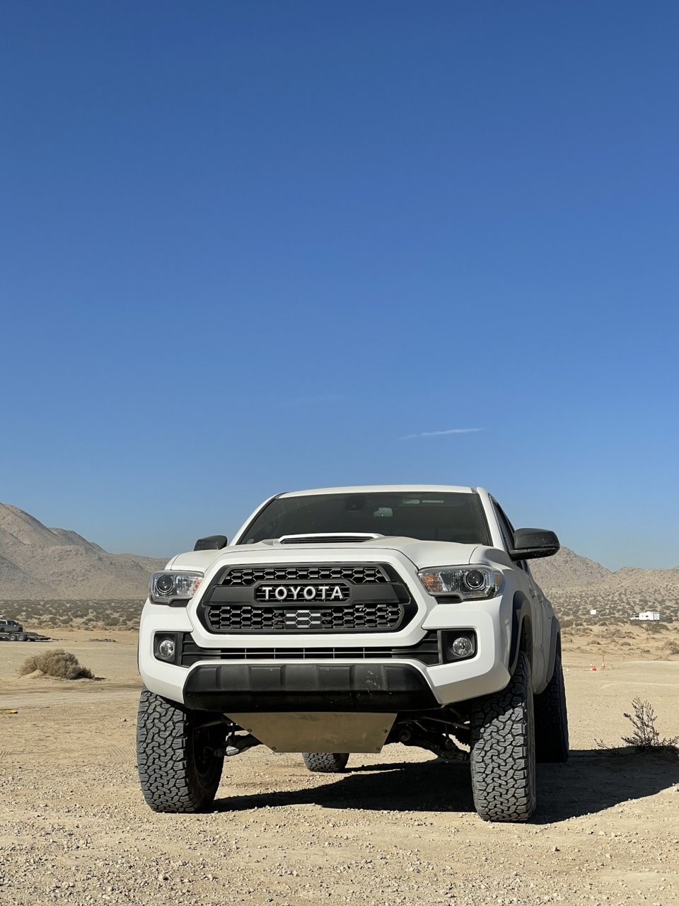

    Stawk as FUCK!
    285/70/17 BFG KO2’s on 0 offset wheels. Stock UCA + good alignment = no running on anything even when off-roading. Good alignment is key!

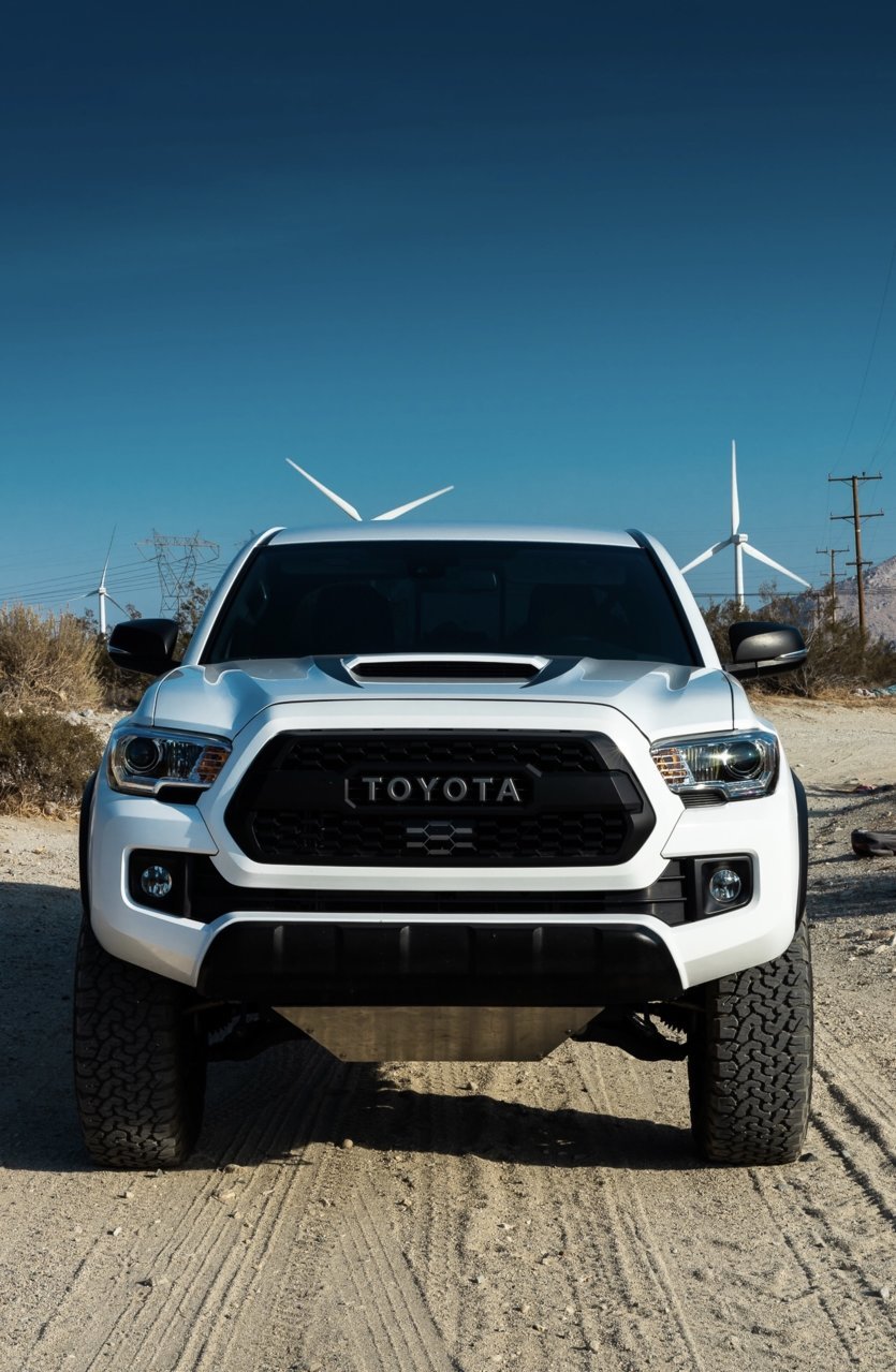

    Mainly Dunes (Gordons Well) & Trails (Moderate trails). Not going to BS you and tell you that I Rock Crawl with my setup every weekend,I don’t (Main purpose for this truck is lugging my tools around from different jobsites). Overall you just need to make up your mind on what best suits you (Everyone will have there 2cents in what they think is best). Good luck on your build…

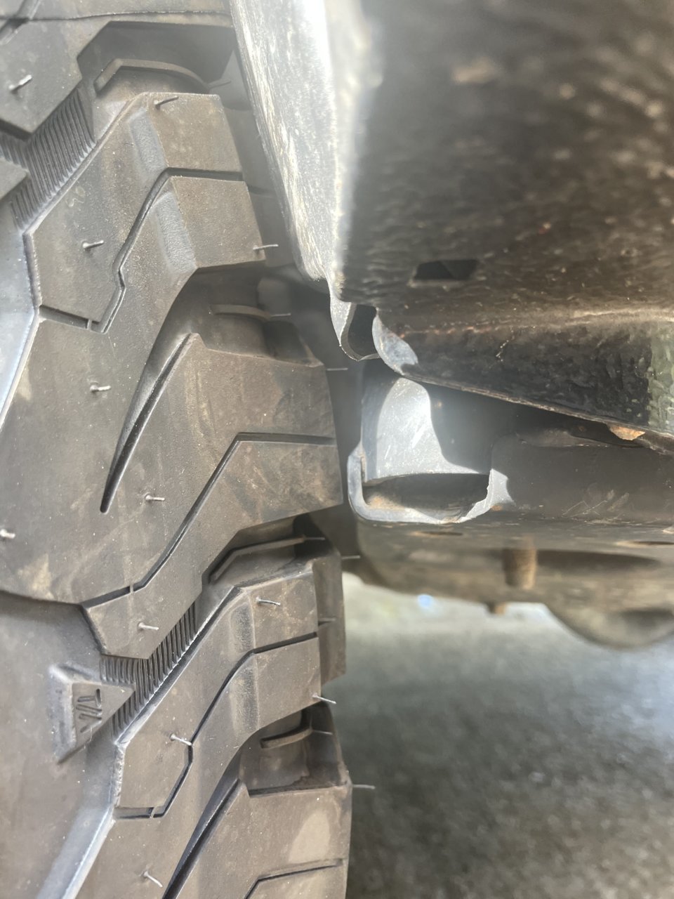

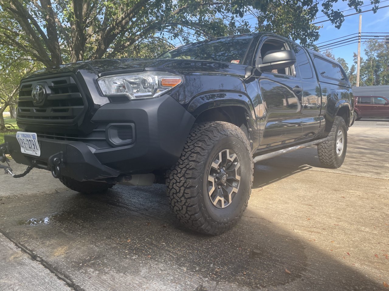

    Got my one 285 mounted up to the 1.25 spacer. It. Rubs on cab mount. I’m going to get that chopped. Hopefully it’ll be enough to clear after that and I won’t have to change ucas/alignment specs.
