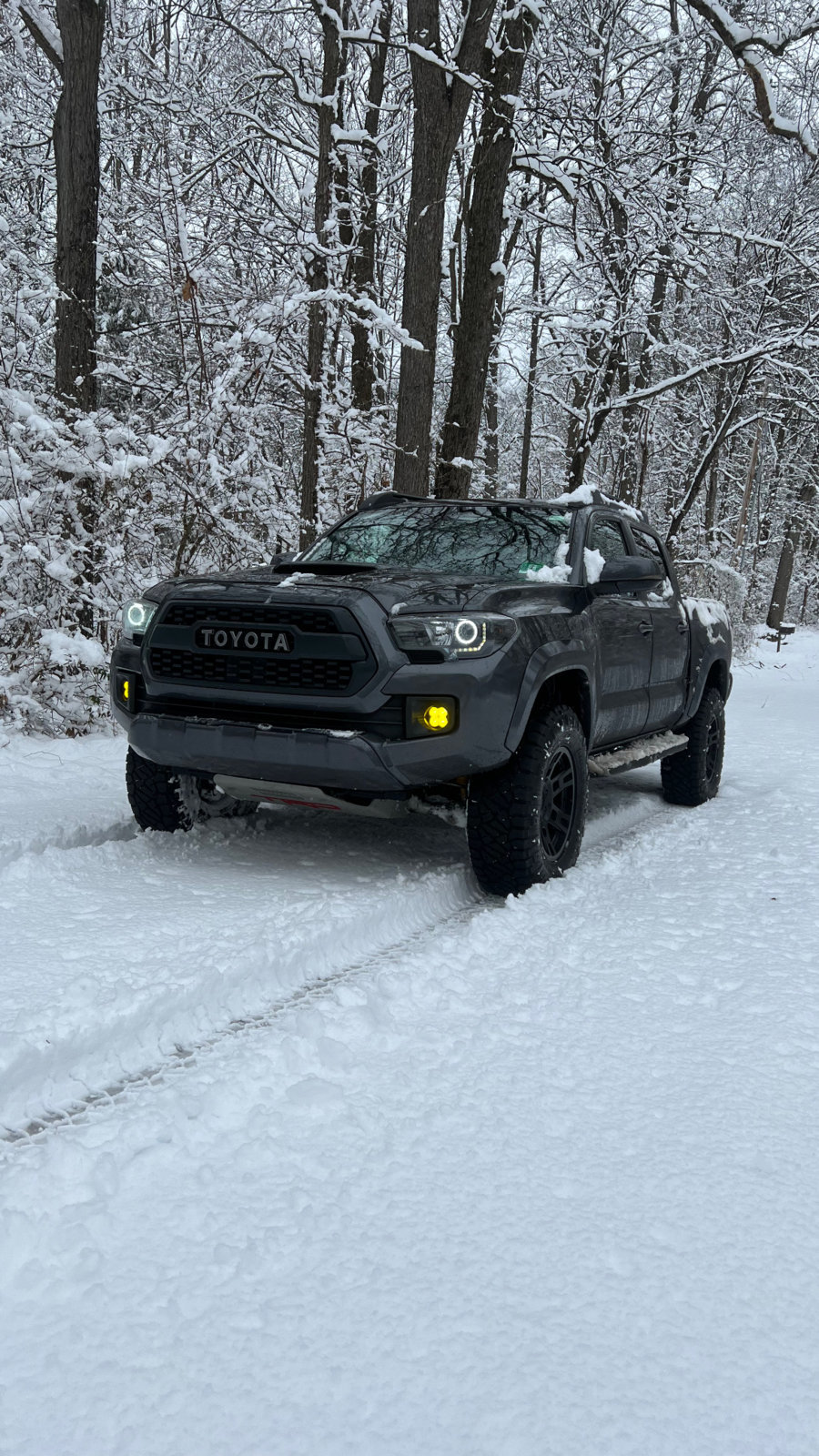

    thanks..not sure why people here slam these tires. Tire rack and reviews on other platforms are usually great in snow

    Good looking truck in the elements. Did you have any traction issues? Ive only had the tires a week so can't give my opinion on performance yet but Im happy with the way they look.

    if anything I’ve noticed the rain to be more of a challenge for this truck, certain scenarios, turning while gassing on initial movement etc..But nothing I’d call an issue or common

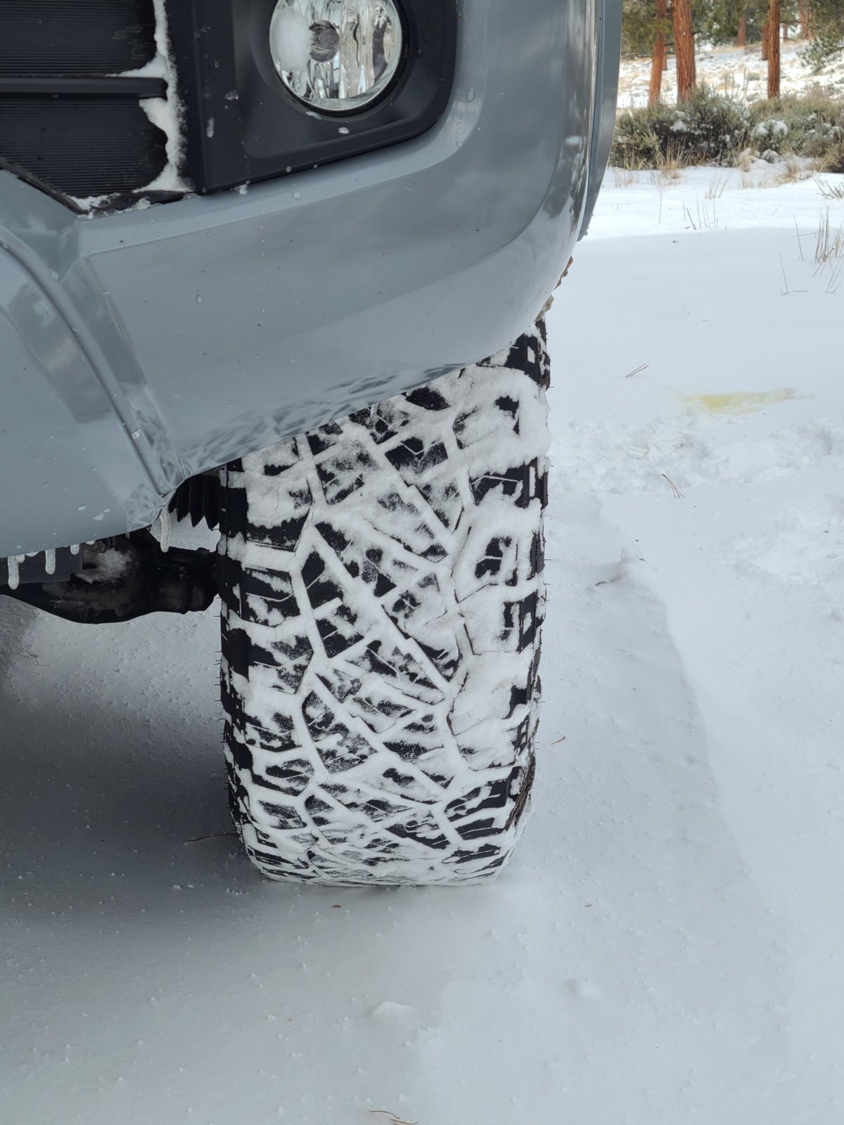

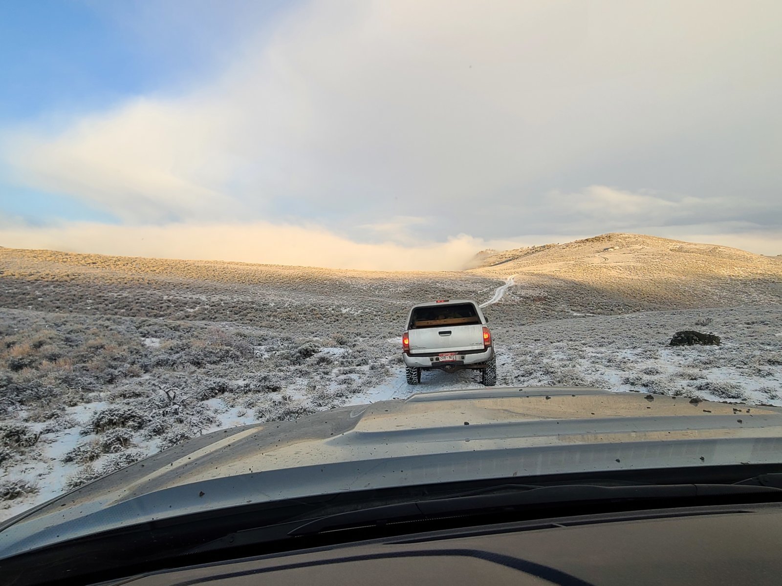

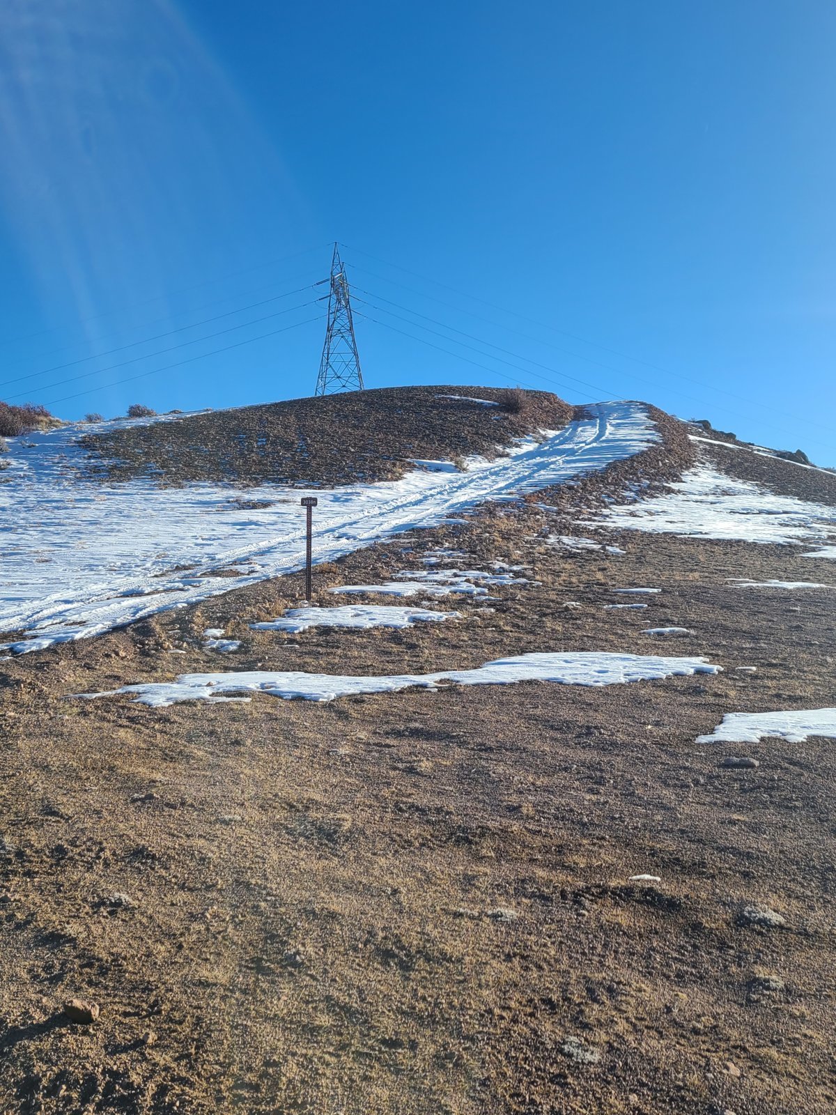

    I certainly didn't want to believe the all the bad reviews the first few years I ran the Ridge Grapplers. I know from past experience the Ridge Grapplers I owned performed very poorly on that last trip.
    Here's a few more shots of when they were newer, they performed satisfactorily on that trip (and others) which consisted of snow, near zero weather over both packed and rocky terrain at times. The other silver Tacoma in the one picture ruined a new BFG KO2 tire the day before due to sharp rocks down a certain canyon (notice the different spare tire on the LR).

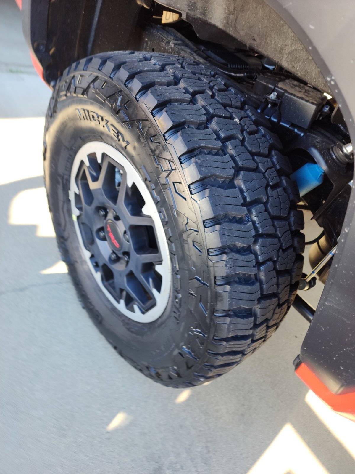

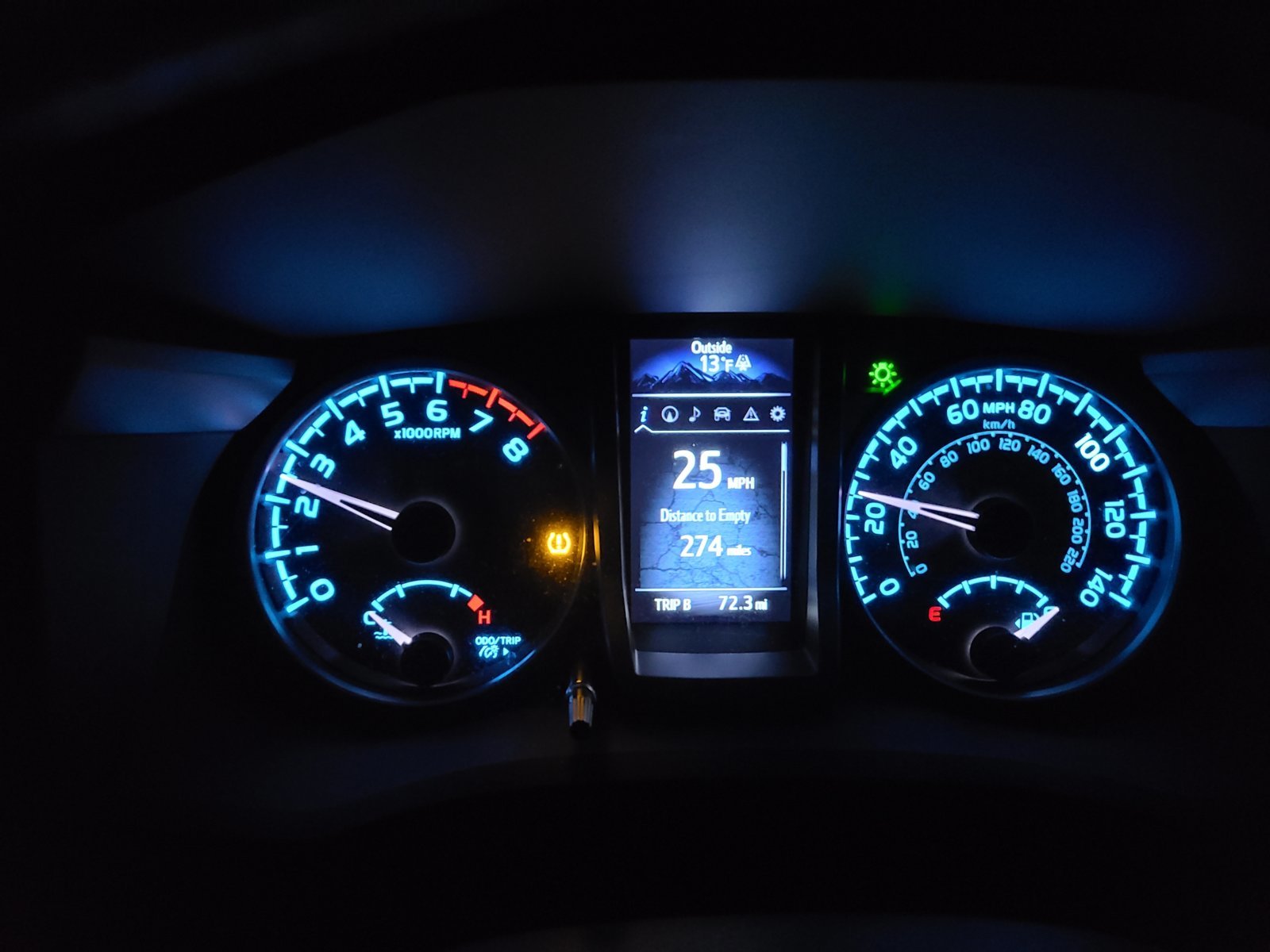

    I just bought these Mickey Thompson Baja Boss ATs for my wife's Tacoma. They have a severe snow rating and 60,000K warranty. For comparison they were about $30 less than a set of new BFG AT K02s and MT is offering a $100 rebate so double win in the price dept. Reviews are very positive for this tire especially for snowy conditions.
    I won't scrimp when it comes to tires. Snow and icy conditions can be the most hazardous IME.

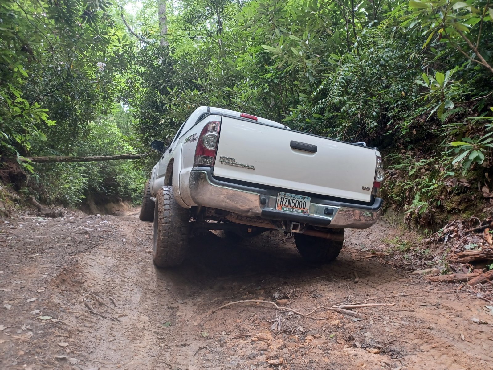

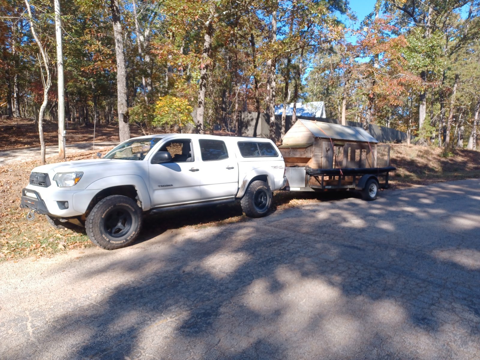

    Is this photo I have steel skids (engine, transmission, and transfer case), a low profile front bumper with a winch, 285 75 16. The wheels are light weight FN wheels. (Less than 19 pounds each) and the tires are 56 pounds each which is one of the lighter 10 ply "33's" that you can get. Plus the camper shell was full of stuff, pulling the trailer, etc. The truck had no power issues whatsoever. I was very impressed. I drove 55 to 60 and the rpms still stayed around 2,000. When not towing I averaged 18ish mpg. With that being said I put stock tire size back one and took off the camper shell because my truck became my daily driver and I commute 100 miles day. Still have the bumper, winch, and skids installed and I can get over 21 mpg on my daily commute. So yes if mpg is important I would stick with the 265 75 16. It's a good size and will take you places most people want to go. Pair them with some fn wheels and you will have a killer set up. I only put on my 33s when I plan more serious off road trips.

    that is very impressive, I could see that being the advantage of a 2nd gen taco since my 3rd gen even in stock form leaves me some more power to be desired due to gearing IMO. I have also found that the OD of the tire size affect power/torque output and mpg much more than the weight of the tire/wheel combo, that being said, of course the lighter the better. I like fn's but I am set on the toyota beadlock style wheels due to I just love the look of them. Now I am impatiently waiting for the KO3 to come out in the size of 265/75r16 (weighing 50lbs each) in August 2024. Cheers!
