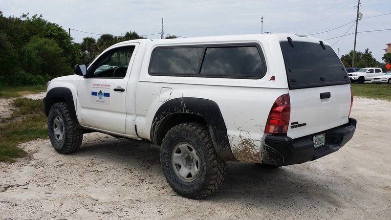

    Color matched grill, 285/75/16 nankang mudstars, leer topper
    I'm running 285/75/16s on stock wheels, no spacers and no lift. Also no trimming. I've only gotten a little rubbing on the uca at full lock In reverse.
