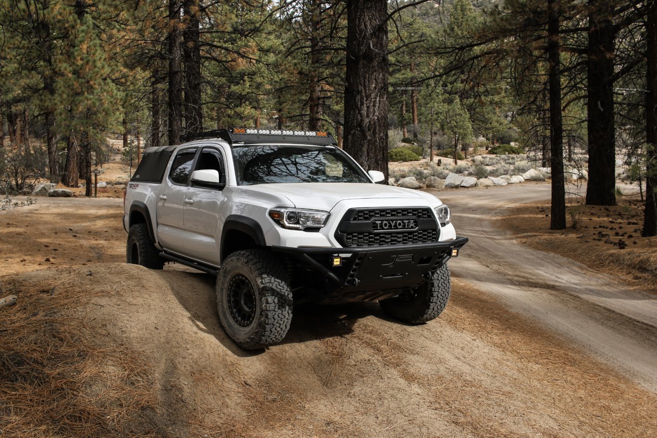

    Just saw this thread, and thought I’d post here... 295/70r17 Duratracs...

    Wow. That looks nice!

    Noice! So if I may...clearly Kings....can you shoot us some data on that lift? Rear ? CMC? Rims specs offset, bs,
    Etc......LOOKS FANTASTIC!

    Thanks! Kings up front with Camburg Uniball UCAs. Rear lift is just about a 1.5” lift/level block for now while I wait for new leaf packs and rear Kings which should give me another half inch +. No CMC, with Caster set to 4.3 I’ve got zero rubbing at full lock either way going forward or in reverse. Only had to bend some plastic out of the way. Rims are 17x8.5 Kmc XD301 Turbines with -6 offest.

    And the bending plastic was only needed when the tires travel up into the wheel well. Around town, I haven’t had any contact with any part of the frame/fenderwell...
