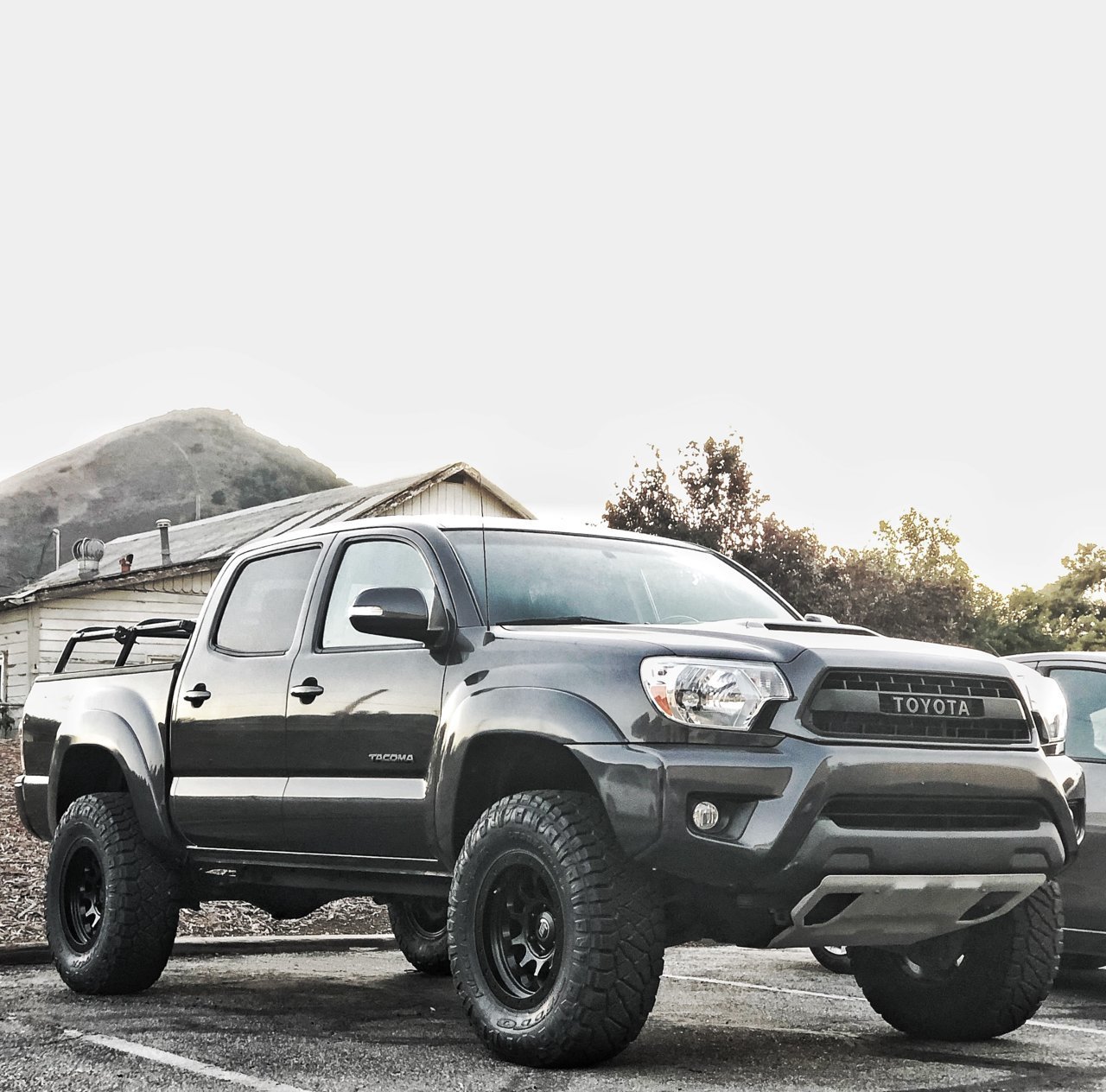

    Timinatorx92
    Timinatorx92 Well-Known Member
    Feb 4, 2019
    #281861
    86
    28601
    2006 Black Tacoma AC TRD Offroad
    3" toytec lift Method 16x8 Grid Coopers at3 xlt 295/75/16
    295/75/16 at3 xlt.
    RangerComa, TrailYeti[OP] and irayfz6 like this.

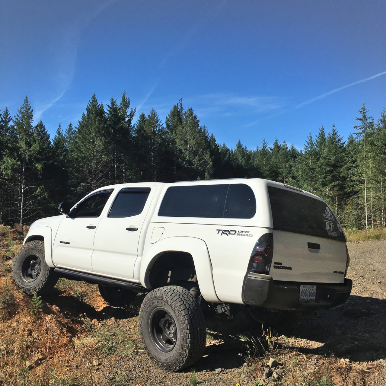

    295/75r16 Cooper Discoverer AT3 XLT //
    Timinatorx92 and irayfz6 like this.

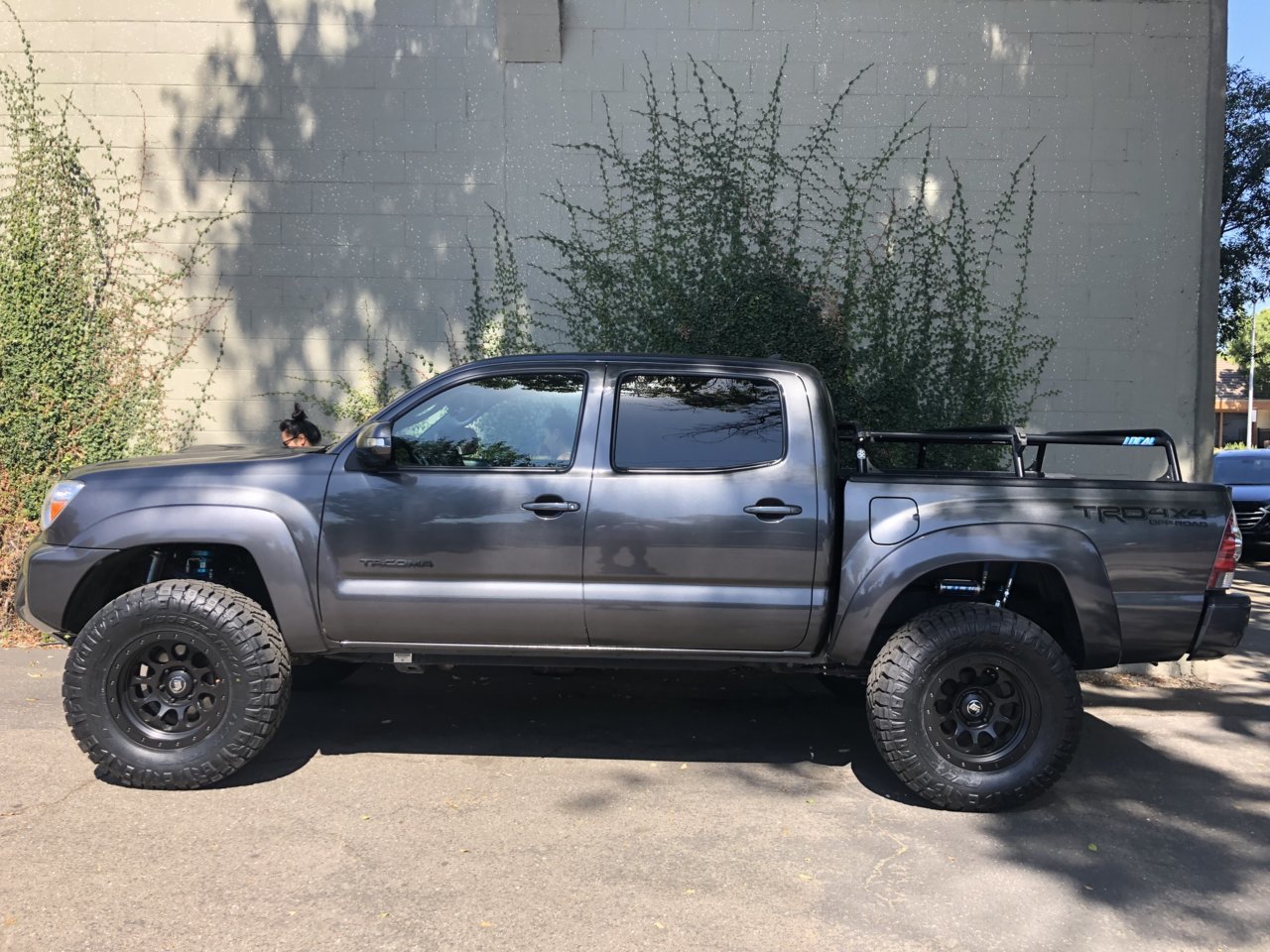

    If I may add. I previously was running 265/70r17 nitto Trail Grapplers and made the switch to 295/70r17 nitto Ridge Grapplers. My gas mileage got better.
    TrailYeti[OP] likes this.

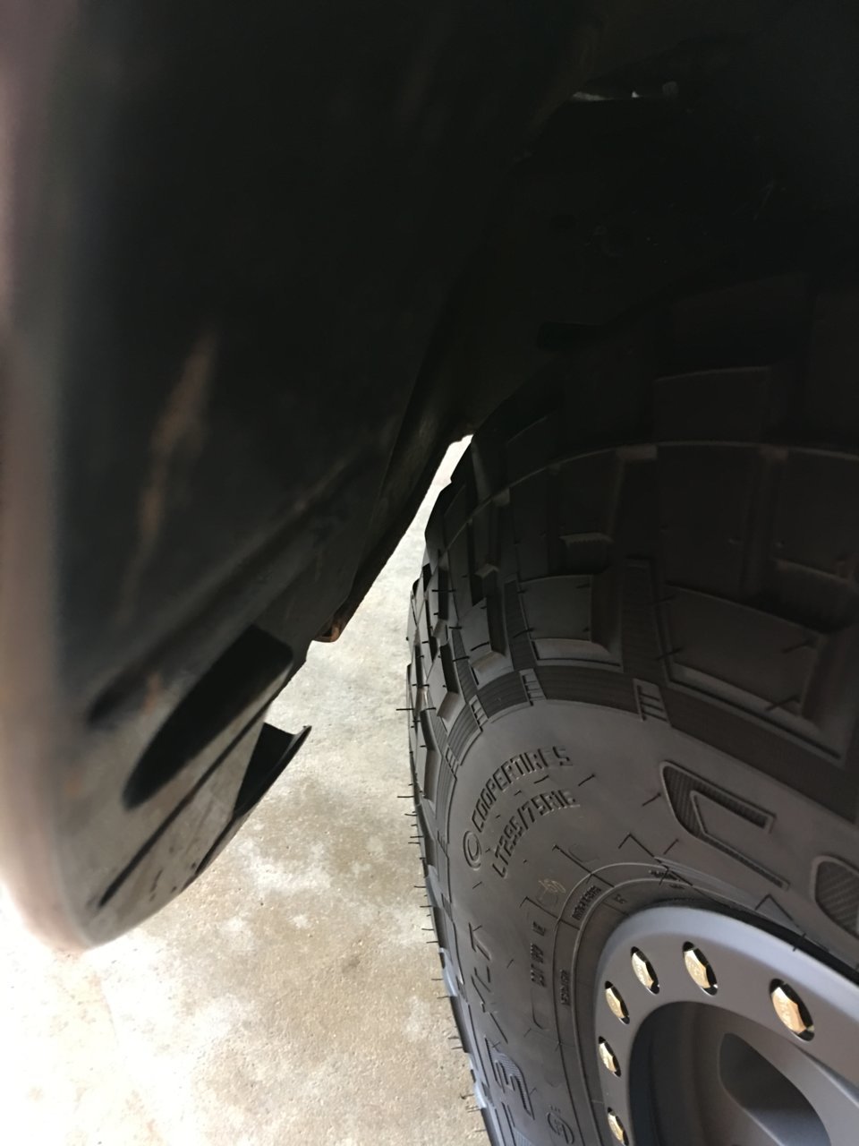

    Thanks to this thread I may go with the Cooper AT3 XLT's in this size. Gonna buy new tires next month. Compared my 285's to the 295's, the 285's new are at 32.8" and these 295's are at 33.4". Any reason these wouldn't fit with a 4" spindle lift paired with fox 2.5 coilovers? Right coilover is set at 0.5" and the left is at 0.75" to make up for the lean.

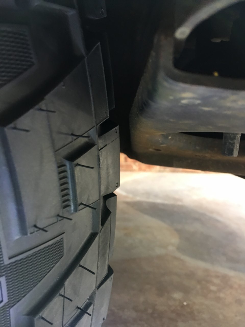

    This was my clearance on 295s before doing my my cmc. Clears on the streets, but went ahead and did the chop before taking offroad. Ran on 0 offset wheels with high caster. 3" lift.
    Pengowirr likes this.

    Sorry, forgot to mention that, I have the cmc. Did that about 5 years ago.
