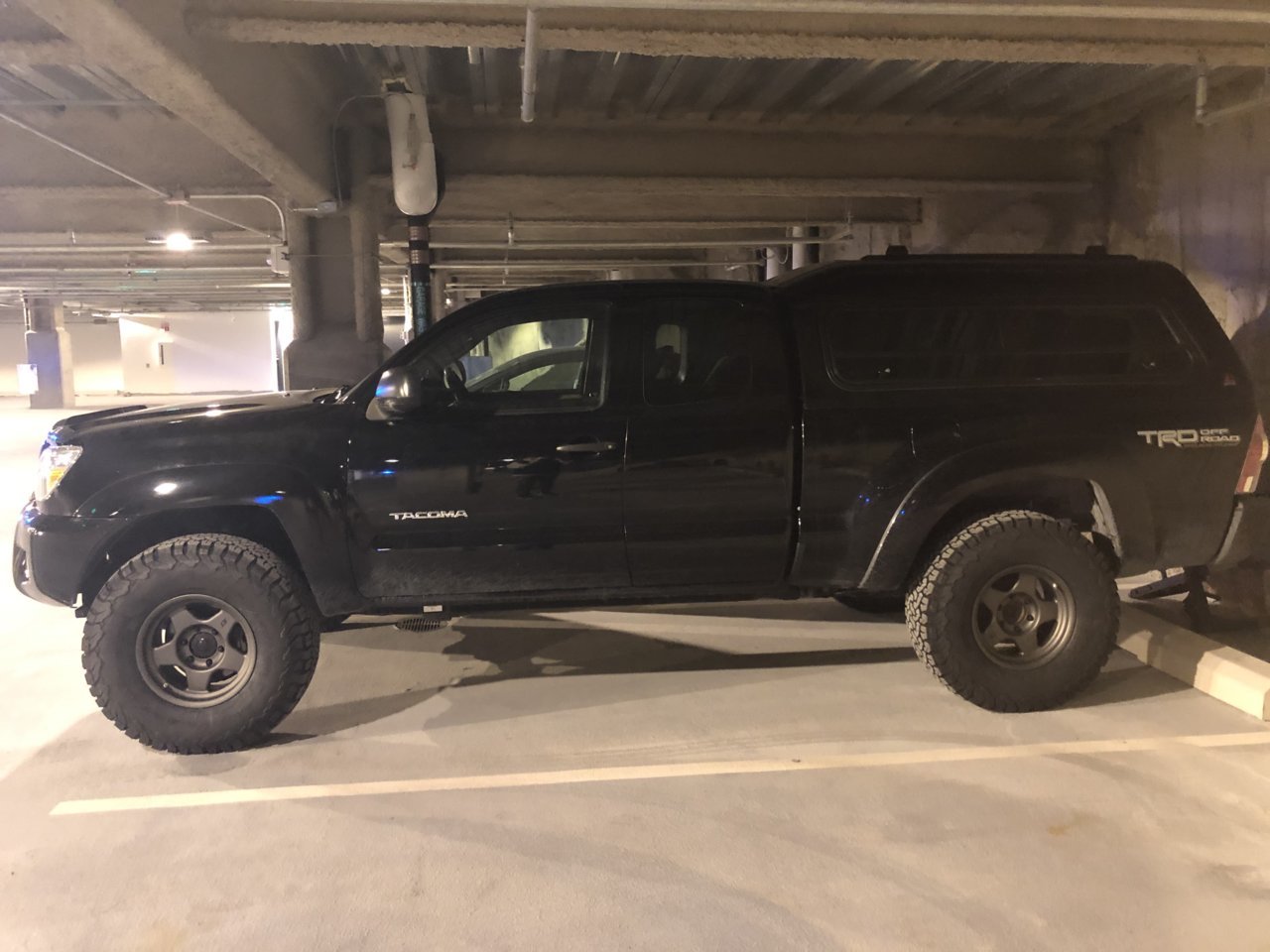

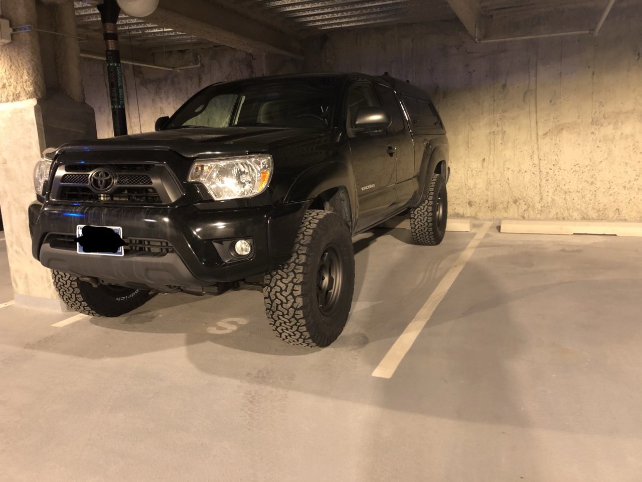

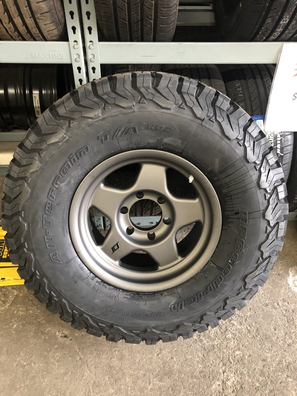

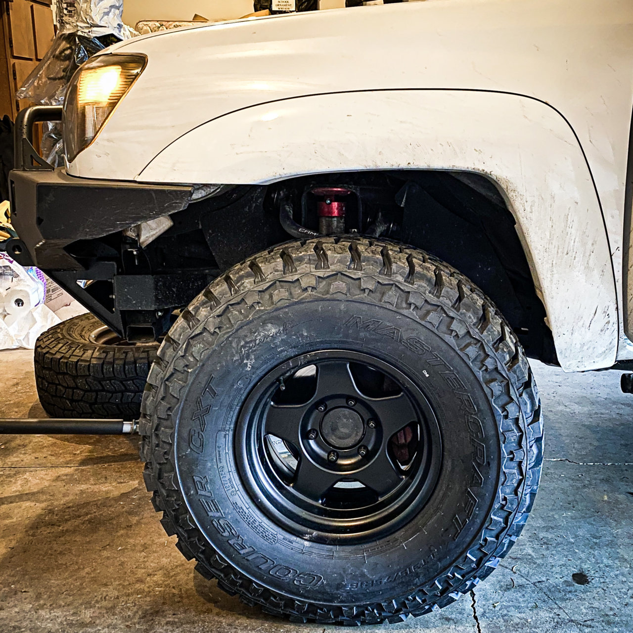

    Well sheesh...
    295/75/16 KO2s on 0 offset F5s
    Also got one mounted on the OEM spare steely (thanks @ST77)
    848DA828-EAC5-45F7-9751-42A4D9B046F0.jpg AA26A69D-0EE0-4E3F-A4C5-2E8DD8836364.jpg FB657070-024A-40E9-8D81-01A1730CDE49.jpg

    Looks good, what lift you running?

    Full OME with 885s up front and medium Dakars in the back. SPC UCAs and ~3.6 degrees of caster

    Sweet! Looking good.

    No rubbing? That front tire looks damn close to the flares. My -25mm offset f5s and 295s rubbed all to hell, even in town. I mean I even had to trim my actual fender to fit these. The 0 offset really makes that much difference?

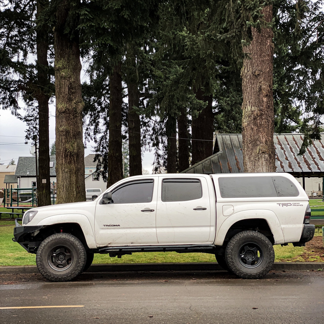

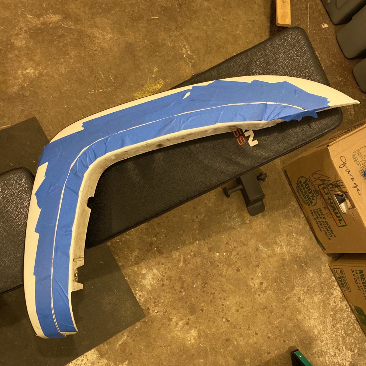

    Damn. Looks good. I imagine you’re gonna have to trim till the cows come home and do some tubbing?

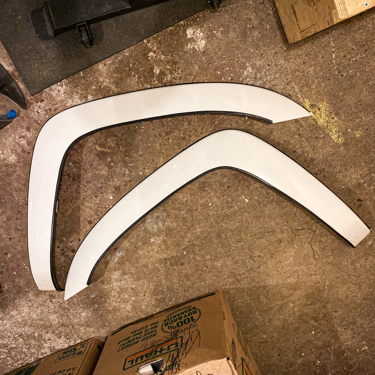

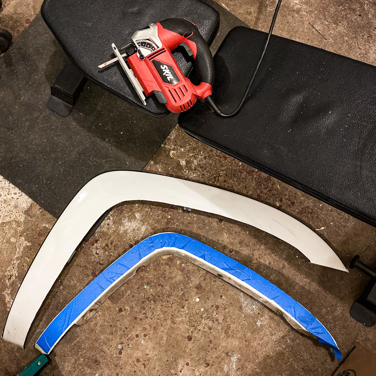

    Yes! I removed and cut my front fender flares this past weekend. Next on the list is cutting the fenders. I already have a super-aggressive CMC and firewall/pinch weld hammer so I should be good there.

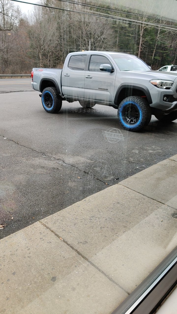

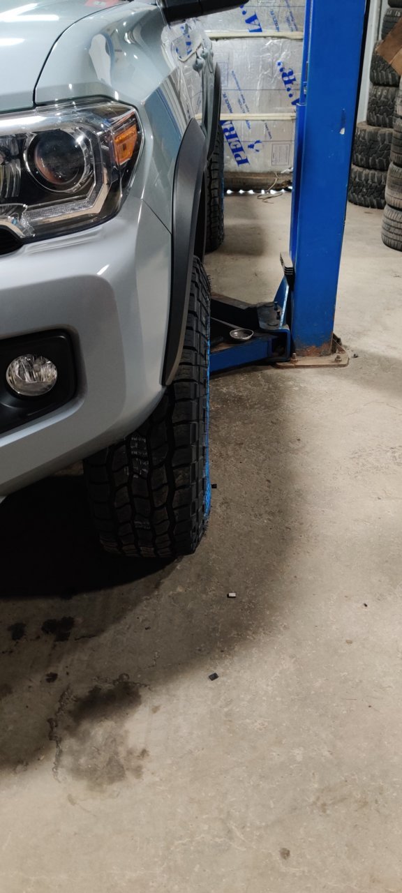

    295/75 16s, no rubbing anywhere. The right alignment specs will do that

    Well, what are the right alignment specs?

    Whatever works with your set up. All Tacomas have suttle differences. I literally have no rubbing whatsoever and I tried once I aligned it and put those on.
