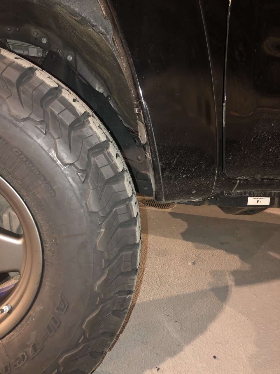

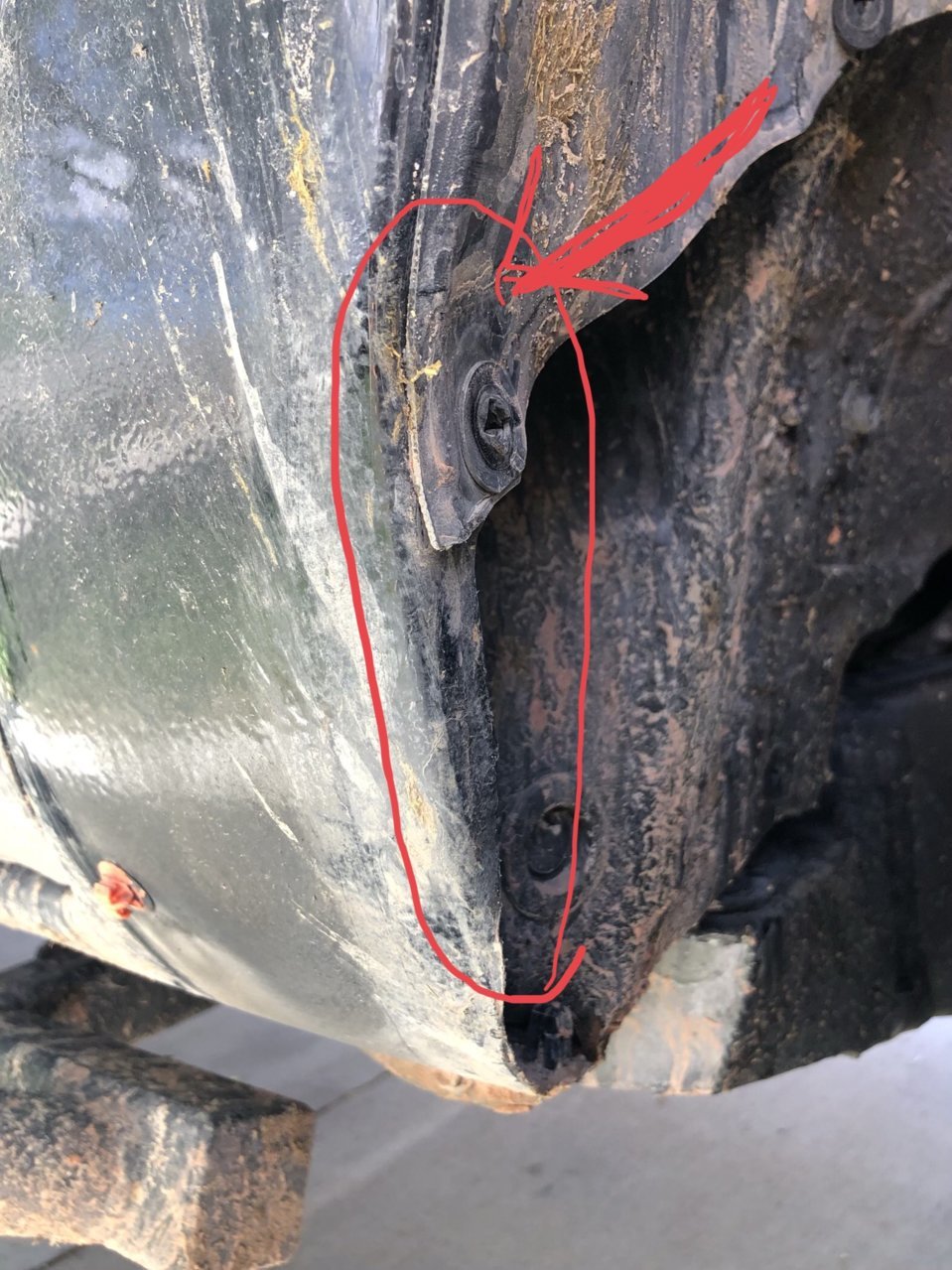

    Nothing terrible yet. I had some rubbing while turning on that inside back corner of the fender so I chopped that off. Had a CMC done before I mounted the 295s up. Just cutting little by little as I hear the rubbing. No plans for getting on a trail in the near future so figured that’s good enough for now. I’m a little worried about the upwards travel rubbing the top of the liner with my minimal lift but we’ll see.
    I still need to hammer the pinch weld (outwards right?) and cut some of the thin metal that the lower liner or mudflaps mounted on.

    Nice! Yes hammer the pinch weld outward, seam seal then spray rubberized coating. When I was checking for rubbing at full compression, I did rub the top of the wheel well liners. I mean, I had to TRY to get it to lol. I had to hit a mean dip at a decent speed so there’s my input

    Sweet thanks for the tips! What lift are you running?

    I’m back on the stock Bilstein’s that were specifically for the Baja. I need to get it realigned though, they didn’t add enough caster that I wanted

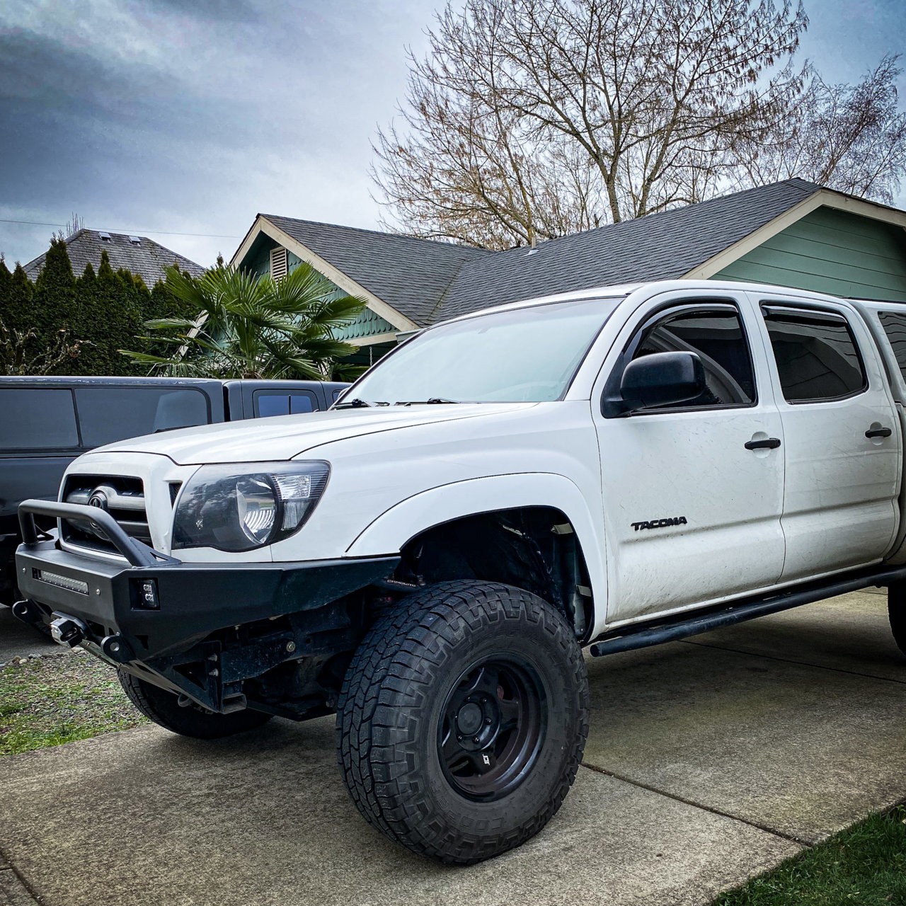

    ...ready for 35’s (I’ll be cutting the rear at a later date). :anonymous:

    Looking good! Are you planning to re-gear?
    Island Cruiser likes this.

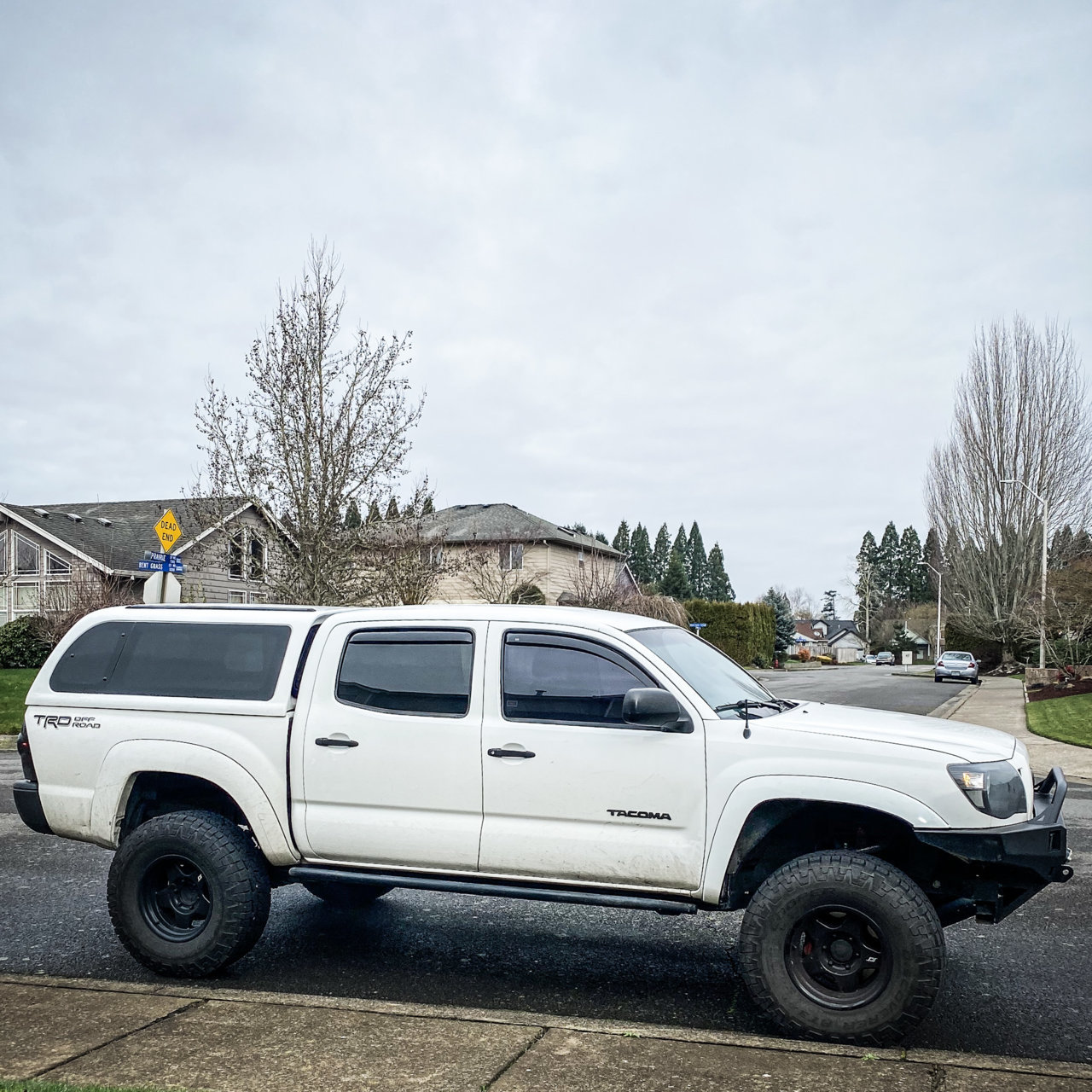

    I see tabs in this pic. Did you make those from the fenders?

    Yes I did. I’m making liners to protect air intake.

    Down the road a bit, yes...we’ll see how bad it is. I purposefully picked one of the lighter wheel/tire combos...and I just flashed an OVTune. I’ll let you all know how it drives.

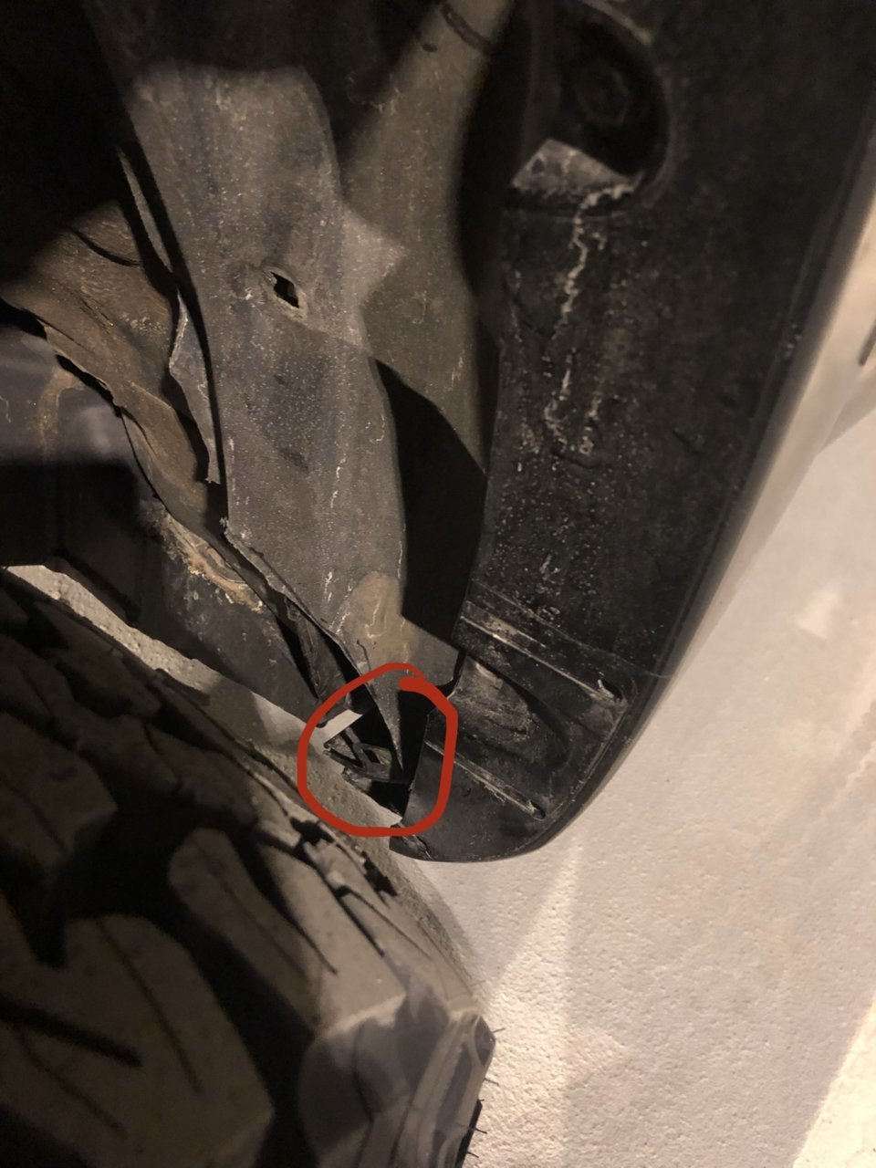

    Just tried to fit my 295/75/16 KO2 spare in the stock location and it was no good. I bent back the tabs or ears or whatever they’re called. The issue was the width between some metal on the drivers side and the exhaust. The exhaust rubber dongle thing would clear but I got stuck when the middle of the tire was at the heat shield. So I dunno, maybe that means I need a swing out ‍:spending:

    Or chop the exhaust :sawzall:
    Depends on your idea of a good time. :bananadance:

    True.... just been looking for an excuse for the swing out.
