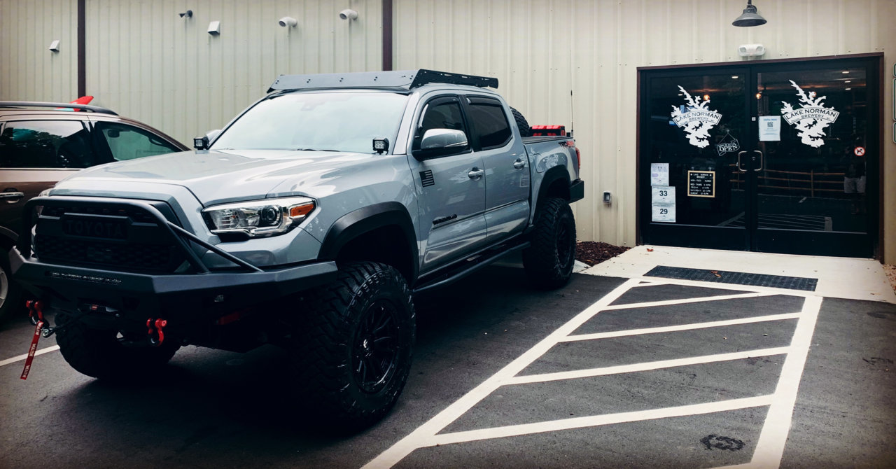

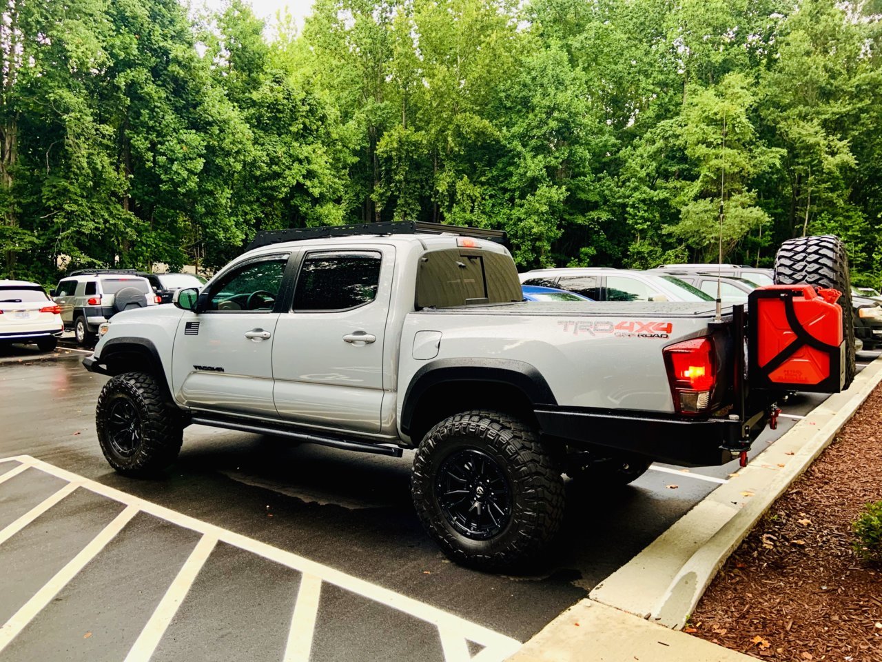

    It has been a while since my 295 post and I dropped some mods.

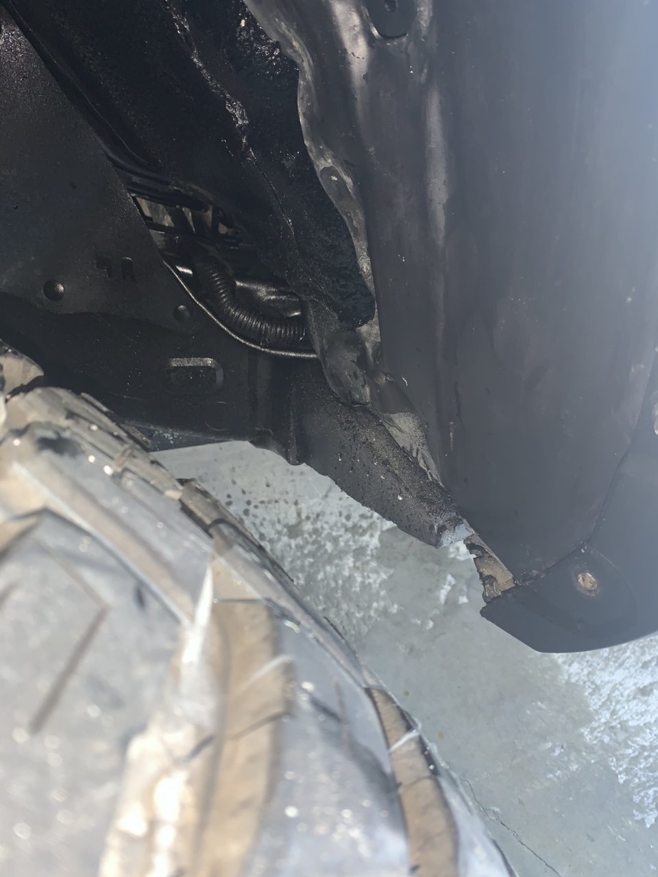

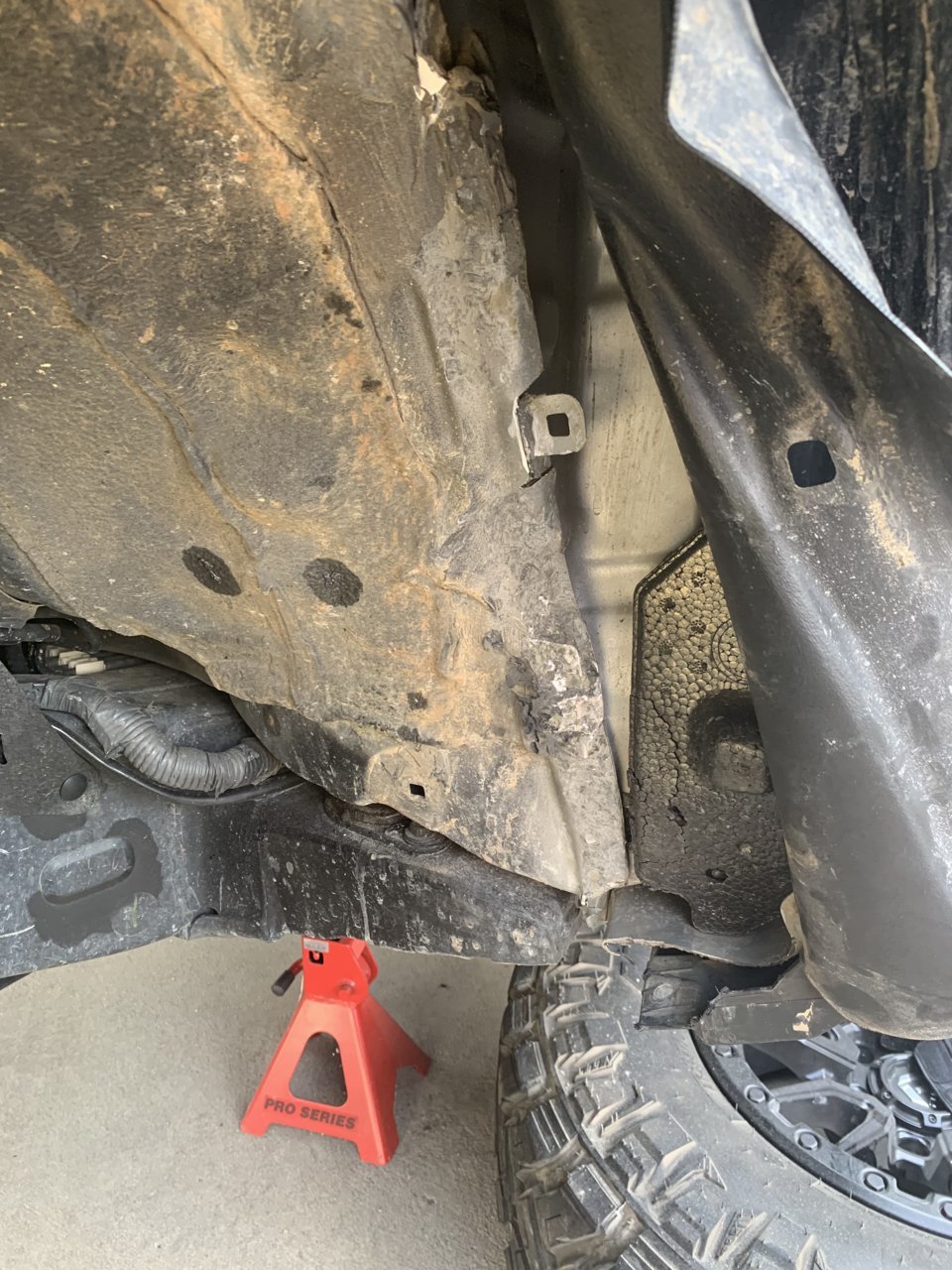

    I added 1.25” spacers. That and the weight of a steel bumper, winch and skids = rubbing. CMC, pinch and heat gun fixed that.

    One of my most favorite tacos on this forum. Only thing I'd do different is 16's instead of 17's. Just saw your IG too

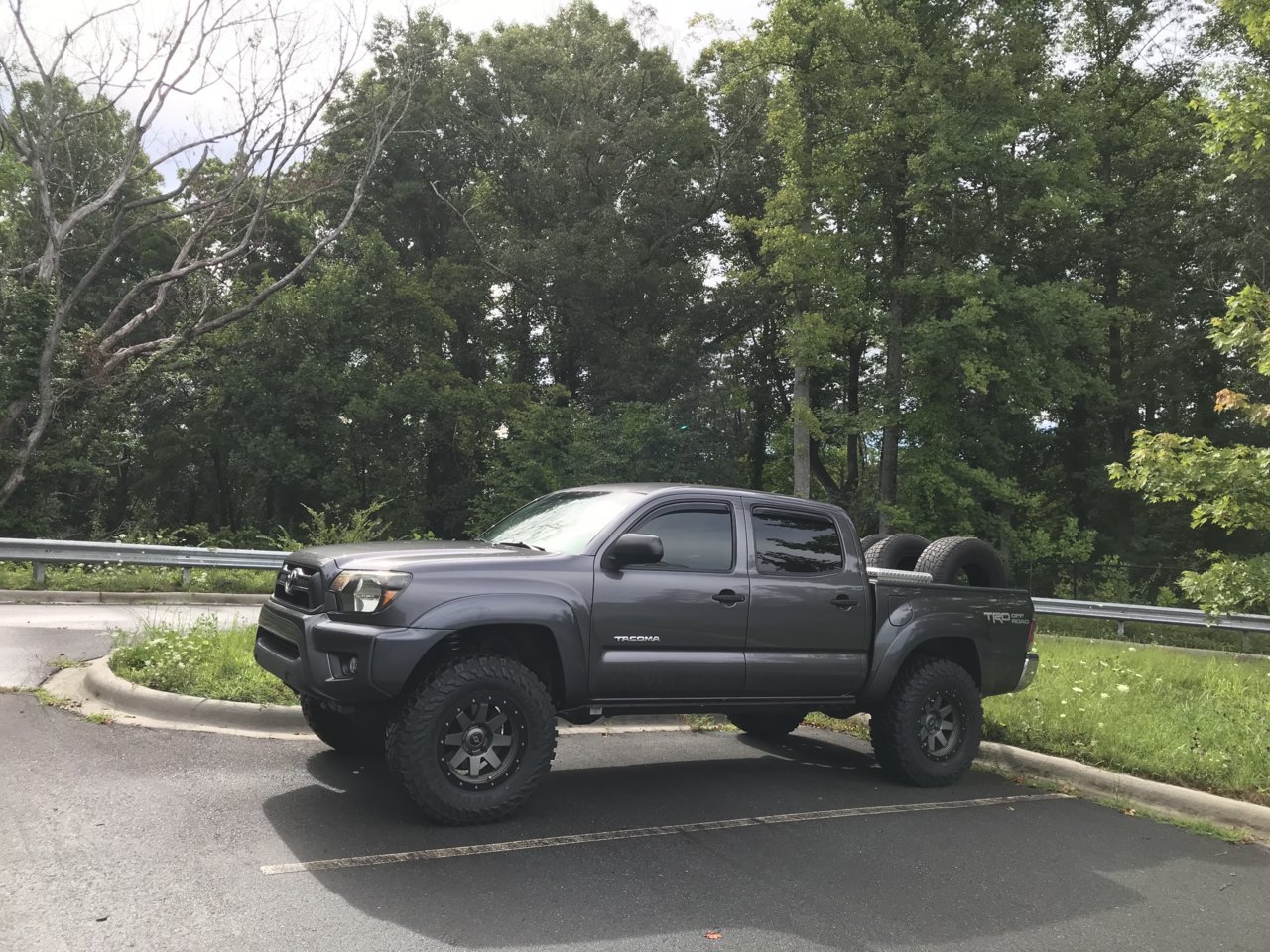

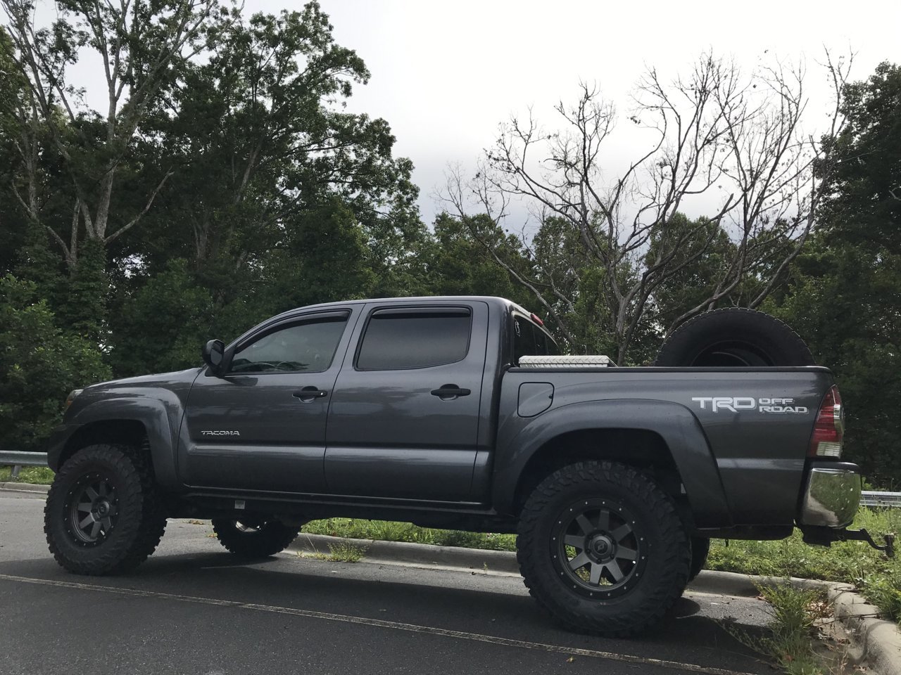

    Bilstein 5100s Toytec Coils SCS SR8 295/70r17 Yokohama Geolandar MT G003
    No rub with normal street driving so far and only ziptied the fender lining in the front of the wheel wells back CMC up next here soon192A03A4-D451-4A7B-8E9D-B508223397CF.jpg 590FD7FA-81DB-4E41-A395-454C92417107.jpg

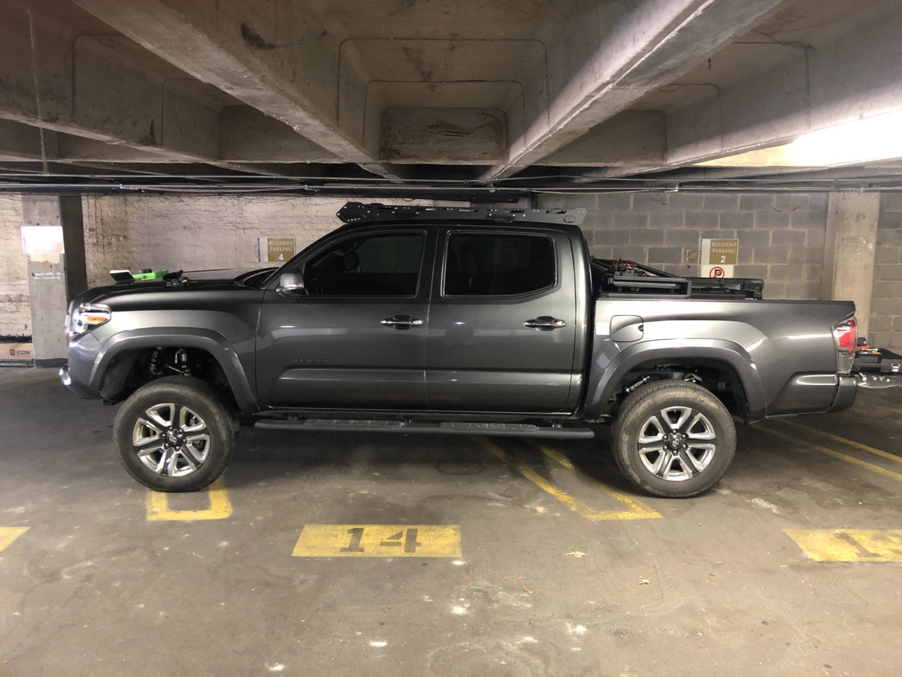

    Recently lifted swapped stock for a 2.5" ICON Stage 4 kit on my 2019.
    The shop I have been talking to is telling me that to fit 295/70/17's I need to do a body chop. What is everyone else seeing? I suspect that I will absolutely need it because I live in a building with a parking garage with hairpin turns to enter/exit.
    Same shop is also saying I cannot run the TRD Pro Rims w/ a 295 due to rubbing. Anyone try it? I glanced through a couple pages but didnt see it.
    Also considering the Konig Countersteer if folks have thoughts on the risk of rub here...?

    You’ll definitely need a body mount chop and small trimming of the bottom corners of the fender flares. Maybe even the fender liners, but since you have Icon’s it’s not as easy to compress that far due to the 700lb spring rate. Even if you have to, cutting the liners are quick and easy with a razor blade. I have no idea what the specs are for the 3rd Gen TRD Pro wheels

    TRD Pro are 17" with a 4mm offset.
    Konig Countersteer X are 4.1mm offset.
    Ideally thinking Nitto Ridge Grappler 297/70/17 at the moment.
    Photo of the truck immediately after cranking the front coils to 2", pre-settling.

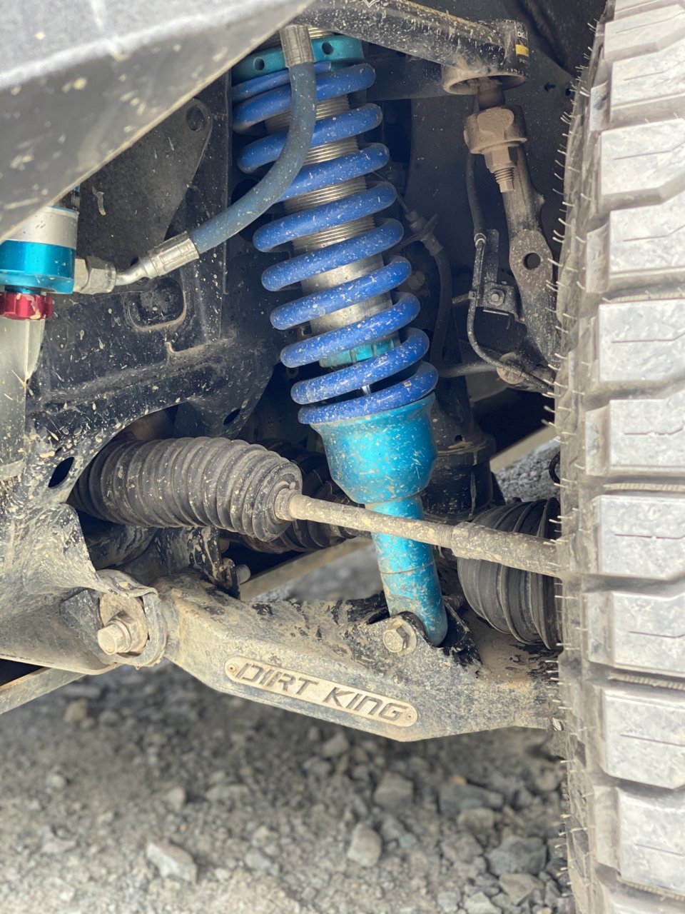

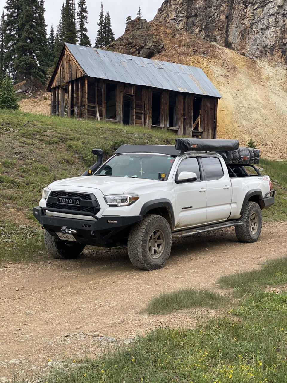

    Added @DirtKing lowers and headed to Colorado

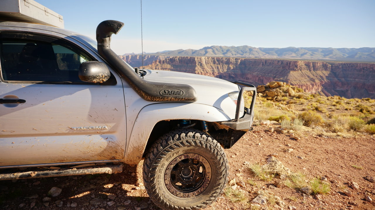

    i have been running the yokohama geolander G003 MT in a 295/70-17 for a while now, just wanted to say im impressed with them. tend to run them down @ 15-17 psi offroad, they've never missed a beat grip wise, and is still quiet enough on the highway. so very happy with them

    You’re making me want those tires asap. I just can’t justify swapping out my current tires after only 20k :goingcrazy:

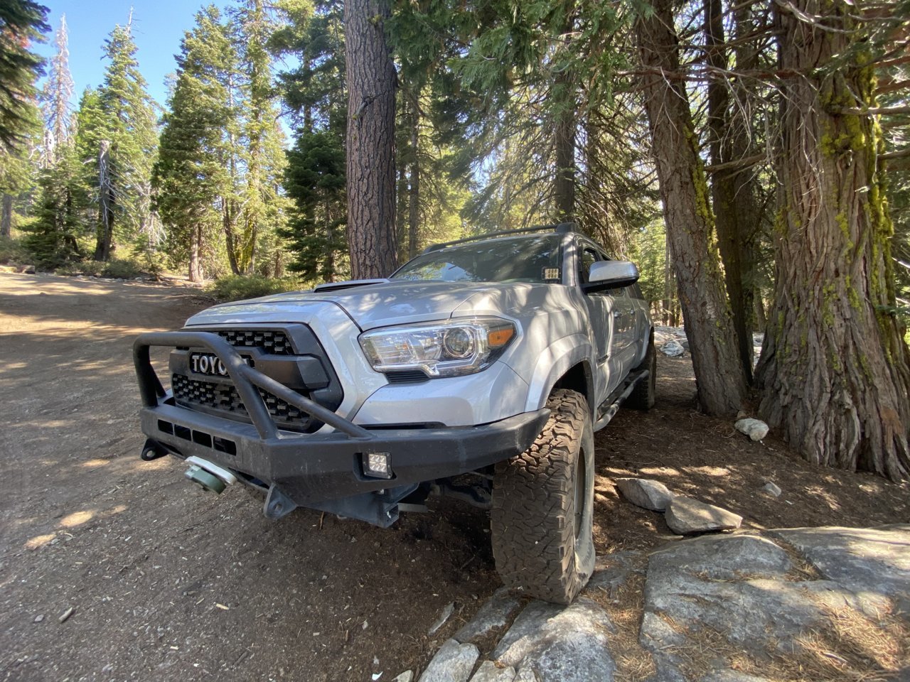

    Currently have SPC UCA’s and they are quite nice for dialing in the alignment numbers. I had Dirt King tubular UCA’s as well and those are nice too, swapped them for the SPC’s to get better camber numbers.
    I’m not quite sure how much lift actually. Maybe 1.5”? 2”? My cv angles are perfect, pretty much look like stick to me. I prefer low and fast to tall and tippy. Anyways, I’ve done Chopped the cab mount and beat the Pinch weld along with some fender and fender liner trimming. I still rub the top of the wheel well on big hits :notsure:

    oh man, yeah not sure i would swap after 20K but something to think about for the future mate. unless i guess you really dont like your current's.....

    As you post another pic lol! Surely not dangling the bait :D
