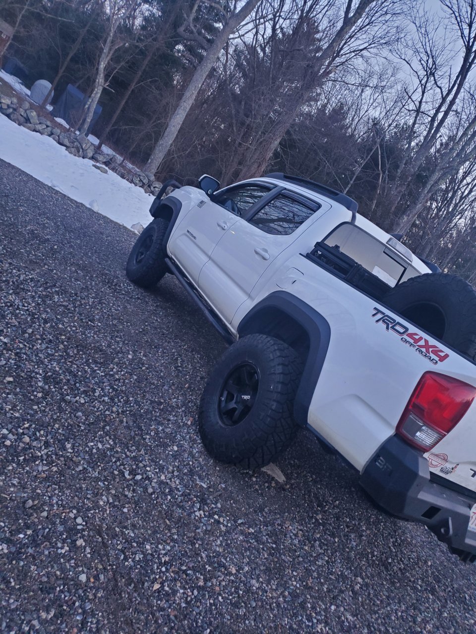

    295 75r16 Nitto Ridge grapplers level 8 16x8 -10mm offset
    OME 886 W/96R Dakar & JBA HD UCAS. Alignment spec is 0⁰ toe 0⁰camber 4.2⁰castor. Have the cmc, pinch weld smashed and cam tab gussets. Thanks for this thread for a true 33.

    This x1000
    None of that rounding up shit

    Yup not a 32.1 like a 285 a 295 is a 33.3 solid for me best tire size for 2.5+ inch lift

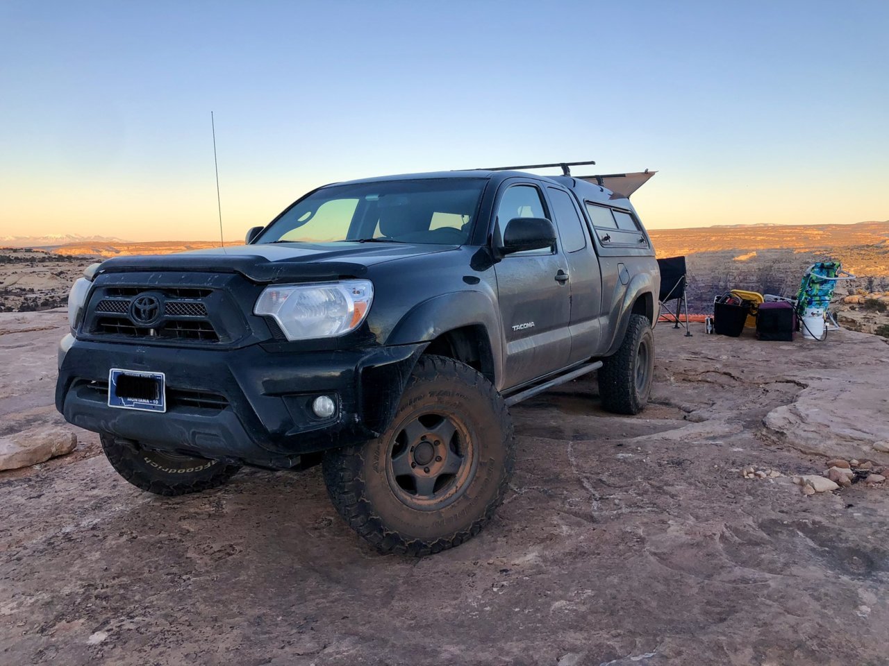

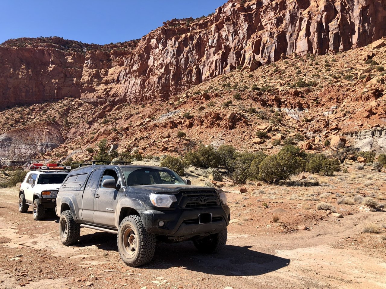

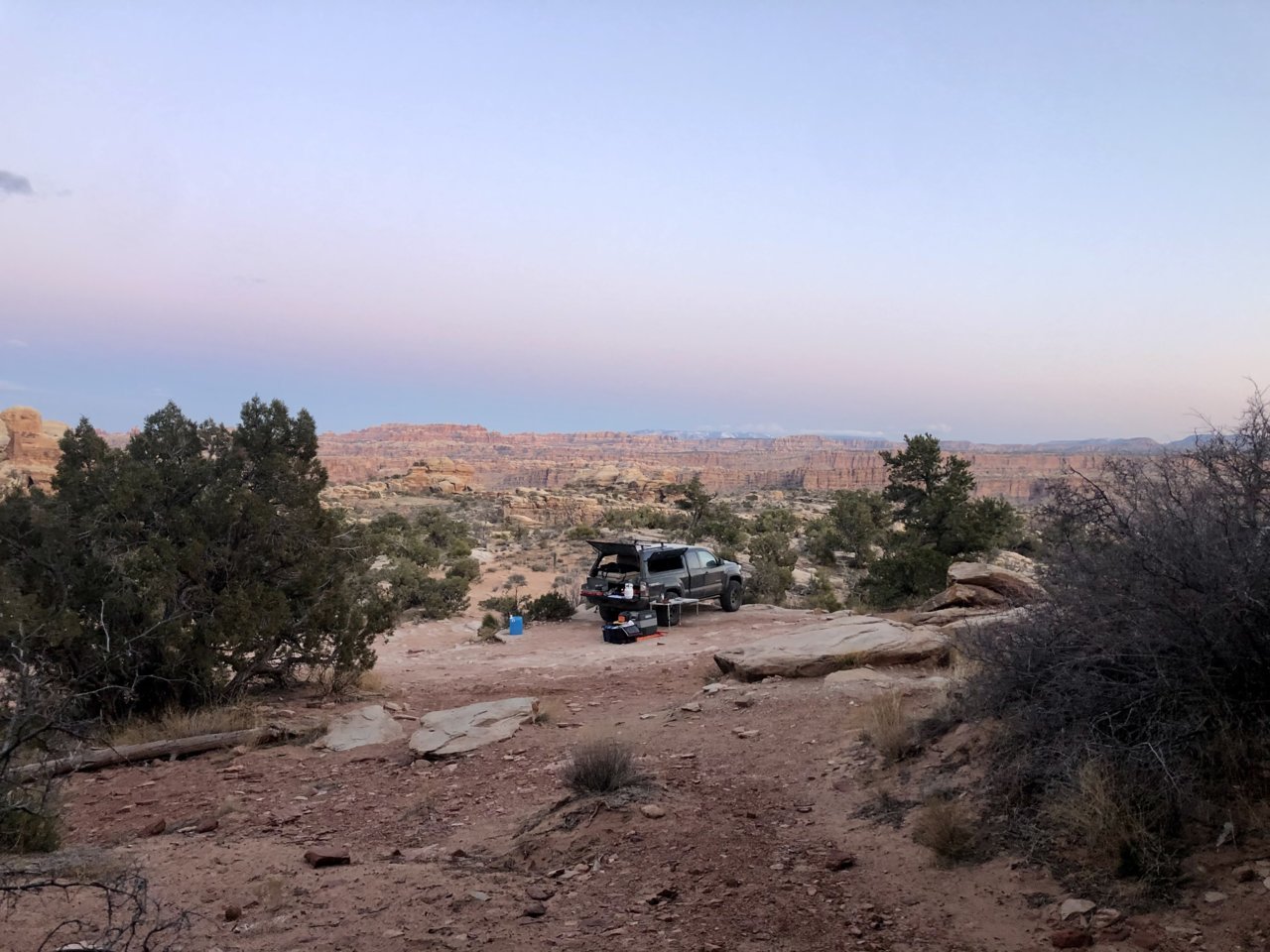

    01BF9A0C-5C37-47B4-9707-0F103018FCD9.jpg 91AE763B-CB30-4291-9321-810CE8AB9C66.jpg 5269D052-0A2B-4786-A223-31DF2522FA67.jpg
    First big trip since the 295s went on a while back. Super impressed. Minimal rubbing mainly on sudden compression off a ledge or something. Definitely more I can trim though. Yeeeewww too long since a proper trail trip! Way too much fun.

    What wheel BS do you run? It looks like the 3.5”?
    Reason I ask is... I have 295s on 3.5” BS SCS F5s with ~3° of castor. I found that I rubbed on the fender flare, then the actual fender itself, which I trimmed... (see a few posts back).
    Then when I began to wheel harder I found more rubbing on the fender (which caused a dent in the fender) and trimmed them more.
    if you look carefully you can see the dent in the fender from the tires hitting it.
    I also realized I rubbed on the firewall and had to take a hammer to it.
    But also on found rubbing on the inner fender. This is the kicker! Rubbing on the inner fender when I took big steps or whatever wheeling along with stiffer poly radiator bushings caused cracking in my core support near the radiator bushings.
    So if you are running the 3.5” BS F5s beware. There will be more rubbing that is causing damage in the background.
    cracking in the core support caused by me smashing my 295s in 3.5” BS wheels against the inner fender when I wheeled hard

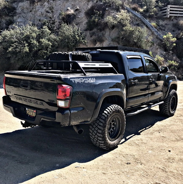

    SCS Ray10 17x9 -38 with BF Goodrich KM3 295/70/17

    I'm running the 4.5" BS actually. Similar caster around 3 degrees. So far I think it's saved me some headache. I did notice small rub on those 2 spots at the top of the inner fender you pointed out when stepping down off a ledge. It seemed pretty low impact though and I don't believe there's any cracking behind the fender wall. But that's really good to know so I can keep an eye on it. I probably will have to cut more off the lower corner of the fender flare so it sits more flush with my cmc and flat pinch weld. But honestly that trip is about the hardest I can see myself wheeling (I think?) so hopefully it gave me a decent baseline of rubbing issues.
