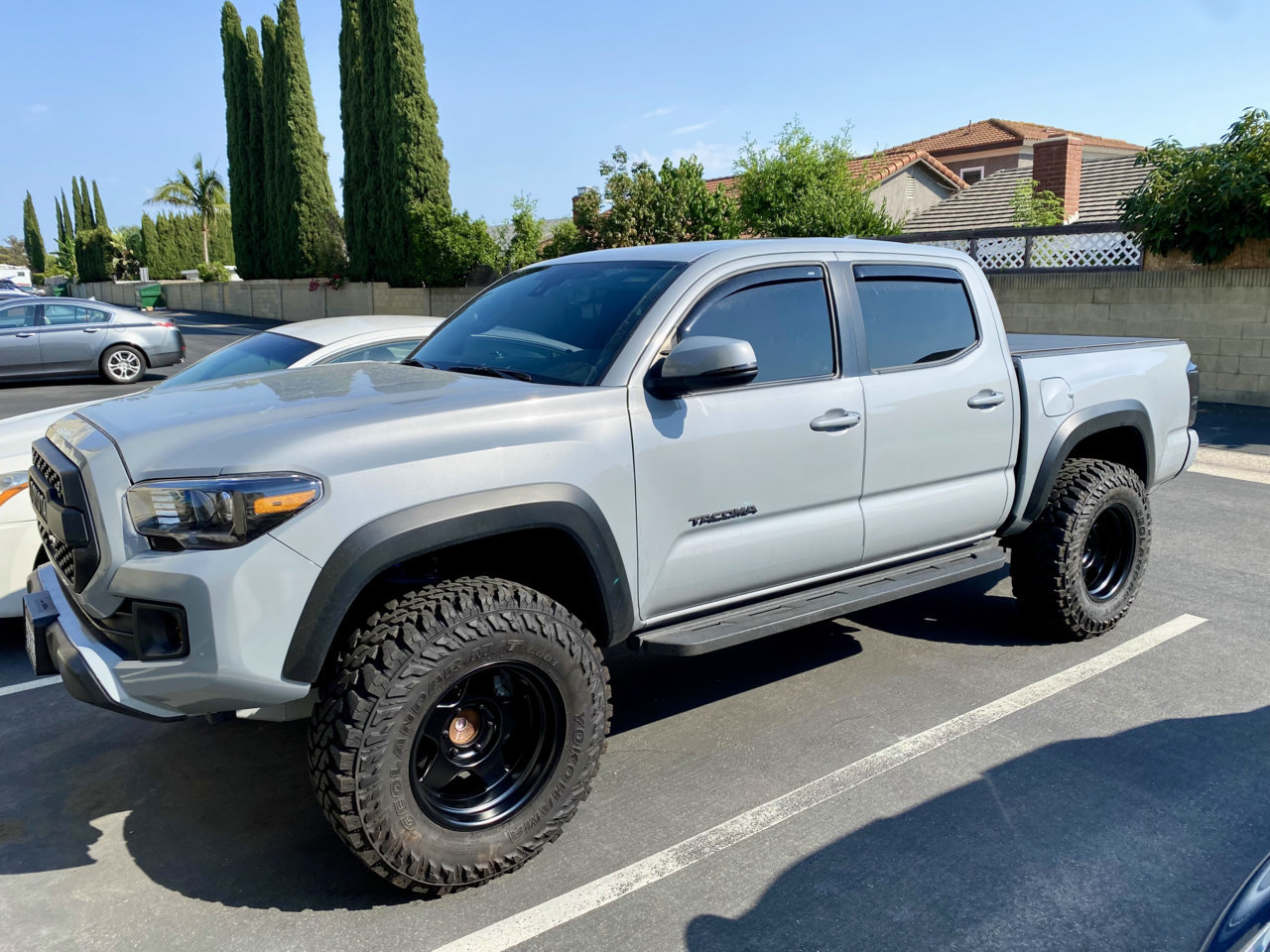

  1. Jun 22, 2021 at 11:16 AM
    #821
    LRockPro
    LRockPro Well-Known Member
    Mar 13, 2021
    #359206
    96
    LRock
    looks good! 295 is prefect..

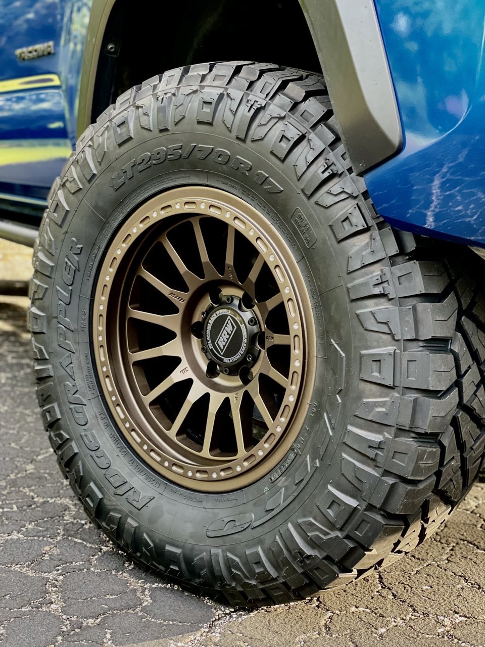

  2. Jun 28, 2021 at 10:09 PM
    #822
    Camel89
    Camel89 Well-Known Member
    Nov 30, 2015
    #171087
    448
    Houston, TX
    2016 TRD OR 4x4
    295 70/17 Nitto Ridge Grapplers on RRW RR7-H with -25 offset
    Raku77, Mrod18, Jseda845 and 5 others like this.

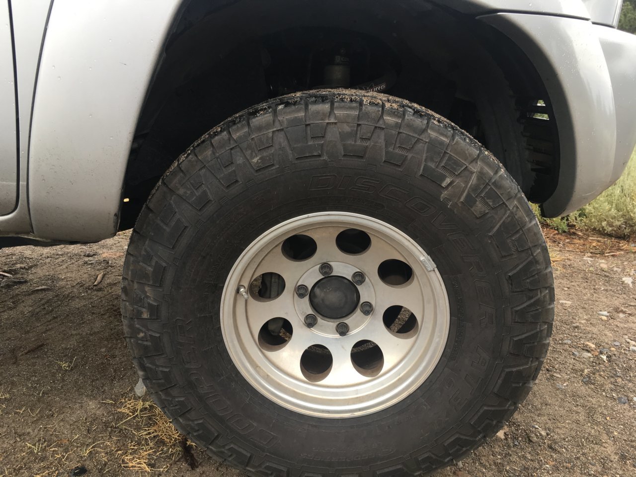

  3. Jun 29, 2021 at 2:41 PM
    #823
    replica9000
    replica9000 Das ist no bueno
    Apr 6, 2008
    #5782
    16,429
    Lake Chargoggagoggmanchauggagoggchaubunagungamaugg
    2019 T4R ORP
    295/70R17 Cooper Discoverer AT3 XLT
    4WDTrout likes this.

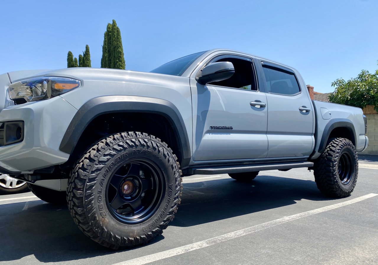

  4. Jul 7, 2021 at 10:14 PM
    #824
    arshwarrior
    arshwarrior New Member
    Jul 7, 2021
    #370701
    will the JBA offroad UCA's clear 295/70/17 Yokohama's M/T on 17x8.8 -12 offset 4.28" BS wheels?
  5. Jul 8, 2021 at 2:01 PM
    #825
    replica9000
    Apr 6, 2008
    #5782
    16,429
    2019 T4R ORP
    Yes. The setup on my 4Runner is nearly the same. I can fit my hand between the tire and UCA.

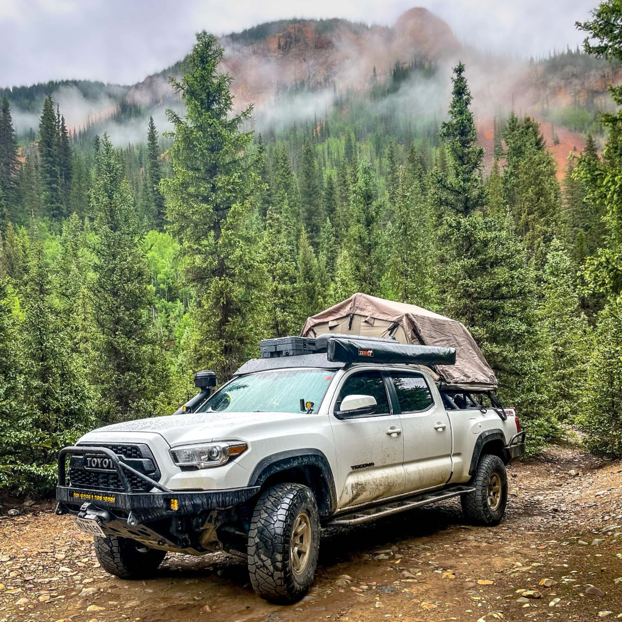

  6. Jul 19, 2021 at 8:01 PM
    #826
    4WDTrout
    4WDTrout Perpetually dreaming of tall trees & rivers
    Mar 19, 2013
    #100091
    4,117
    Theo
    08 4WD SR5 DCSB
    Total Tacoma nOOb.
    295/75/16
    banditcamp likes this.

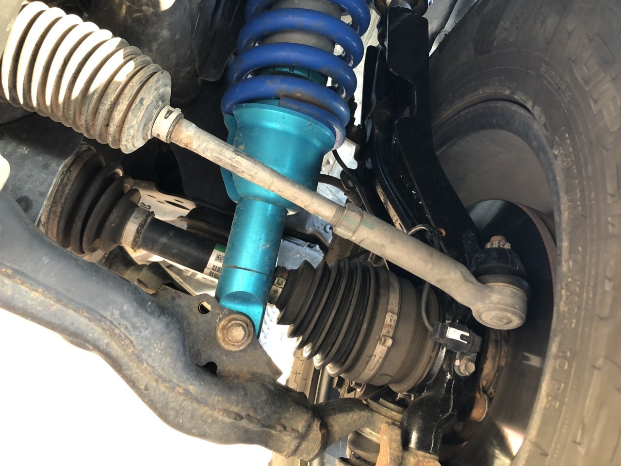

    Sorry for reviving an old post. I have 285/75/16s on a 3” lift (Fox 2.5 DSCs, 600lb coils, 16x8 wheels) and did not need a CMC with plenty of room to spare. The BF KM3s are a bit of an overkill, so I plan on swapping them with 295/75/16s. I’m ready to do a CMC if needed, but I ‘might’ get away without it.
