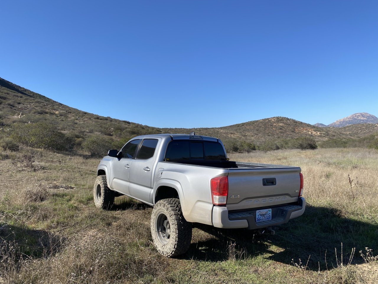

    3530ECDD-18AA-411A-A841-0B22F61C6638.jpg 212C43BD-81BC-4222-A9F4-CA6CDF64E0EC.jpg 9074A1C7-BF59-45F1-B351-2AC18D912A3B.jpg 05865D31-F67C-43A5-ABAE-68888A329C69.jpg FA277C51-8F7C-456B-AD1C-0C3B5C2A1825.jpg

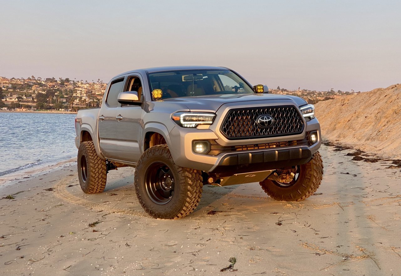

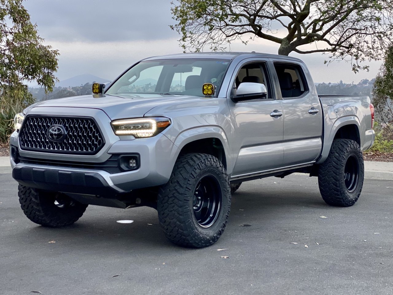

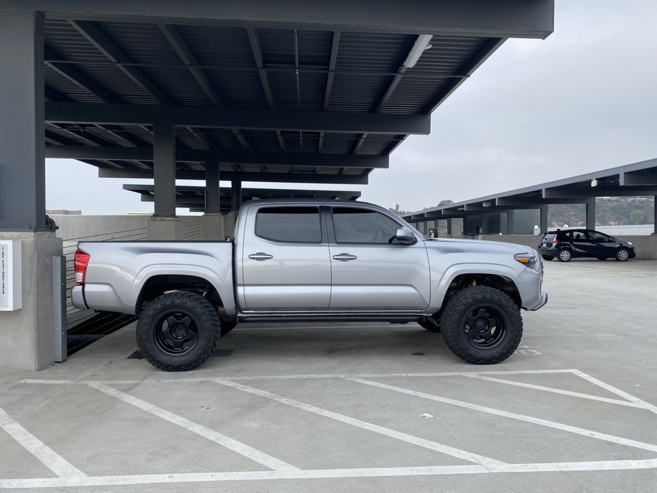

    295/70/17 Nitto Trail Grapplers on SCS F5 17x9 -38 offset

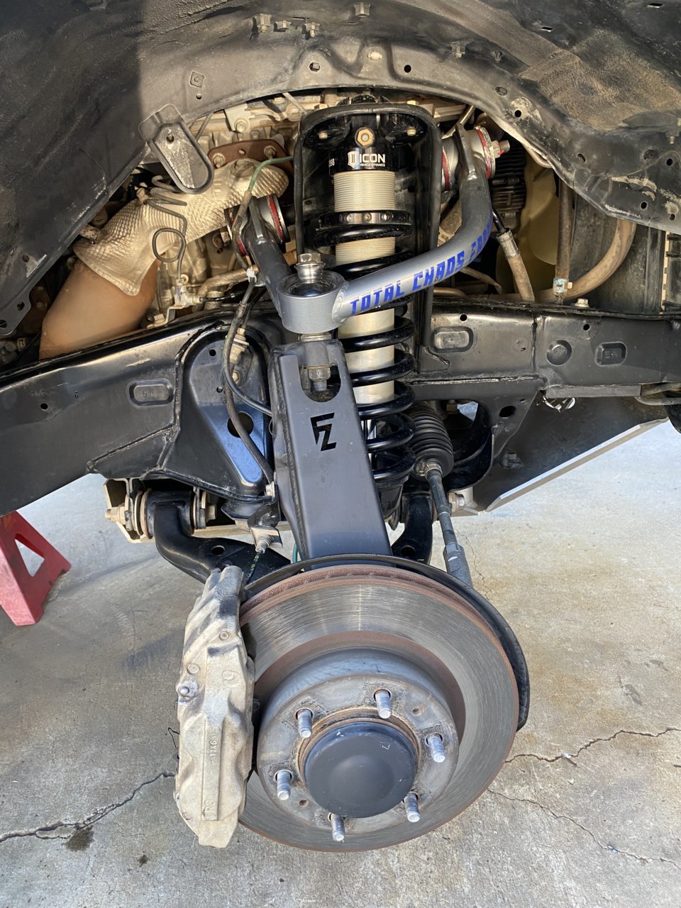

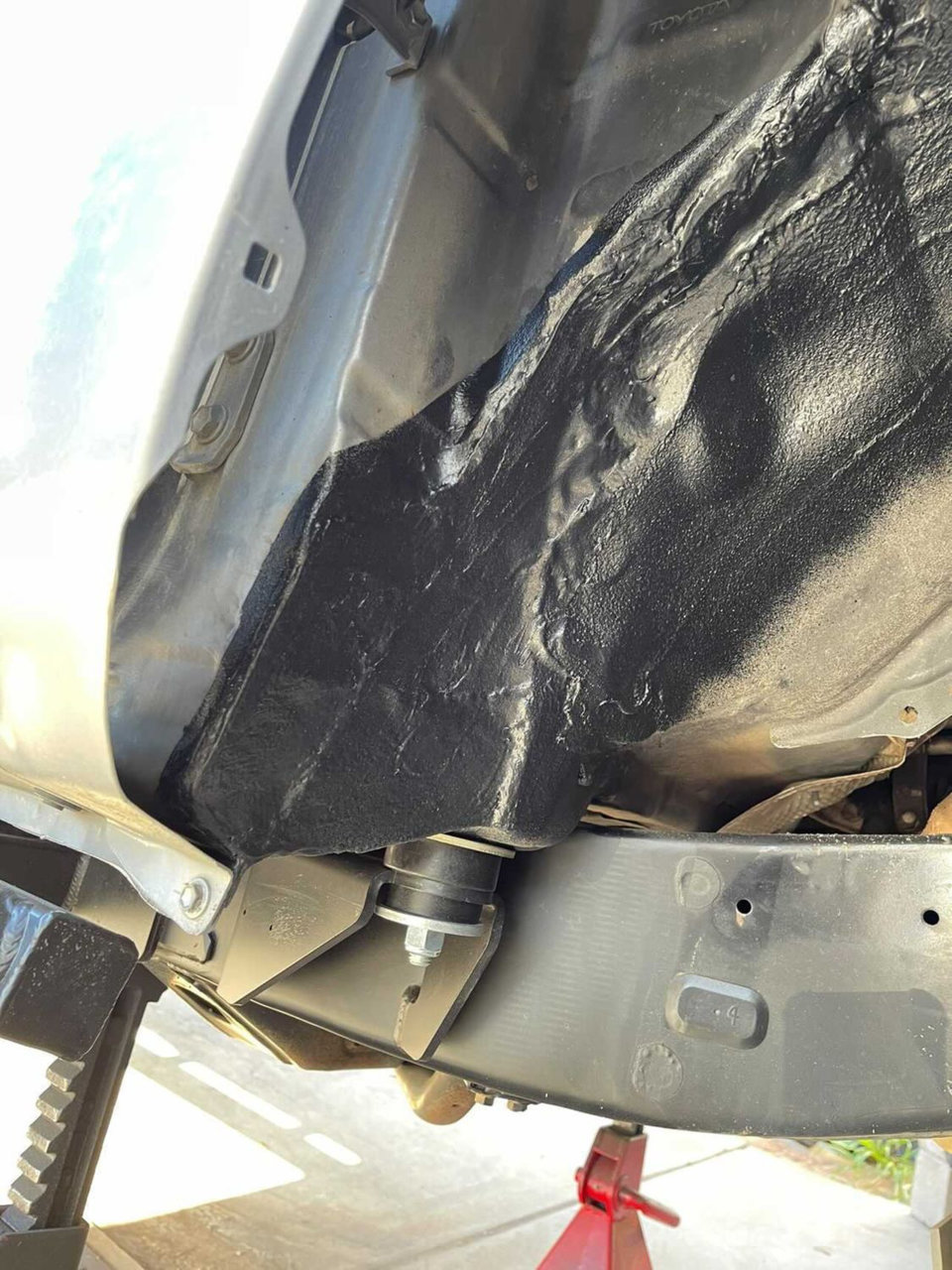

    What lift do you have? New UCA? CMC and pinch I’m sure. Trying to figure out what I’ll be looking to get done once I receive my wheels next week.

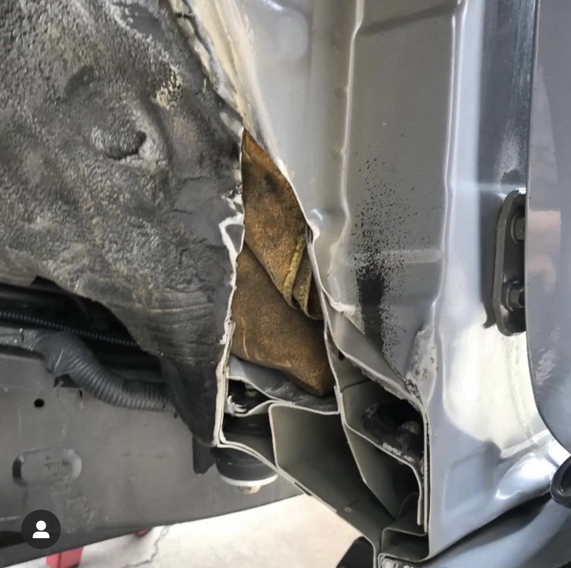

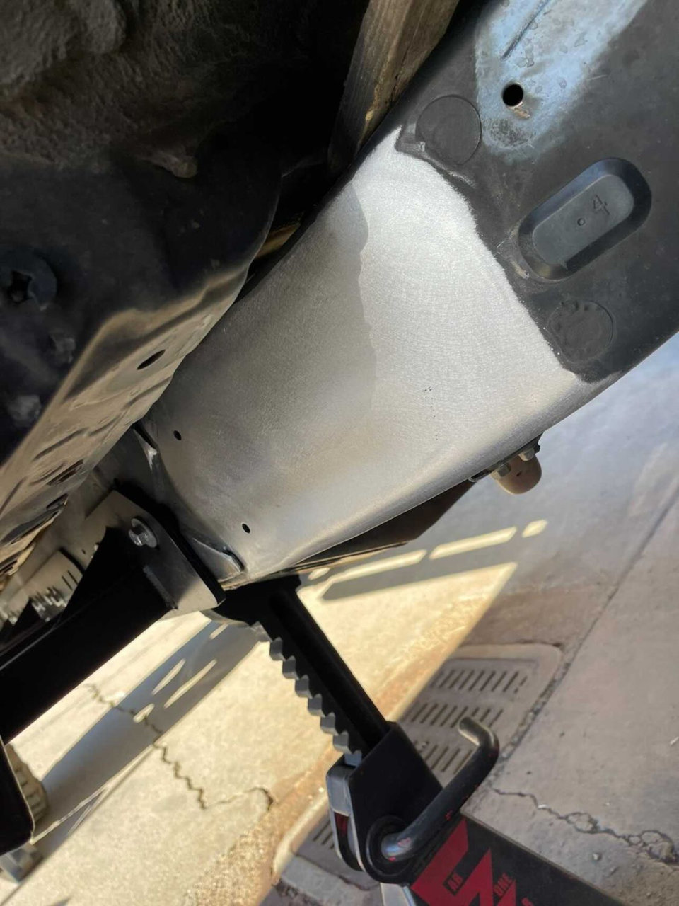

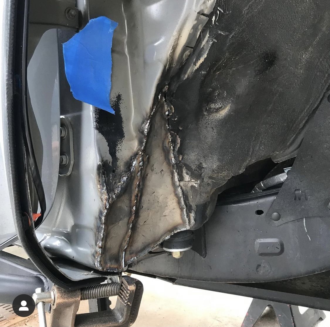

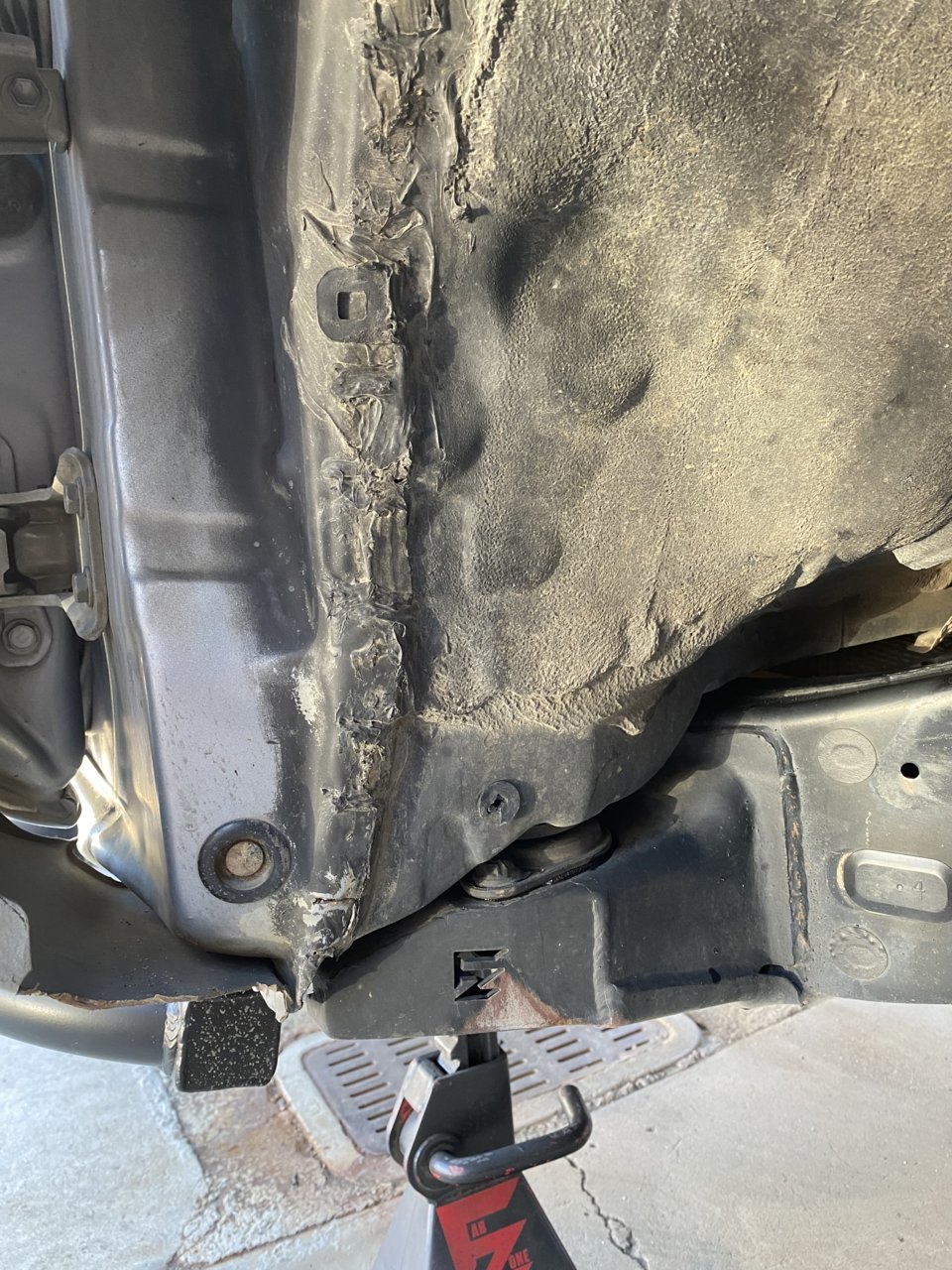

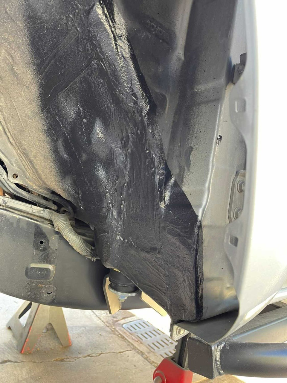

    so I had to do quite a bit to make the tires fit with ZERO rubbing even at full flex. I also removed my front sway bar so the wheels can move more freely and get better suspension performance. I did a full cab mount relocation which removes the factory mounting point completely instead of trimming part of it off. Because of the offset of the wheel we also had to tub the firewall for more clearance. I also have total chaos upper control arms. I got all my fabrication work done at a shop called Fabzone in San Diego.
    Here is the before picture. You can see that even with the pinch weld flattened, and the cab mount chop, it still rubbed.
    CF5EE72E-5685-449D-9D0F-CBB9C5E9B474.jpg 802D74AD-BDFC-4C47-8C2F-9C8076F24FD3.jpg D2EC9B39-7B67-4DF2-A677-3B8D79E77B0B.jpgDDF1C94F-A576-42D2-996C-E7C87C1362FE.jpgD115405F-EBB7-4689-BF75-EAB7906D6257.jpg
    A763E8F9-7E7E-4DA9-B97B-02E74CF60241.jpg F5CFDE2F-4C5C-446D-A974-1EAD1EECE548.jpg26FDBC00-5711-4B5A-BEB3-4C0BC1049E02.jpg

    If you kept the sway bar do you think tubing the firewall would still be needed?

    Im not sure because I took it off before getting these wheels and tires. I have a friend that needed to tub his firewall with the same size tire and wheel but he left his sway bar on. I guess it also has to do with how hard you flex out your suspension off-road.

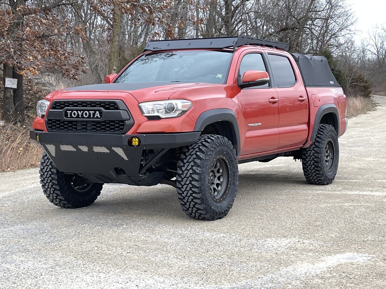

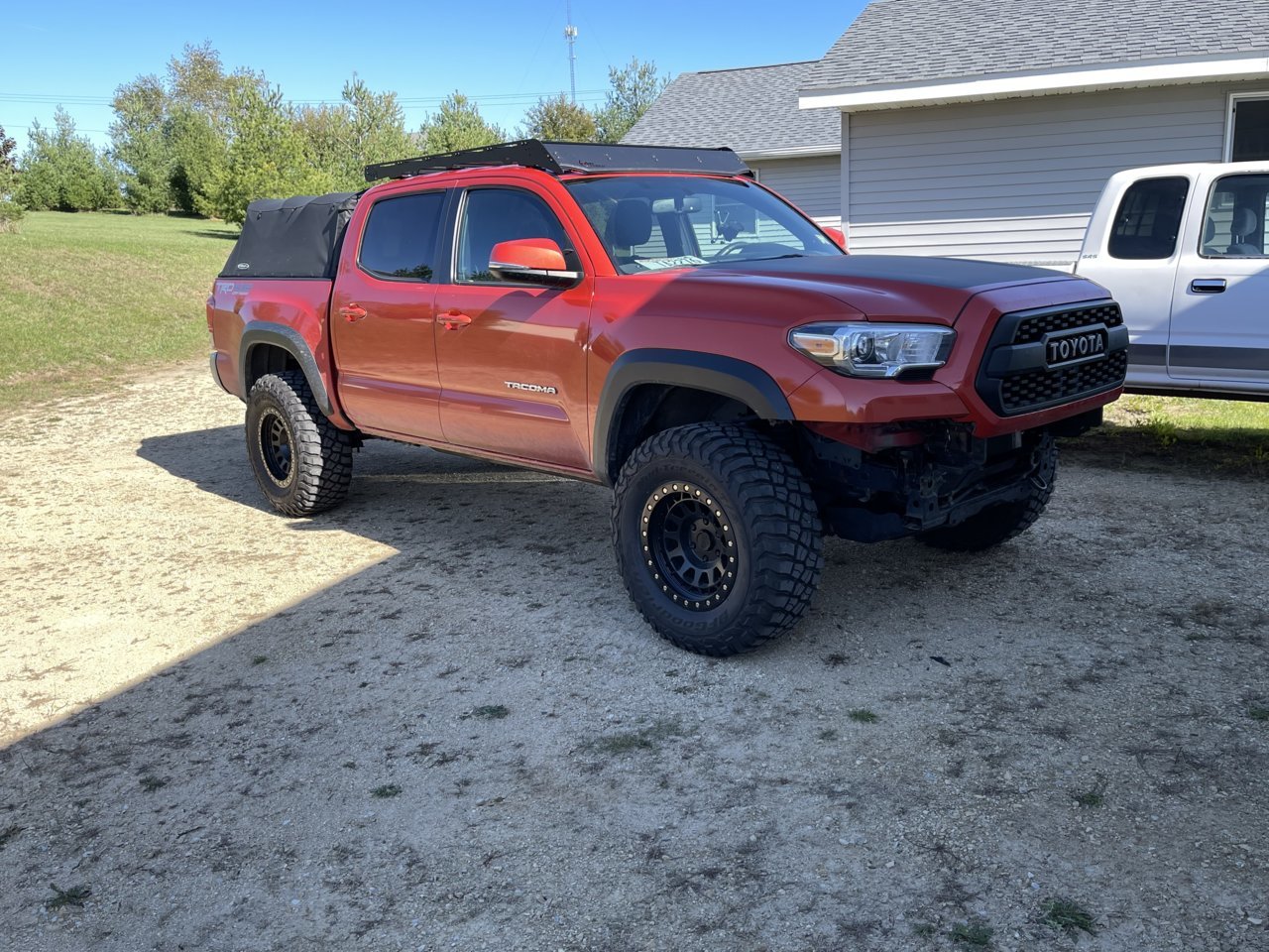

    10BA0FC9-70B3-4B5F-A1B9-33BAB4B2BDBC.jpg A lot of help from this thread pointed me to the 295/70r17s. Happy with how it turned out.

    @atk8787 first off bad ass truck but what did you have to do so the wheels to fit and what offset did you go with
