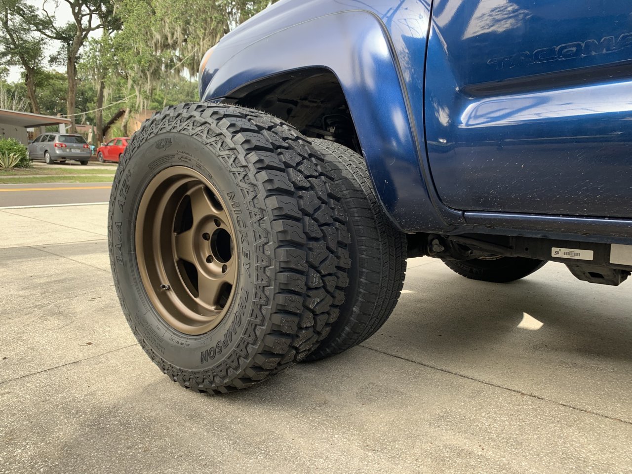

    or 2 years back their Baja ATZ. This is 305/65 R17 on some 17x9 -38 SCS F5s.....

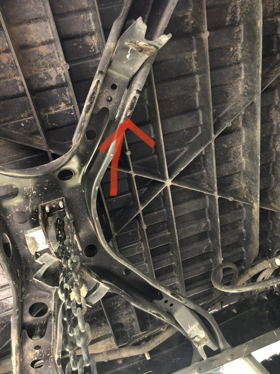

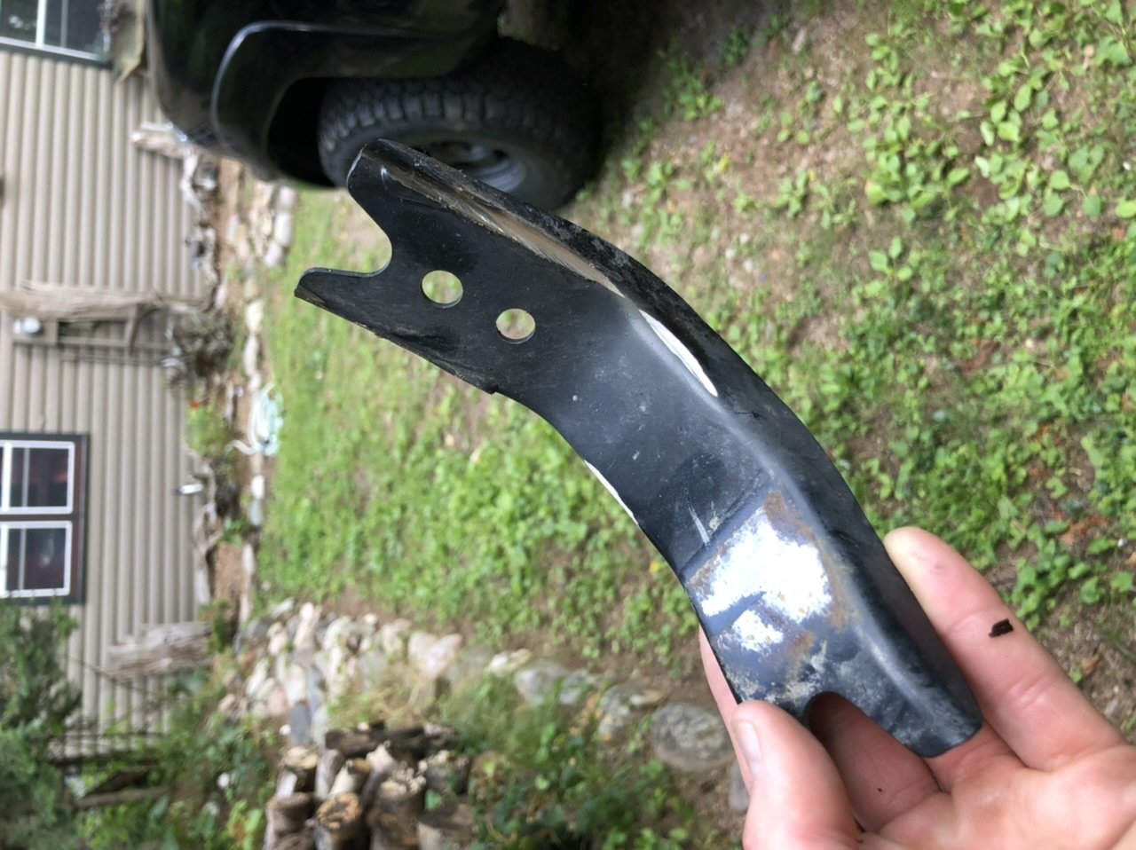

    Cut the ears of the spare tire carrier underneath. I ran a 295 in the stock location for a long time. Just need to use an angle grinder and cut the weld by the arrow
    9640BC3C-88E2-4318-A945-CE1C165F8715.jpg 86C9EE76-4824-472B-95B3-A6F8B0154A86.jpg
    i do have a chopped tail pipe, not sure if that is needed to fit the bigger tire or not
