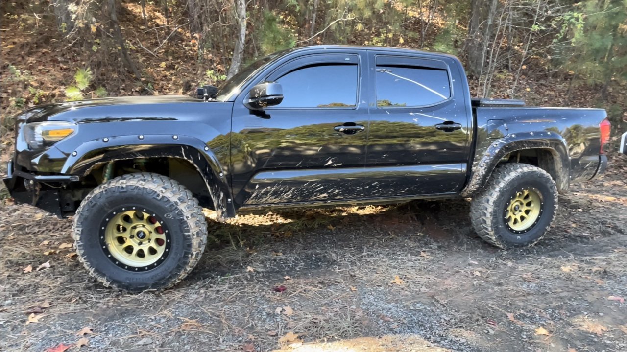

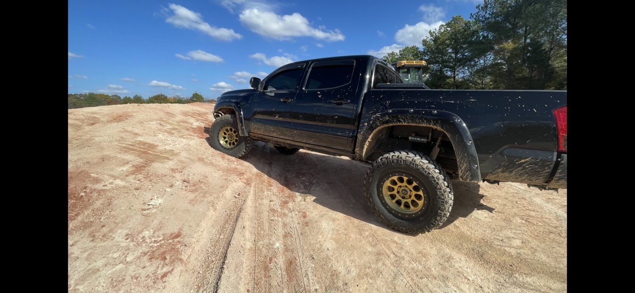

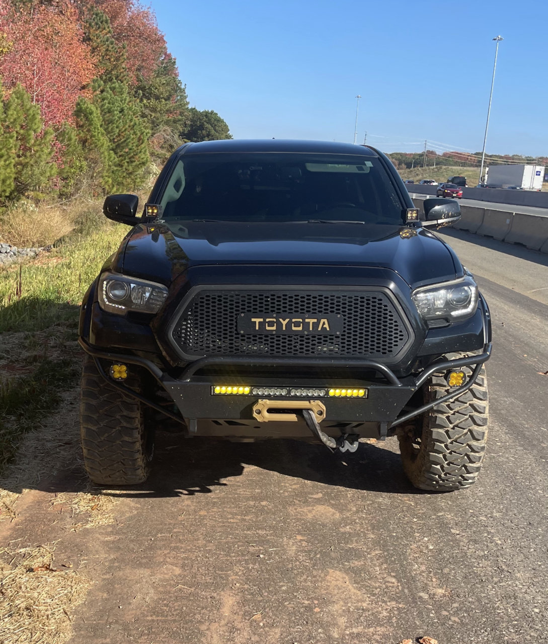

    Extended travel Kings, 650 coils Tundra Kings rear Icon AAL with 1/2” shim & Firestone airbags Total Chaos UCA’s ARB onboard air VTX Stinger 17x9 -25 offset Yokohama g003 MT 295/70/17’s RCI roof rack and bed rack TRD Pro skid TRD Pro tail lights R4T high clearance exhaust CBI Baja bumper Smittybilt xrc 9500 winch Dobinsons snorkel, Syklone precleaner Caliraised ditch lights, rigid covers 5.29 gears CVT Mt. Washington RTT Body Armor sliders ECGS bushing

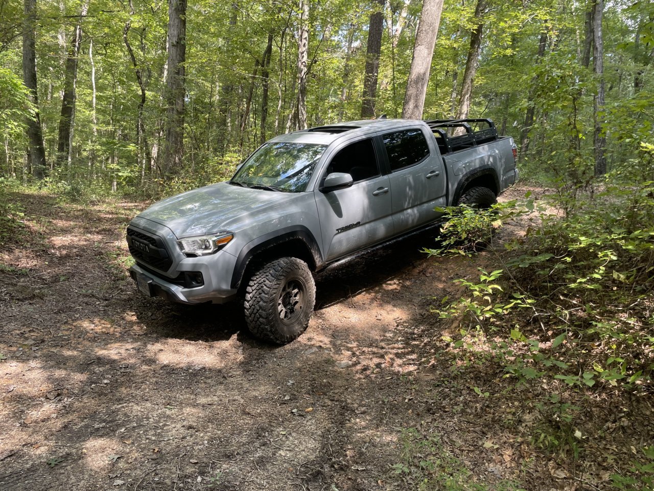

    295/70/17 Yokohama Geolander g003’s, 17x9 -25 offset wheels. Cab mount chop and lots of plastic trimming. Doesn’t rub offroad. Relocated spare hoist back 1” and exhaust dump before axle. Have a few inches clearance between spare and diff.

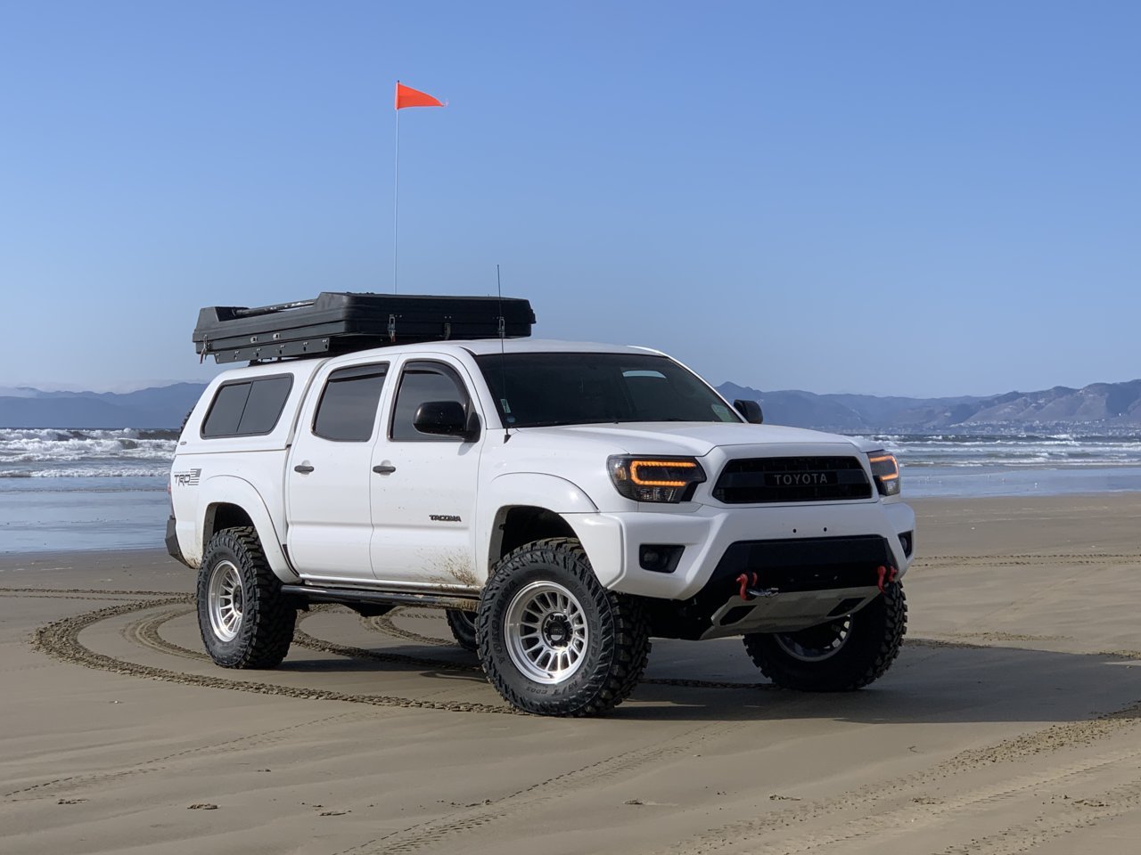

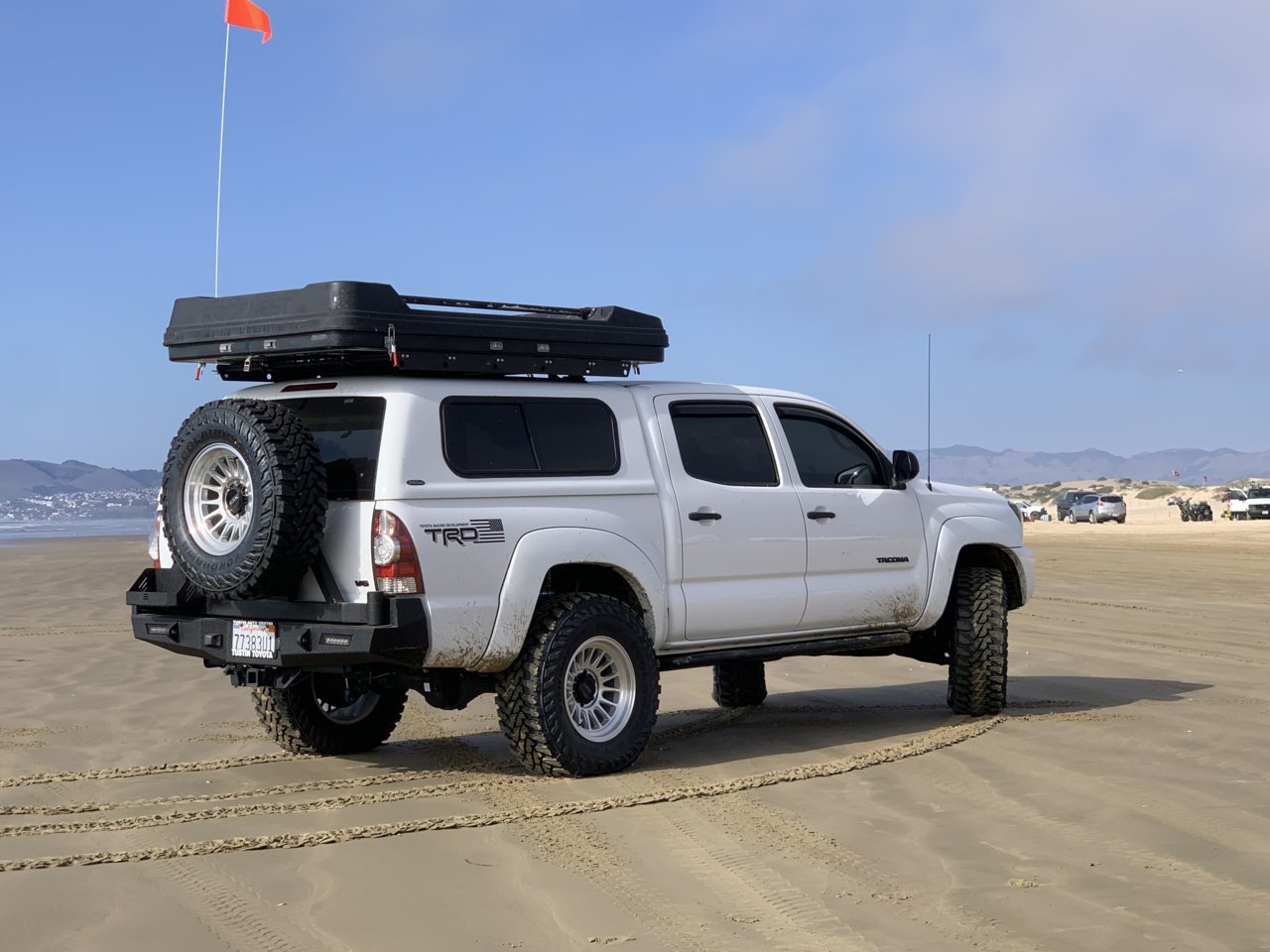

    Got me some 295r’s :turtleride:
    Wheels are kmc impact ol 17x9 -12 offset. Im on kings about 2.5” up.
    I did the cab mount chop and had to hammer back some more on the plate. Did a fair amount of fender flare trimming and beat the pinch welds flat. Finnaly got it now to where it does not rub. Rubbed only so far when i was in pismo beach. These are my first set of MT tires. Yes you can hear the tire noise in the road but it drowns out and you just drive ignore it. But they’re nice so far!

    what locking mechanism is that for your spare in the bed?

    www.wilcooffroad.com
    Top quality product.

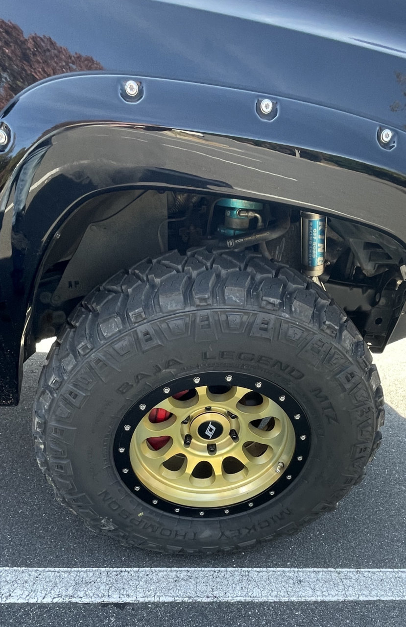

    I had to go back to the 295/70/17’s after running the Kenda Klever 33x10.5’s for awhile. I missed the stance and also got a banging deal on these Mickey Thompson Baja Legend Blim tires for $1040 mounted and balanced OTD. After 2 weeks I’m impressed them on/off and the noise is ridiculously quiet.

    I had to trim a little more plastic with these vs my old Ridge Grappler 295’s
