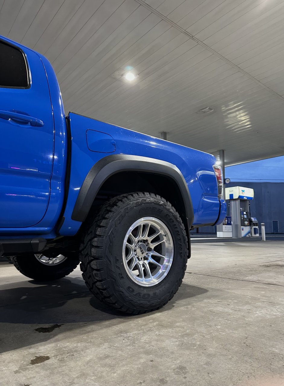

    #347972
    69
    2019 Voodoo Blue Tacoma TRD Pro
    A71D6D37-CAEE-4217-B7D3-ABBBE2F5BBDB.jpg CE5928DA-7D83-4E27-9F1E-317D4B9D61F2.jpg
    295/70r17 Toyo R/T’s

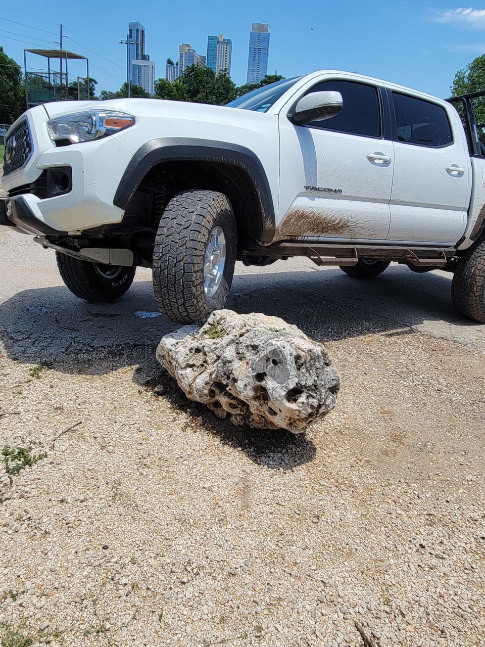

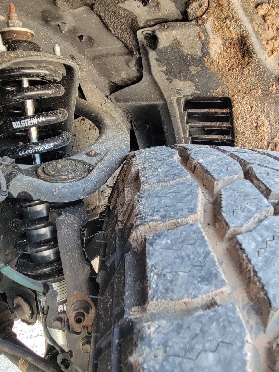

    43
    Austin
    18 DCSB OR
    Quick report is very slight contact to uca at full lock. I mean barely. I will post pics by this weekend and flex it all some more. Based on my math your center moves out .6" with 0 offset, but you loose .25 going from 7.5 to 8" width, thus net .35" further out then me. That should be plenty.

    43
    Austin
    18 DCSB OR
  14. Jun 13, 2023 at 7:54 AM
    #1054
    Zula
    Zula Active Member
    Mar 13, 2022
    #392514
    38
    Lance
    2019 TRD OR LB
    2" Eibach lift ,285's
    Looks like you're barely kissing the UCA in those pics; how will you address it?

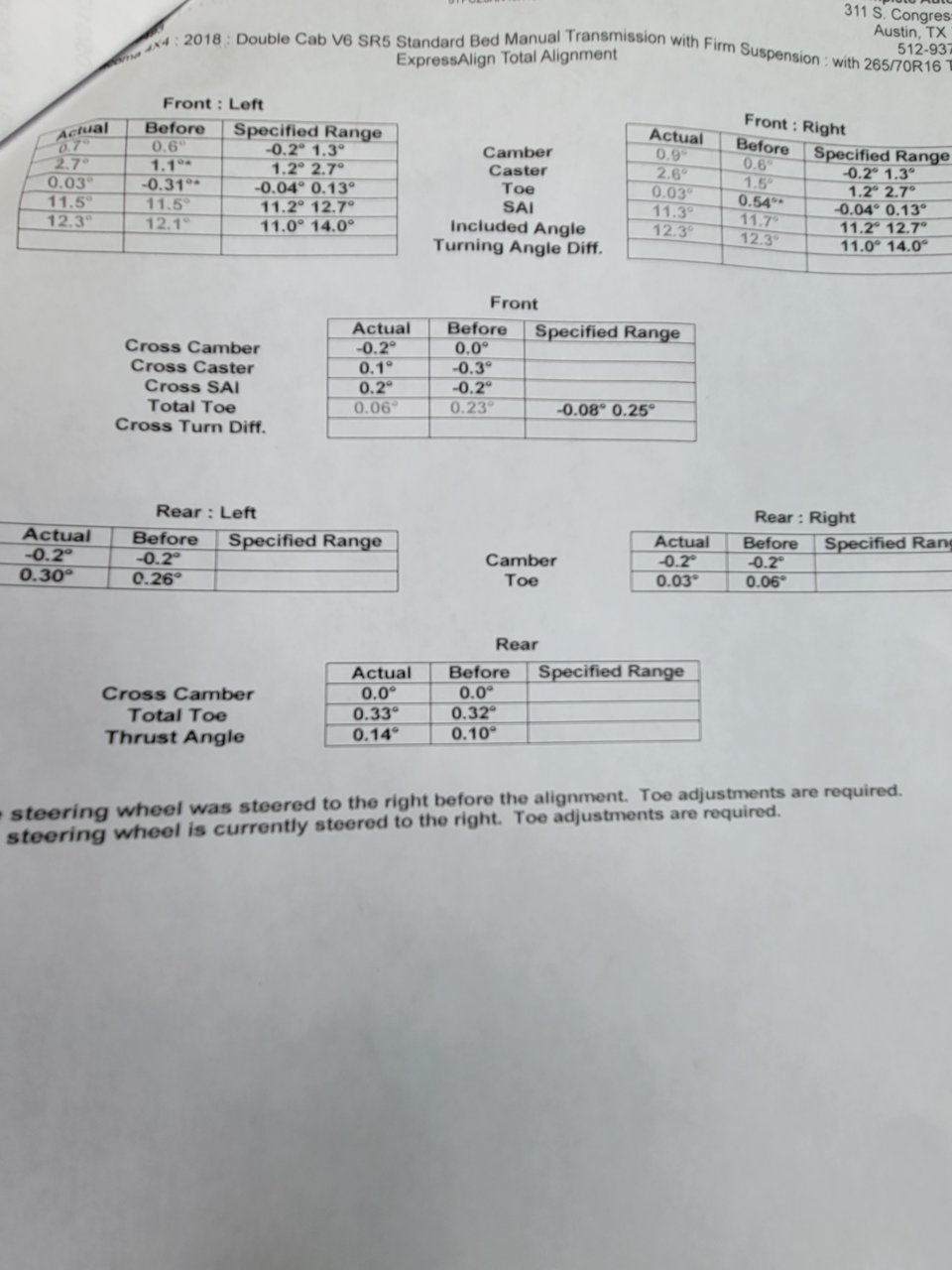

    #357309
    43
    Austin
    18 DCSB OR
    Pushed caster hard on allighnment to make room, will see if dialing it back might help or if i can live with it. Have to be at full lock for it to touch and even then its intermittent and very minor. I was suprised as i have seen other reports of this wheel and tire combo with no rub. If i have to do spacers i might just go back to stock wheels, love the stock+ look
    Anyone who knows alighnments have thoughts on those numbers? 2.7 caster on stock UCAs is unheard of, not sure how they did it
