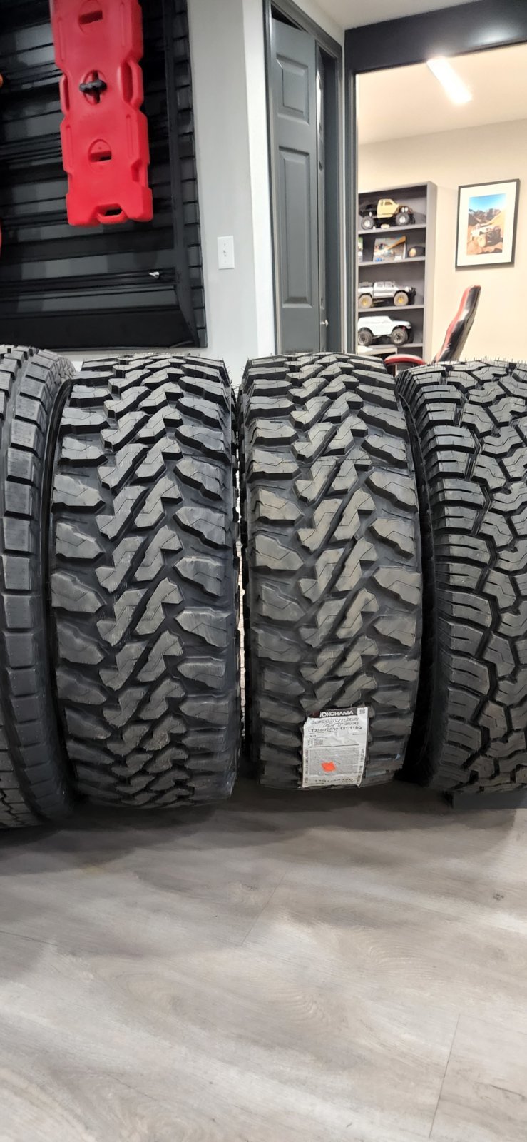

    Honestly 285/75 will be the next move rather than 295/70 the difference between the 2 is hardly noticeable

    285/70 on right, 295 middle, and 285/75 left?

    Only looking at the 2 mt's 285 right 295 left
    To comment further about fitment, as far as I know these will not fit without a chop or an insanely agressive alignment and not much offset

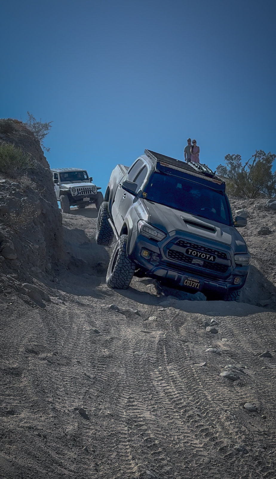

    Alittle pic of the 295s in action this past weekend at Anza.

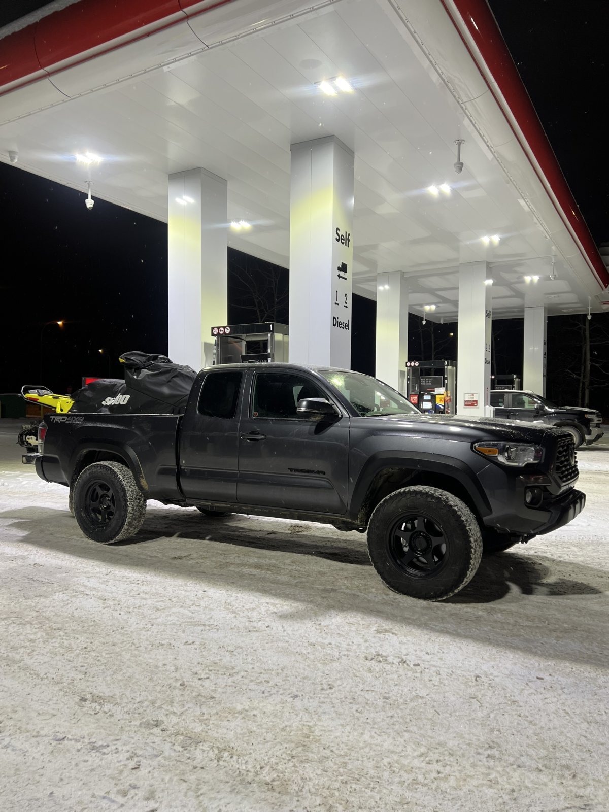

    Hey everyone!
    Is anyone running these tires with Ironman UCA’s?
    The parts I have so far are:
    6112 / 5160 Combo
    OME Rear Leaf Pack
    Cab mount chop, pinch weld folded, and some minor trimming to the fender and custom wheel liners (Had a Toyota 4X4 shop do this for me)
    295/70/17 Mickey Thompson Baja Boss Tires
    17X8.5 -10 Falcon T2 Wheels
    here’s a photo with the 265/70’s on the stock suspension!

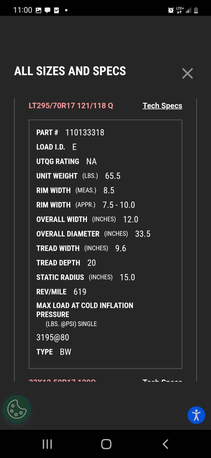

    Out of curiosity have you checked the weight on thst tire? Unless it's a typo it's 7lbs heavier than my G003's.

    I have not, but as they're not mounted I'll weigh one!

    Omg those are so heavy! They got 15lbs on a duratrac of the same size

    I'm curious if they just overstate everything as a 295 true to size is 33.3 which is a long wsy from a 34
