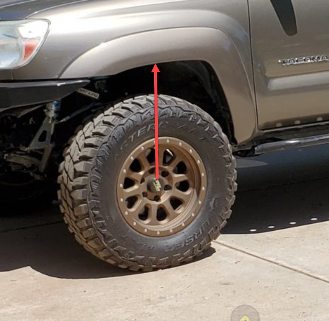

    12 DC 4x4 Lifted Sport
    Lifted, Kings, Locked, 295s and more.
    About 22".

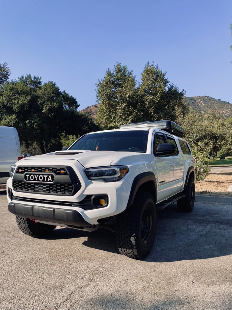

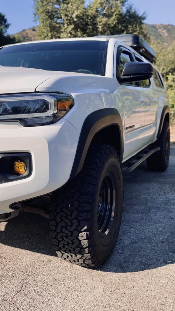

    295/75r16 BF K02s
    2” lift (bilstein 5100/JRA UCAs/Armstrong AAL)
    -10 offset

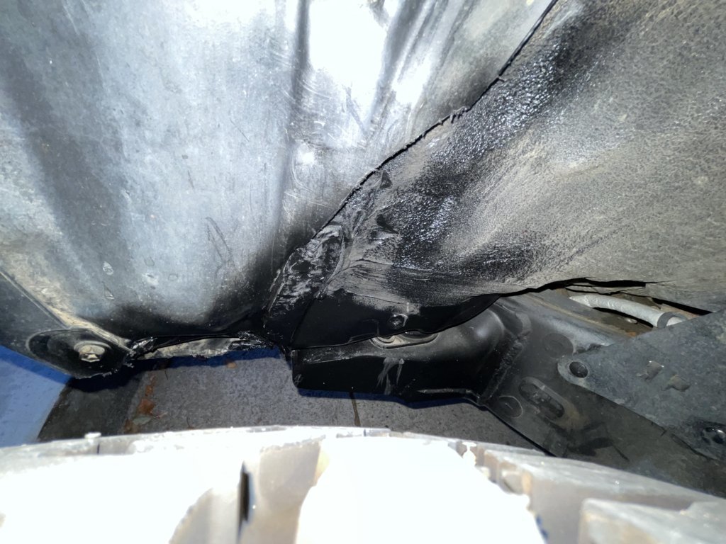

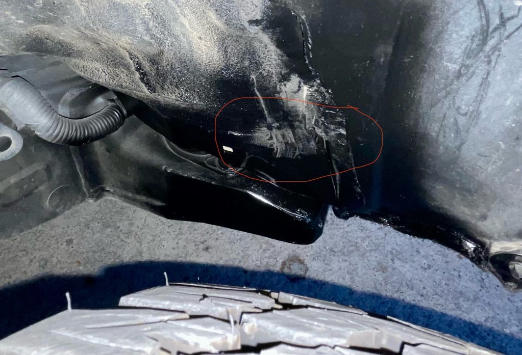

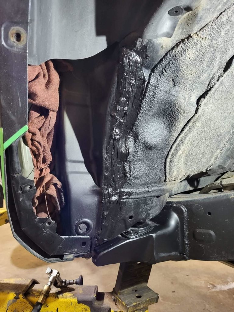

    Got a viper cut, cmc and trimmed the holy hell outa the fender liners. Still rubbing above the cab mount under compression. (See photos. Spray paint has been scrubbed off)
    Anyone here know if I can simply ball peen hammer this back?

    There's a whole pinchweld there. The general fix is to flatten the whole thing. The method I see most often is to notch it hammer it over then flex seal over it. I'll see if I have any pictures of how the shop did mine.
    Side note did you get an alignment to add some caster?

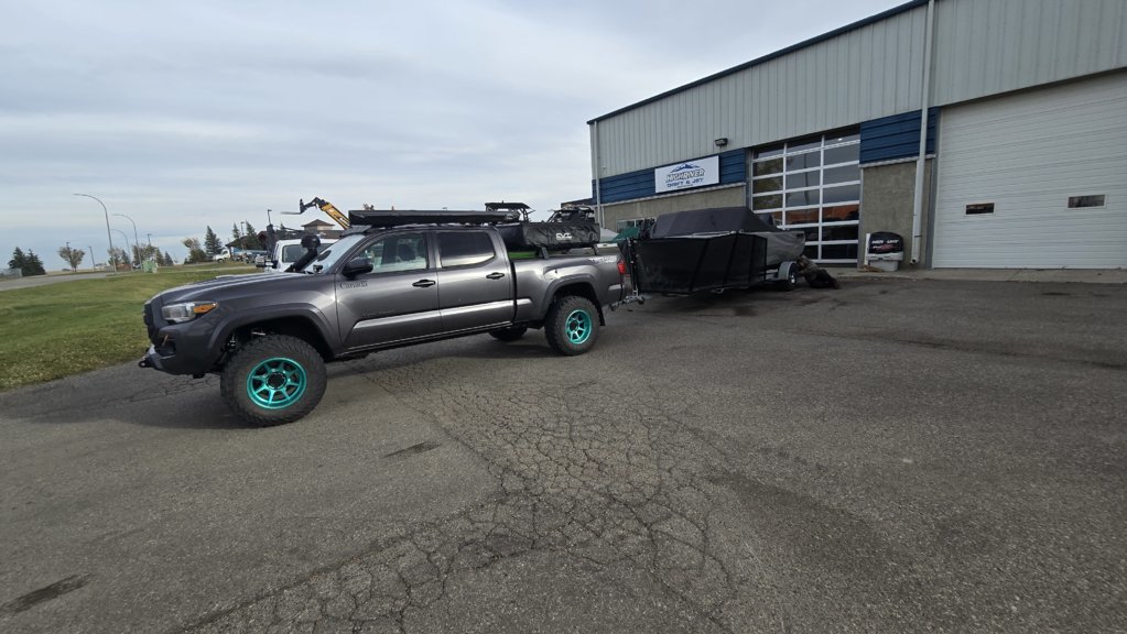

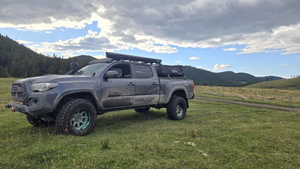

    On another did a long trail day with it yesterday

    Already hammered the pinch weld. It’s inbound of the pinch weld. Directly above the cab mount. Check the red circled area

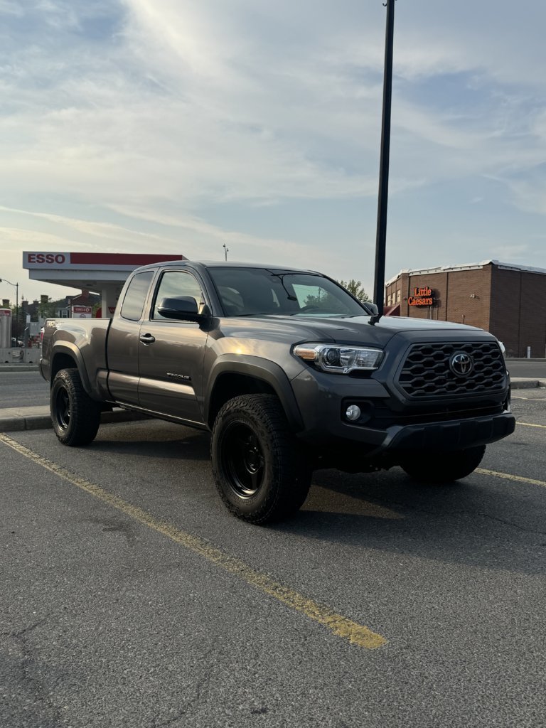

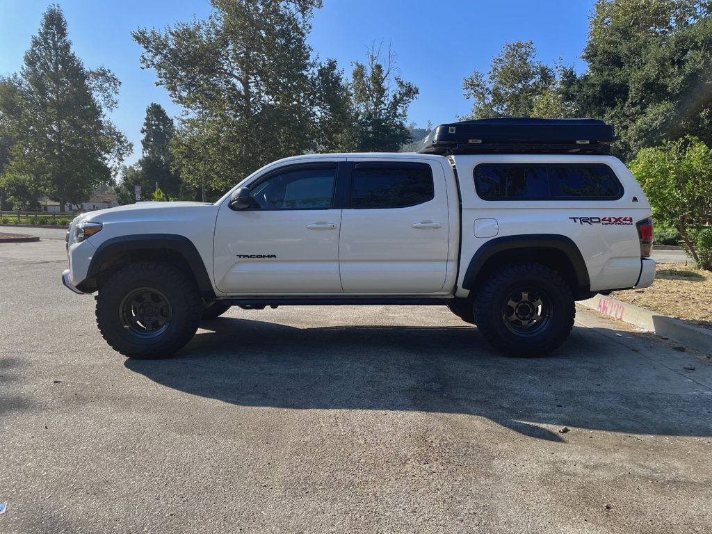

    295/75r16 K03 -12 BR6 16x8 (87lbs)
    Krave Auto Stage 3 CMC
    3" Elka
    TACO1.jpg TACO2.jpg lift

    295/75r16 ...... For now :transformer: the Stage3 chop should clear 315/75r16 -25. I would just need to do the C4 High clearance fender liner kit I think......
    Loving the K03 so far
