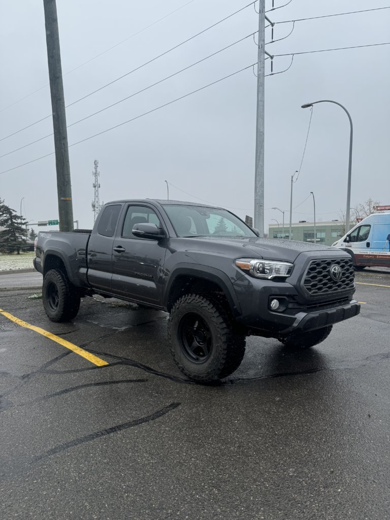

    ACTaco23
    ACTaco23 Active Member
    Jun 3, 2023
    #425999
    27
    2023 Tacoma AC TRD OR
    6112/5160, JBA UCA, 295/70/17s, couldn’t be happier!

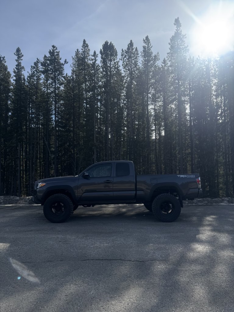

    27
    10,000KM on these tires now! Got to say I like the truck a whole lot more now. I can’t say I notice a huge difference in power even on mountain passes with my sled in the back. I can’t say I feel the need to re gear. Now that the weather it turning I’ll be throwing some rock sliders and armour on and getting to wheeling the truck!
