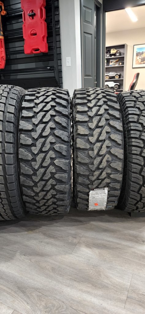

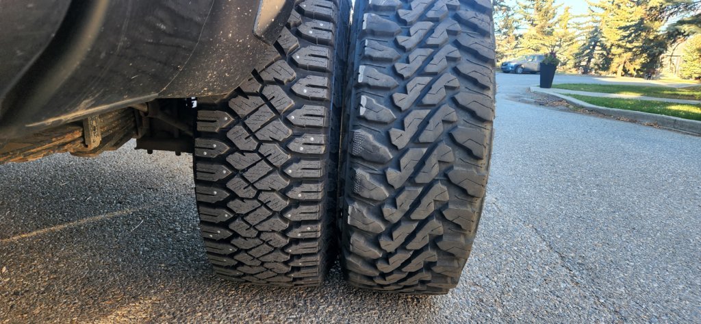

    That's just good ol bfg. When I first bought my truck i almost did 265/70r17's k02's but next to a 265/70r17 duratrac they looked stock. So that was the first nail in the coffin for bfg's for me.
    The 2 in the center are 285/70 and 295/70
    Obviously not the best side by side but unmount 295 next to a loaded 285

    Interesting. So you really only a get width difference between the 285/70 and 295/70

    It's hardly noticeable. It's .5" at most

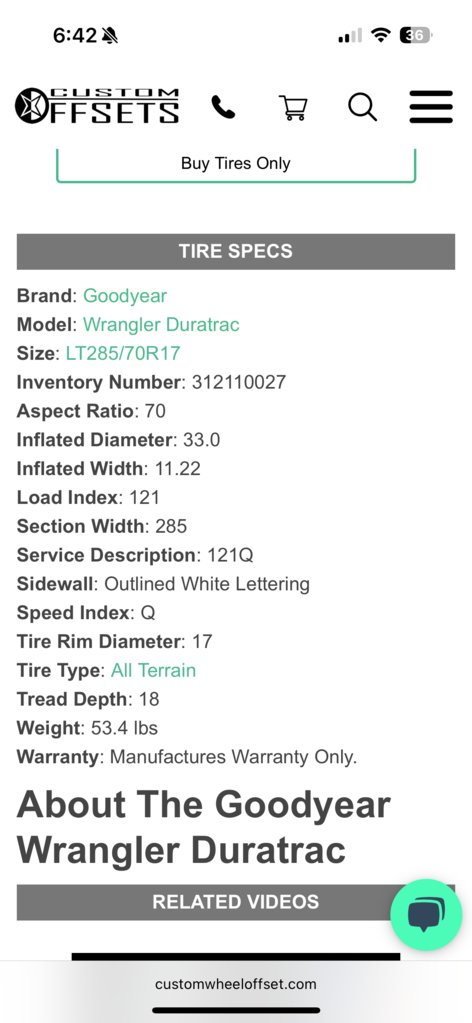

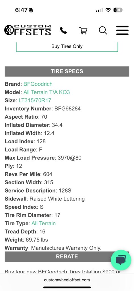

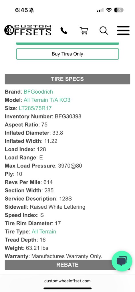

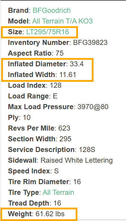

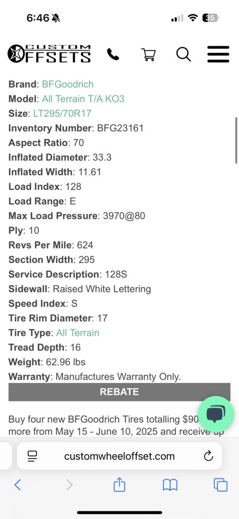

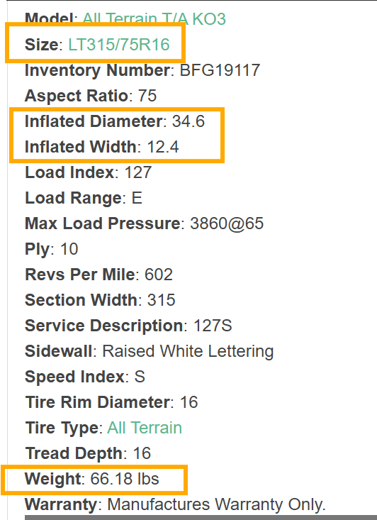

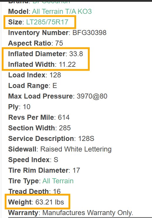

    Sticking with a 17” wheel, but yeah, I think I’m leaning that way. The 315 probably requires gears and more trimming than just my aggressive CMC/pinch weld. I did notice that the 17” does change some things in terms of overall height vs the 16” wheel which I found interesting. Looks like with the 17” wheel you lose 1/8”-1/4” of tire height depending on the size. Wonder why that is? Current tire and 17” KO3 Specs below:

    All of the manufacturers listed sizes are nice and all but really world side by side is the only way to see what it actually is. As I doubt the 295 k03 next to a G003 would be the same overall size

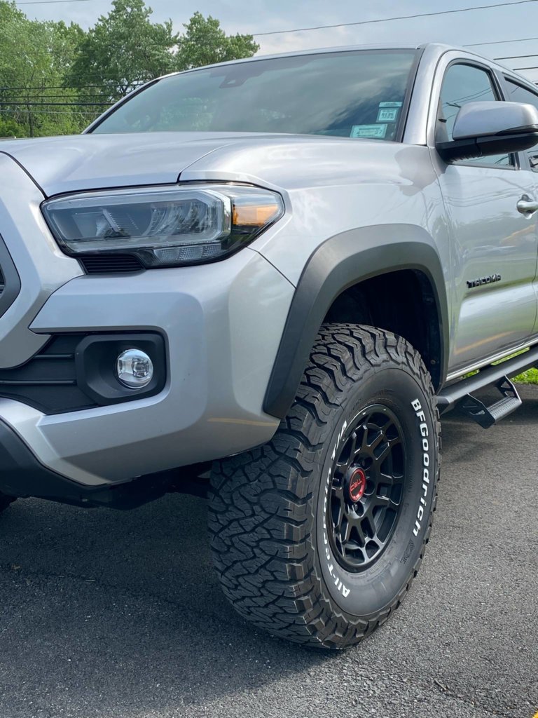

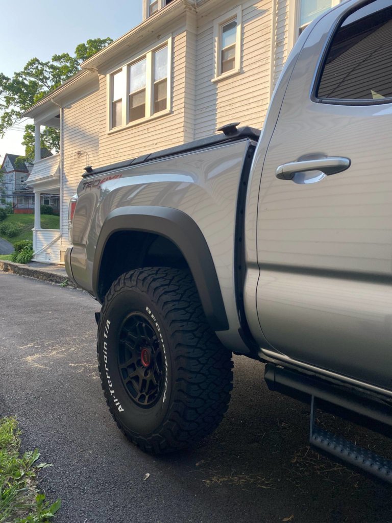

    And that’s a 295/75/16?
    looks good!!

    yes they are

    Looks good. These are the new KO2's right? How much of a BMC you had to do to get these to fit?

    That width looks much more appropriate than the 285. Looks good! Still on the fence of a 295 or a 315 though

    Yes, these are the replacements to the KO2s. I didn't have to trim any plastic, cab mount, or pinch weld for street driving.
    If you aren't going to regear, I would get the 295s.
