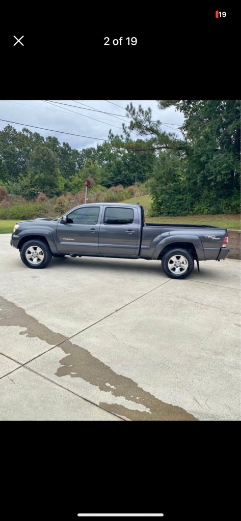

    Quinton
    2012 dclb tacoma
    6112/5160 Deaver stage 1 Are topper Steelies,255/80/17
    Just picked up a cherry 2012 dclb with 55000 miles.
    Everything is in great condition.
    Plan to put a leer topper on,no bumpers or extra stuff other than recovery gear and maybe some sliders.
    255/80/17 on fj steelies
    2-3 inches.
    I dont like to cram a tire in fender well.I like some space.
    Budget 2000.00(may source used)
    My use is daily driver,haul kids to soccer,use to hunt and camp.Camp loads will be full.
    Back roads,ditches and minor off-road but it’s a cherry long bed with a topper,old man truck!
    Daily driving I want the bed 90% empty.I have been driving a 2000 4runner for a decade and want the bed space for stuff.

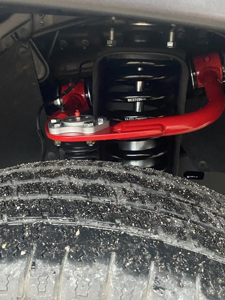

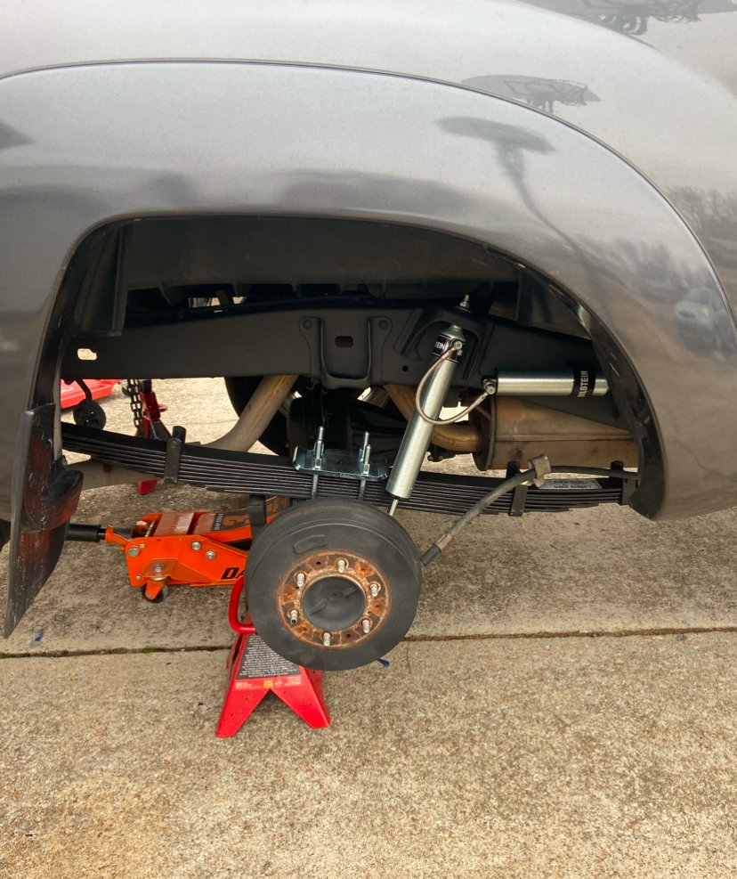

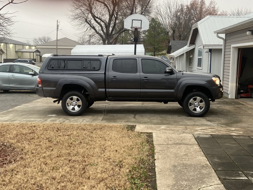

  14. Dec 24, 2024 at 4:48 PM
    Coopsdaddy
    Coopsdaddy [OP] Well-Known Member
    Jul 7, 2017
    #223417
    471
    Quinton
    2012 dclb tacoma
    Lift on,wheels getting powder coated matte black and tire should be in Friday.
    I have a Trd pro 1/2 block I may add after a few weeks.Will see how it levels out.
    Definitely want the rear to sit alittle higher.
