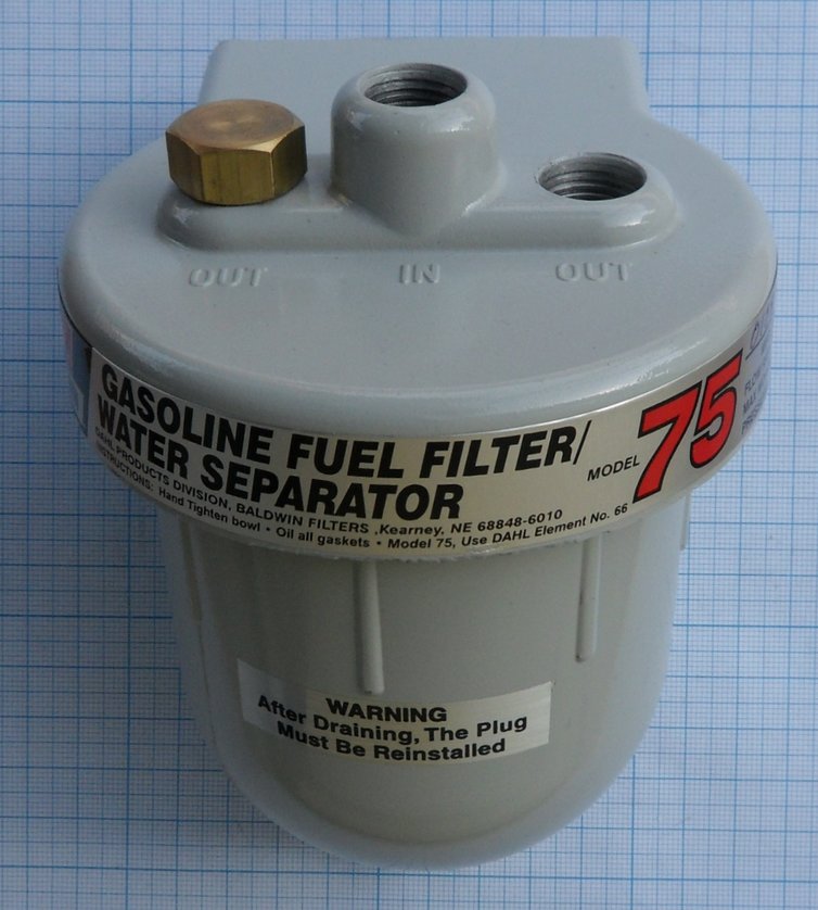

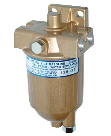

    Has anyone attempted to install a fuel water filter separator with success.
    Keynotes:
    1) The fuel pump is inside the tank. Fuel pressure is about 20-22PSI
    2) I am not planning to change fuel pump example: URD Walbro 255LPH external pump.
    3) I was thinking something about DAHL 75 at 40 GPHmax at 25 PSI or Racor 110A 35GPH up to 100PSI.
    4) The Idea is to separate 99% of the water that comes into the gas tank. I live is Dallas Texas and when we are in rainy season I get water into my fuel tank
    Has anyone installed one of these before with success since I don't see any post any where?
    With success I mean not the how to do it but for did it worked or not?

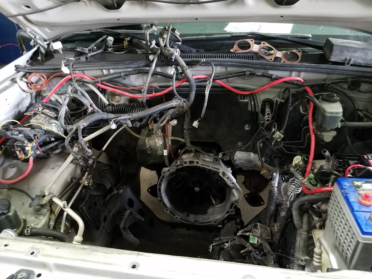

    Couple of years ago back in 2015 Dallas received 22" of rain and we had major flooding around the city. After that the truck started to show typical engine OBDII misfire error. Took the gas tank down and indeed had about of a cup of water in the tank. After taking the water out no more misfire error. The truck ran ok again. Taking the gas tank down is kinda tedious compared to a water separator filter.
    I would like to make this work. I have owned Land Cruisers before and had this type of filter but LCs fuel pumps were located outside the gas tank like not like the Tacoma's.
    I never had this issue before probably like you, and never had it again after the weather event. I am 100% sure that it was more than one gas station that had water and probably more than twice the time I pumped gas/water mixture. Fuel Cap other connections are all fine. I have not crossed any river...neither. It was unfortunate in the sense that I had to service the engine at 180,000 miles.

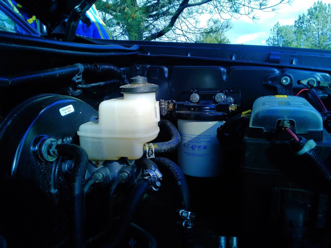

    The whole marine point to a racor is water coming in from the body water the boat is floating on. For automotive point the ethanol in gas separates the water from the gas causing corrosion inside the engine. I installed one two months back and drain it every two hundred gallons and i was surprised by actually how much was in after only 200 miles. Maybe it's just crappy CA gas:notsure:.IMG_20170218_151656.jpg
    jmra1000[OP] and MrCrowntown like this.
